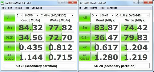

Going by these benchmarks 4K random read and write performance has gone 50% up!
