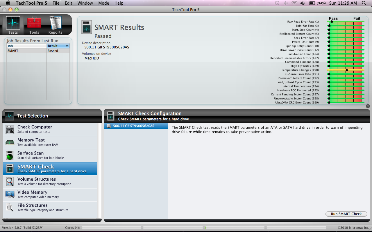

I recently upgraded to a Seagate Momentus XT (SD26 firmware). I have been having an issue where I boot the macbook and it loads to the login screen but then automatically goes into sleep mode or hybernation mode. The light on the front of the macbook fades in and out. When I press the power button it does the same thing over and over again.... I have reinstalled Mac OS X 10.6.8 and reset the PRAM and still have the same issue.
Anyway I have TechTool Pro installed and have run some tests on both HDD's installed internally. I run the "suite of computer tests" and everything comes up fine with both HDD's EXCEPT the SMART check. Everthing with the HITACHI HDD seems to pass but with the MOMENTUS XT the "RAW READ ERROR RATE" and "TEMERATURE CHANGES" seems to have a lolw score. I've attached the screen shots of the results...
HITACHI
MOMENTUS XT
My question is, should this be of concern? or is this related to the 4GB SSD hybrid installed in the Momentus XT? I was hoping someone might have a technical answer. And thought it might help out other people with a Macbook looking to upgrade to the Momentus XT. Also should I post this over at the Seagate forums???
If you have issues with SD26 you can downgrade to SD25. Someone posted success with it earlier on the forums.
I'm running SD25 myself. Runs flawless, excellent drive.
SD25 here as well...upgraded from SD23. No real problems as of yet except I do seem to still have some sleep/deep sleep related issues if I choose to put the MBP to sleep overnight (which I don't anymore because of the wake issues). I tried SmartSleep but it did the same thing (won't wake if left to sleep overnight)...weird...😕
