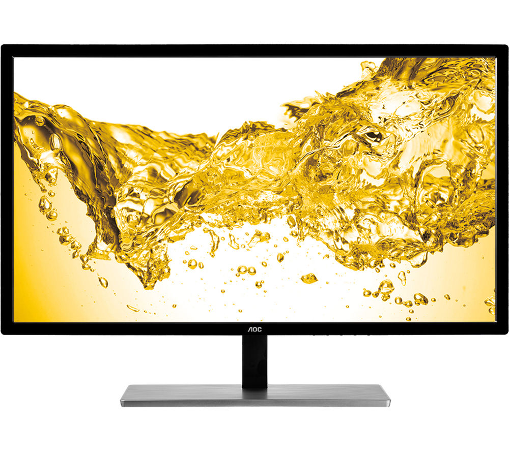

Hey guys.. thanks so much for your replies. I've found this within my budget. What do you think? worth the buy?
http://www.currys.co.uk/gbuk/computing/pc-monitors/pc-monitors/aoc-u2879vf-4k-ultra-hd-28-led-monitor-with-mhl-10146005-pdt.html?istCompanyId=bec25c7e-cbcd-460d-81d5-a25372d2e3d7&istItemId=xtaxlaxiat&istBid=tztx&srcid=198&cmpid=ppc~gg~1007+(PLA)+MONITORS+-+Adaptive~1007+(PLA)+MONITORS+-+Adaptive+ad+group~Exact&mctag=gg_goog_7904&kwid=GOOGLE&device=c&ds_kids=92700023411521199&PLA=1&tgtid=1007+(PLA)+MONITORS+-+Adaptive&gclid=EAIaIQobChMIqdbyp4Tf1QIVTJPtCh3DvQkvEAYYASABEgK91fD_BwE&gclsrc=aw.ds&dclid=CMOu6qqE39UCFaWGUQodf4YHLA

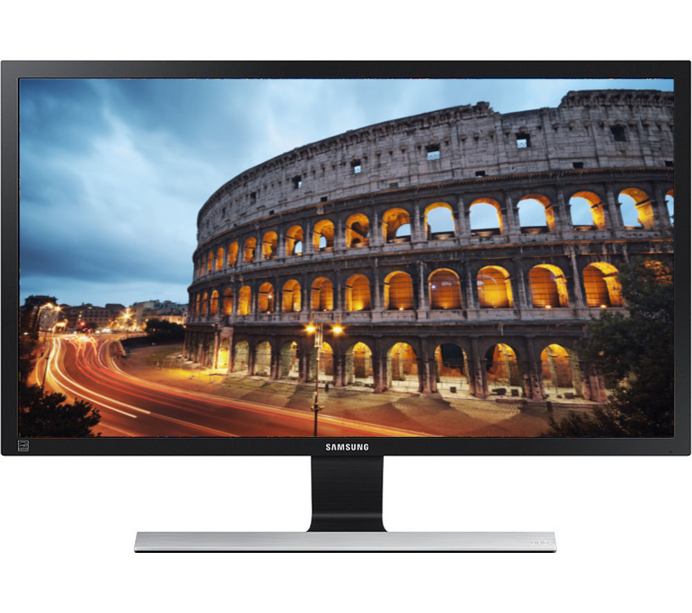

[doublepost=1502999377][/doublepost]Or this one.. from a well named brand
http://www.currys.co.uk/gbuk/comput...monitor-10132570-pdt.html?intcmpid=display~RR
Either of those should be a fine monitor. As long as you get a monitor with display port you should have a good experience.
Just remember that if you get a monitor that only has HDMI, you will not be able to get 4K @ 60Hz, only 30Hz.
