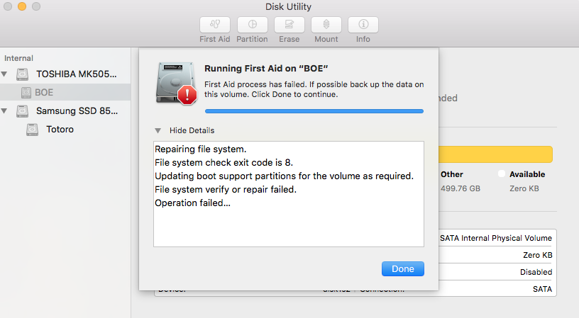

I installed a secondary HDD on my mid-2009 MBP optibay several months ago and everything was working fine and dandy so far, until an hour ago when I restarted my MBP and it didn't show me this disk anymore.
I have yet to open the computer (working atm) to try and check stuff, but I wanted to ask if you guys might have any ideas ad to what it causing it/things to try to fix it?
Disk Utility "sees" it and shows it as unmounted, and Finder doesn't even know it's there :/
Have you tried to mount it in Disk Utility? Does the mount point - the name it should have in Finder - appear below the disk name in Disk Utility? Can you and have you run First Aid on the disk in Disk Utility? You can also take a look at /var/log.system.log and see if there's any clue to what's happening.

I tried clicking on the "mount" option, but nothing happens. The name of the disk appears greyed out. I tried running First Aid a few minutes ago and it cancels it ("fails") after a minute or so.

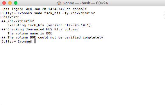

The disk is probably bad. Because it's the secondary disk I think that Disk Utility would have tried to run the fsck command on the drive. You can try that by going to Terminal and entering the following:
sudo fsck_hfs -fy /dev/[Device name] where [Device name] is what appears on the last line on the right "Device:" It should be something like disk1s2. (Make sure you have "BOE" selected when looking for the "Device:" name.)

This is all I get when I run that command on terminal:
You can see if the disk will mount in Disk Utility. If it does, quickly copy the data you need off the drive. I suspect it won't mount. What you do after that will depend on whether you have a backup of the data on the drive. If you have a backup, I wouldn't trust the drive and I would just replace it. If you don't have a backup, you can try the disk in an external enclosure or docking station or try getting software like Disk Warrior. I've haven't used it so I can't speak to it's effectiveness.

It doesn't mount. I click and nothing happens (mentioned before), so I think it might have died completely.
I have most of my data backed up, but I will lose a few files since I last backed up about a month ago (I had scheduled a back up for this weekend haha). I will try Disk Warrior (thanks for the suggestion) to see if I can save the newest files and see what happens. But thankfully, almost everything has an extra copy on my external HD.
