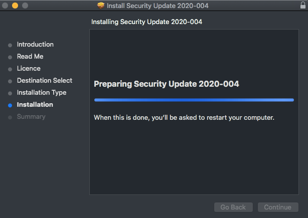

Should I see this for a considerably long time?
NB: solved itself
