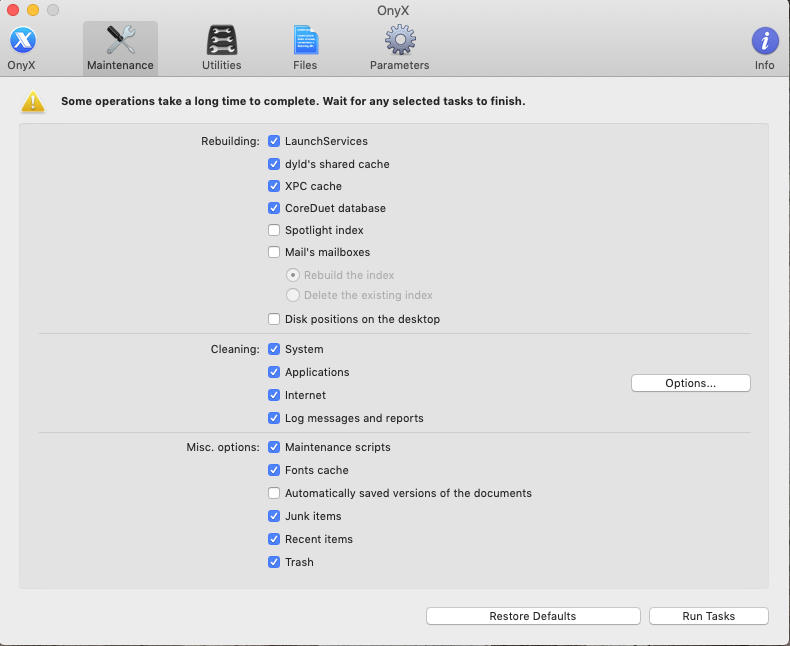

On my iMac late 2012 with 24GB of RAM, I was seeing 12GB allocated immediately after the 005 update.
I saw a post stating that running Onyx solved that (thought; Really?!) but tried it (with remove all caches etc set), and now Activity Monitor shows normal memory usage, normal as in similar to before the security update.
YMMV, but try it?

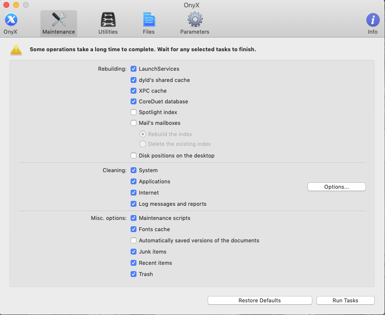

YMMV, but try it?
Can you elaborate on the settings you used for Onyx to relieve the excess memory usage? Also, this is the Onyx you are referring to:

2017 21' iMac with 8 GB RAM was almost unusable after that update.
I tend to use OnyX to clear/rebuild all caches and indices after every incremental updates - be it the .X ones or these security updates. Tried it here too. It took forever for the app to launch and even longer to finish its tasks. That was the first time I'd seen this behavior with OnyX, after more than a decade of use.
After a mandatory system restart, things were still sluggish and stuttering - although overall performance had noticeably improved. Left the machine in that state, and went out after some chores. When I came back to it, everything was working properly, just the way it was before the update. No more excessive memory compression, no more performance issues, etc.
Not sure if that little housekeeping I did with OnyX did the trick, or if it was the system itself that finalized whatever it was consuming the memory for while I was away. Still, thought I'd share the experience in case it helps anyone else. Will report back if the machine starts misbehaving again.
So I just go with the defaults?
