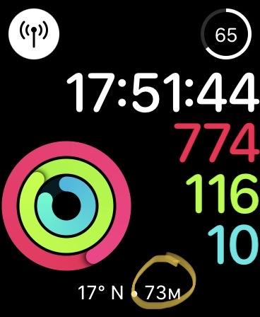

I’ve noticed today, possibly since the 7.0.1 update that the stock altimeter app shows a substantially different height to the My Altitude app. I know that the My Altitude app is correct because I’ve looked on Google Maps and it is exactly right for my location. There is about 10-15m difference between the two which is ridiculous. Could anyone confirm theirs are accurate please? Thanks.

Interesting. The elevation of my house seems to have dropped 15 ft.
Is that since updating to watchOS 7.0.1? I am reasonably confident that before this update, the figure was virtually identical to the MyAltitude one.

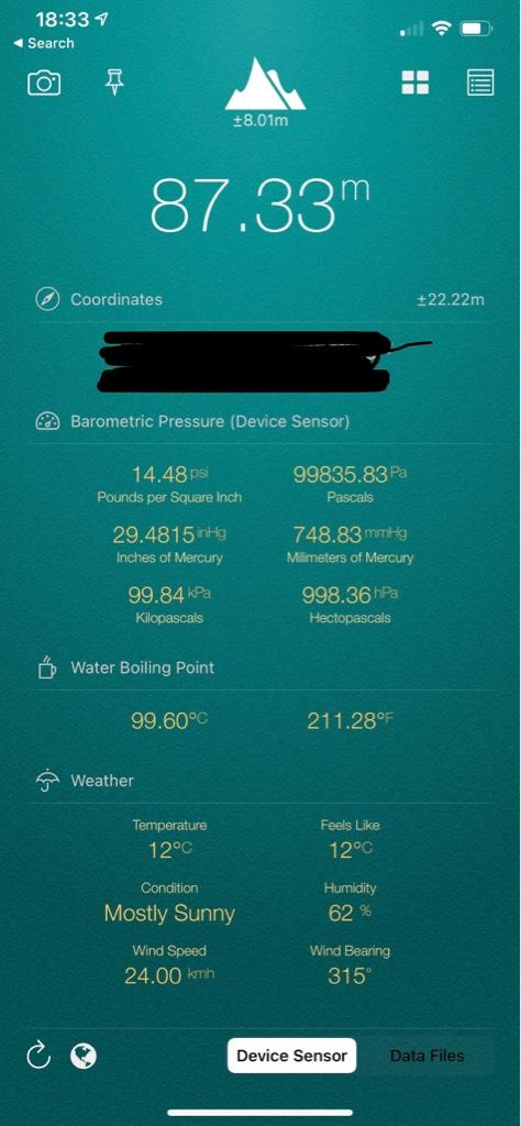

Thanks for all the replies. I’ve added two pictures from the MyAltitude app which hopefully will answer your questions, this is all above my head. One shows readings from the sensor and the other shows readings from its data files. I don’t think there is a fault with the altimeter because the MyAltitude app shows the same figure as on my previous series 5 watch.
Meanwhile, my watch using the stock altimeter app shows 70m currently.
Edit: and I’ve just checked again two minutes later and it’s now showing the correct reading of 86 m. Really don’t understand this. It’s been wrong for hours and hours and hours and now it’s suddenly correct.
To add, it’s now showing the elevation as 86m followed by plus or -5 m. When it was showing the elevation of about 70 m it said plus or -10 m.
Whilst staring at it it’s still showing 86 m but it’s now changed to plus or -10 m. I wonder where it gets the location from?

@StumpyBloke I'm going to venture a guess that location comes from GPS. The +/- 23.91m is a pretty typical margin of error for non-ideal conditions.
As for 70m +/- 10m and 86m +/- 5m -- are you in a flat location or does the ground topography change somewhat? Reason I ask is that from where I'm sitting right now, 20m one way vs the other would definitely account for ~5m elevation differences.
Also note that air pressure changes a bit under 1mmHg per 10 meter elevation change (when near sea level). The two photos show a difference of over 3mmHg, and thus just that would represent a bit over 30m elevation differential (unless I'm way off in my math?)
I think the takeaway here is I don't think we can expect substantial accuracy or agreement on absolute elevation information, particularly when the underlying data sources are unknow. Are they working purely from barometric pressure? Is the know pressure at a known location that day factored in? Is the ground location being used in some way, and if so what specific metric is being considered? Is GPS elevation being considered, which is already known to have a high level of variance from actual?
Finally - what's up with displaying Pa, kPa, and hPa on the same display? Can folks not move a decimal point quickly in their heads? 😛
Edit - checked my AmbientWeather weatherstation. Since 24 hours ago, relative pressure here has gone from 765.556mmHg to 760.222mmHg -- and at ~14mmHg per 150m (appropriate for my elevation), that'd show a 40+ meter elevation difference?
Kinda out of my usual territory here so please correct my #'s if I've botched something. General point is barometric pressure is good for relative differences in elevation but gets complicated to use it for absolute elevation.

The Device Sensor barometric reading is different than the Data Files reading. That alone can account for the difference in calculated altitude. While GPS data can also be used, the accuracy of GPS on a watch is such (typically +/- 30-40 feet) that it may not tell the whole story - anyone who has hiked in hilly terrain would appreciate that. A combination of GPS and barometric pressure is potentially more accurate.
Presumably, Data Files is coming from a local weather station. One would hope the weather station's sensors are more accurate than the Watch's. However, conditions at the weather station may be different than at your current location (altitude, location of weather front, etc.).
Altogether, you have to take all of this with a grain of salt. For the Data Files-derived altitude, it shows an accuracy of +/- 3.00 meters. For the Device Sensor-derived altitude, accuracy is +/- 8.01 meters. That is almost definitely attributable to the expected accuracy of the Watch vs. the weather station instruments. In the end, it is what it is. Compare a $400 Watch with a long list of components besides the altimeter to a weather station instrument that undoubtedly cost thousands of dollars... you know which should come out the winner.
