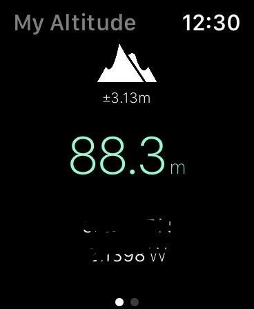

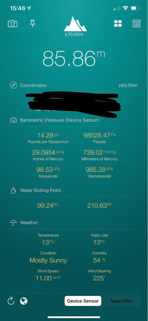

My series 6 is all over the place. In my home it varies from 86 m to 93 m sat in the same place. Pretty useless in my opinion. It often is quite different to the my altitude app whether that is using the altimeter or location data.
Reactions: wilberforce
It seems like we are confusing what an altimeter does here; or this is much more complicated than I think. An altimeter does not know your initial position in terms of altitude. An altimeter is a calibrated barometer, that displays change in pressure in the form of a change in altitude. So, in simple terms, if you are not moving and talking about a change in your elevation over time and distance, you may not be using the altimeter. For the most part, your initial position is determined by GPS (and maybe cell tower and wifi), on your phone or on your watch. So error in initial position is most likely GPS related. GPS is not very accurate in terms of elevation, so GPS related error in initial position can be significant. So the reading for your elevation at any given moment in time may be coming from the GPS and not the altimeter; the altimeter is measuring the change from whatever it was before.
Now the complicating factor is that the watch has "always on" altimeter. The older watches also had altimeters. My watch always has power and is on continuously (including when charging, the altimeter could be tracking changes?). So there it is possible that once the watch is powered and once the phone and watch have a good GPS fix on your position, the altimeter could be continually tracking your elevation and could do that mostly accurately (including possibly adjusting for weather related pressure changes). For me, my position at home has been locked in to a value + or - about 10 feet, day after day; even when it says the error factor is 100 feet or more. So I have been seeing very stable initial position elevation.
But, if I flew somewhere, or just drove up 1000+ feet to a trailhead, I still believe that the computer logic between the GPS and altimeter sensor in the watch/phone would adjust the altimeter based on GPS location (this is how my Garmin worked explicitly; so the altimeter was automatically calibrated via GPS, but you could also set it manually; I have an altimeter app on my phone and watch, and that also lets you adjust altitude manually if you know your initial position).
Reactions: StumpyBloke
I really don’t understand any of this but that doesn’t explain why it can vary massively from app to app and hour to hour in the exact same location.
Sat in the same place and in space of two minutes my reading has gone from 87 m to 85 m.
Sat in the same place again, if I move my arm up or down both the built-in app and the my altitude app do register a change in height. I wonder how that works then. Both of these readings by the way are indoors.

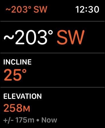

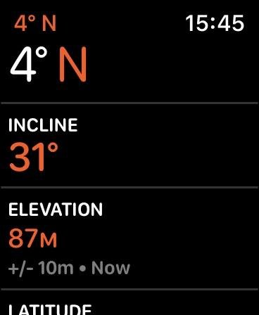

Well my altimeter has died on me. I was getting some absolutely ridiculous readings whilst out on a walk with perfect phone signal and GPS availability. It was showing me 118 m incorrectly and did not sort itself out. I restarted the watch and the Apple complications and compass app now don’t register the altimeter at all.
The my altitude app still does so I don’t know if that gets data from GPS but that’s always been incredibly accurate.
Sending the watch back for a replacement.
  • Sad
On this thread, four peoples altimeters on the series 6 have failed on the same day. Apparently it’s a software issue. Any of you with a series 6 might want to see if you’re still works.

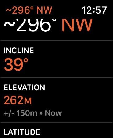

For the last few days mine was going between 84m and 260m in the same spot in my flat as well as '---' for long periods too!
I re-paired my watched and set it up as new, which seems to have fixed it for now and it's been at around 34m all day today!
This may be because it cannot calibrate the barometric elevation against GPS elevation, as GPS reception is often poor inside. If the GPS antenna can only pick up a few satellites, it first loses elevation accuracy rather than losing location accuracy. Three satellites are needed for position, a fourth satellite is needed for elevation, and greater than four satellites increases the accuracy of position and elevation.
If you get such high variation outside, that would be more cause for concern
Reactions: MJ22 and cdcastillo
I did test it and it stayed around the 260m mark even when I went outside and walked downhill towards the sea.
