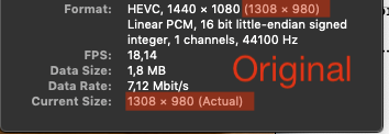

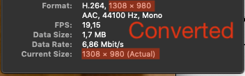

Strangely the FFMPEG -c:a copy option causes problems. It's supposed to just copy the audio tracks as is, but for some reason causes the converted video unreadable (I thought it worked before, but I might have just been lucky with some test files). I solved it by changed it to -c:a aac.
I might also need to set some options regarding the resolution because for some reason the video size is changed during conversion (according to what I've read, FFMPEG attempts to keep the resolution as long as it's not explicitly told to resize).
For some reason there are two resolutions shown when opening the video in QuickTime Viewer, and the converted video appears to adapt the resolution which the original file has in parenthesis:
As far as I can see, this only applies to the converted HEIC (HEIF) iPhone "Live Photos" and not regular videos.
