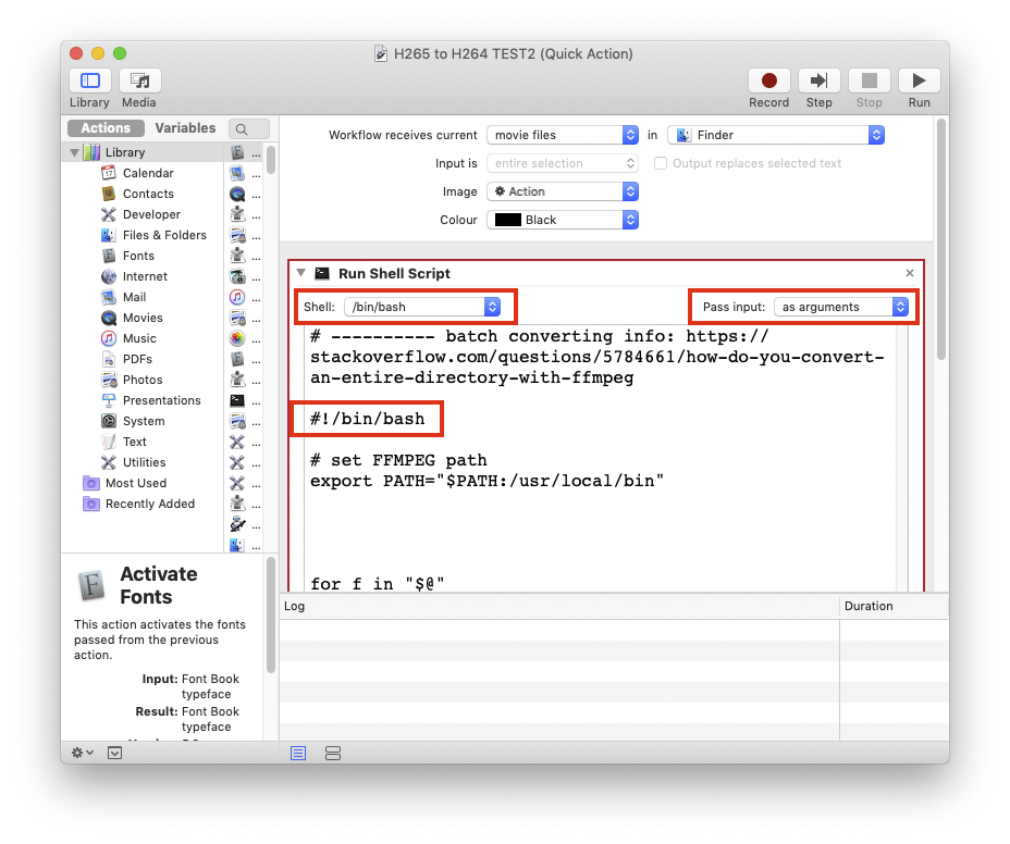

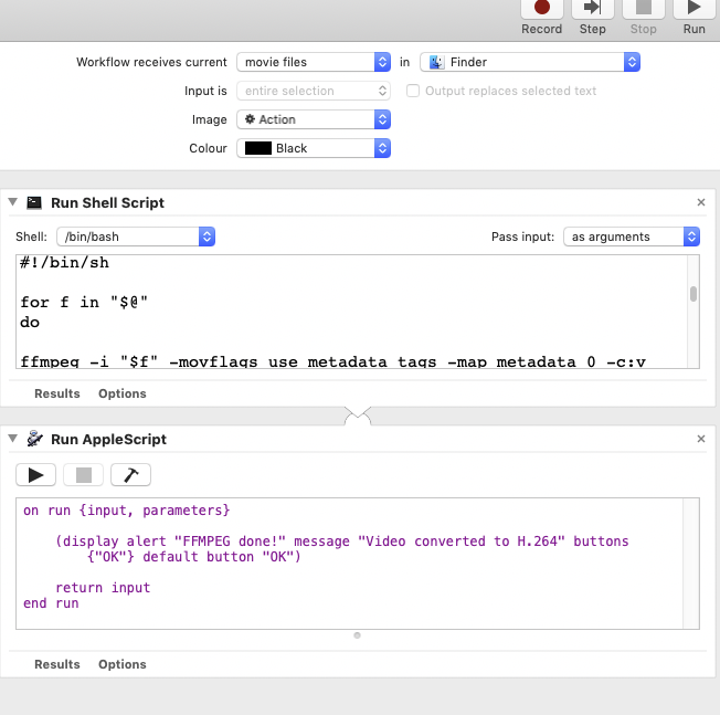

I've created a "Quick Action" in Automator which consists of a shell script and an Applescript.
The shell script looks like this:
Code:
# set FFMPEG path
export PATH="$PATH:/usr/local/bin"
#!/bin/sh
for f in "$@"
do
ffmpeg -i "$f" -movflags use_metadata_tags -map_metadata 0 -c:v libx264 -profile:v high -preset slow -tune film -crf 18 "CONVERTED.mp4"
done

When having selected the (H.265) videos in the Finder, right-clicked and chosen the Service I'm working on here I basically want the files to be copied, converted to H.264 and named using the same name as before, but "_converted" added to it (i.e. "video.mov" becomes "video_converted.mp4").
I'm not sure if FFMPEG understands .MOV files so based upon some online examples I found I chose to have it output to .MP4 instead. But I may be wrong and will take a further look into that later.
I also want to ensure that the script won't mess files up in case I mistakingly select some other file-types in the Finder, but I think I've taken care of that with the very first option in the workflow (Workflow receives current [movie files] in [Finder] -see screenshot above). Does it suffice?

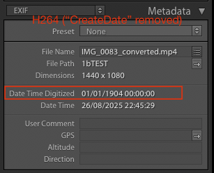

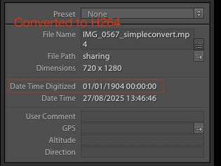

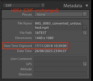

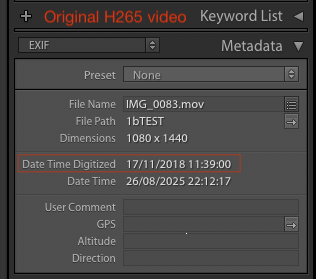

UPDATE: Using Exiftool to read all relevant EXIF info about a file (in the Terminal app: exiftool filename.mov), I compared an original video (H.265) with a converted copy (H.264) and found out that the converted copy had one tag added which the original didn't have at all:
Creation Time : 2023-05-17T10:07:48.000000Z
However, both files had the "creation date" tag with the exact same information:
Creation Date : 2023:05:17 12:07:48+02:00
As you can see, the "creation time" tag shows a time difference of exactly two hours, and it seems Lightroom (which is my go-to app for my photo organizing needs) uses that tag if it's available.
Perhaps I could solve the problem by having Exiftool remove it after FFMPEG is done with its thing, as part of the script (or better yet: tell FFMPEG somehow not to add that tag in the first place).
But I'm really just guessing here and would like to have things confirmed by more knowledgeable people than myself first.
The shell script action just uses a default shell, so it is up to you to do things such as setting the environment or working directory.
The system's ScriptMonitor application is what is putting that statusItem in the menubar, and progress is shown differently depending on whether it is a script, application, workflow, in an editor, etc. For Automator it just shows the progress of the workflow itself, e.g. how many actions have been completed, not what any particular action is doing. AppleScript's built-in progress stuff can be used, but in a workflow that would also be placed in the statusItem. Script progress indicators are a royal pain, for whatever reason, the easiest is to just use a third party background app such as SKProgressBar that is independent from whatever is calling it.

It seems like the creation date is an issue with ffmpeg, where it's reinterpreting the timestamp and then changing the timezone (and adjusting the date accordingly). And it seems like the software you're using doesn't play nicely with that (either ffmpeg is incorrectly formatting it or your software just isn't handling the timezone conversion).
If you insert this into the loop after the ffmpeg command (and remove now redundant ffmpeg metadata flags), exiftool will overwrite your file with the exact metadata from the source file. I strongly recommend you test this thoroughly, I have not used this part in my scripts for many years. As it says, it overwrites the file (in this case "original" means the original destination file, so the mp4. If you omit that flag it will create a new file with the metadata next to the converted mp4)
Yes, Lightroom is problematic with these files, but Photos on the other hand shows the exact same time and date of the converted (H264) file as the original!
I'm looking into Lightroom and how it handles metadata, and which tags it expects, and likewise if there are options for the metadata in FFMPEG which I've misunderstood the use of.

I have moved the shebang (#!) to the top, and I use the preferred method with env. This helps with compatibility as you're not dependent on a specific bash installation. Personally, I'd recommend installing a more recent bash via homebrew or macports, as the one provided by macOS is very old.
Additionally, I've set your ffmpeg path to be before any other provided paths. This ensures that the copy of ffmpeg you want to use is actually used. In the future, I'd recommend setting up your paths file in `/etc/paths`. I assume you are using an Intel Mac with homebrew. If, in the future, you get an AS Mac, you'll likely want to use the AS build of ffmpeg, in which case you'd have to change every script with the new ffmpeg path. If you modify the /etc/paths file directly, shell scripts will use that instead of relying on their own incarnation. Basically, the script itself setting the path is brittle, and you should prefer to rely on OS-provided configuration files (that's their entire point).
Automator's Run Shell Script action uses a default shell, so you would still need to use full paths, import, or otherwise set up the environment. Probably be better to just try to find ffmpeg and exiftool in the possible locations.

Unfortunately the "Capture time" is still -2 hours compared to the original (H265) file. I think I need to gather as much information about the metadata tags and options of FFMPEG and EXIFtool that I can, and do some serious testing with that.
Although frustrating I can't see why it won't be possible to just have the same metadata (except the file timestamps of course) copied over to the destination file. I'm sure there's an explainable reason for the -2 hour glitch happening, but I see it takes some researching to figure out. Also I need to find out more about Lightroom and its handling of metadata.

I don't fully understand your datetime issue - Norway is GMT+2 so they seem reasonable.
I'd recommend when you view metadata with exiftool to do something like:

First, the original (H265) file:
Bash:
$ exiftool -Createdate IMG_0083.mov
Create Date                     : 2018:11:17 10:39:00
Next, the converted (H264) file, but otherwise unchanged metadata:
Bash:
$ exiftool -Createdate IMG_0083_converted_untouched.mp4
Finally, the converted (H264) file, but with the "CreateDate" tag removed using EXIFtool:
Bash:
$ exiftool -CreateDate= IMG_0083_converted.mp4
    1 image files updated
$ exiftool -Createdate IMG_0083_converted.mp4
Create Date                     : 0000:00:00 00:00:00
I was expecting the tag to be actually removed using "-TAGNAME= "in EXIFtool, but apparently it just resets things to zero. Strange.
That's interesting. I don't use Automator, so I had (incorrectly) assumed it runs like any other shell script. For reference, editing /etc/paths works with double-clicking any other shell script, whereas .bash_profile edits do not, which is why I typically recommend it.
Code:
/usr/bin:/bin:/usr/sbin:/sbin
Appears to be the entirety of Automator's shell path.
Could the problem be due to not having ffprobe?
Yes. It uses ffprobe to extract the codec of the file. You can add "set -o errexit" above your for loop in the script to have the script exit if it fails. Unfortunately this means that if one conversion fails, the rest will not execute. This is a limitation of shell scripting.
Additionally, Automator won't by default display any messages. I found that it's possible to set the output of a Run Shell Script to a variable, then to display the variable. The output from ffmpeg will be too long, and Automator does not appear to capture Standard Error. You can fix these with more shell scripting, but it's a bit involved.
What is the difference between between
export PATH="$PATH:/usr/local/bin" (which I had used)
and
export PATH="/usr/local/bin:$PATH" (which you've used here) ?
The order of the paths matter, as the first one takes precedence over latter paths. If it finds ffmpeg in the existing part of the path it will use that instead of the one in /usr/local/bin. Doesn't really matter given the new info about Automator's paths.
Some argue that you should keep the system provided paths first, to keep compatibility with existing scripts. In my experience, however, almost all the scripts/commands I have come across where this matters are ones that expect the GNU/Linux version of commands, where macOS's BSD commands to not share complete feature parity. Additionally, if you use Python, this would prevent you from accidentally using macOS's ancient Python installation when that was still a thing.
Aha! So if I get a new Apple Silicon-based Mac I only need to edit its /etc/paths file and I can continue to use the scripts I've been using with my previous Intel Mac?
In theory, but alas Automator does not read that and is stuck with static paths.

I'm a little confused.
Does this mean I should change the shebang? In posting #7 you suggested I put the shebang at the top of the shell script, but you also changed it to "#!/usr/bin/env bash" (I had previously used "#!/bin/bash").
Should I replace both with the one you've posted here?
And how does this relate to the "Shell" selection button in Automator? Is this actually a replacement for the shebang?
On a sidenote I've understood that it's key to set "Pass input: as arguments" (not the other option which is "to stdin") to make it all work:

I decided to simplify things and skip the script altogether for now, for figuring out the date issue, by doing a very simple Terminal command:
Bash:
$ ffmpeg -i IMG_0567.MOV -vcodec libx264 IMG_0567_simpleconvert.mp4
... which I then opened up in Lightroom for comparison:
This very simple command changed all the following date/time related tags to zero:
[QuickTime] CreateDate : 0000:00:00 00:00:00
[QuickTime] ModifyDate : 0000:00:00 00:00:00
[Track1] TrackCreateDate : 0000:00:00 00:00:00
[Track1] TrackModifyDate : 0000:00:00 00:00:00
[Track1] MediaCreateDate : 0000:00:00 00:00:00
[Track1] MediaModifyDate : 0000:00:00 00:00:00
[Track2] TrackCreateDate : 0000:00:00 00:00:00
[Track2] TrackModifyDate : 0000:00:00 00:00:00
[Track2] MediaCreateDate : 0000:00:00 00:00:00
[Track2] MediaModifyDate : 0000:00:00 00:00:00
It also removed "CreationDate" which was present in the original file:
[Keys] CreationDate : 2022:03:02 13:13:05+01:00

UPDATE: Having tried so many different things with FFMPEG but always ending up with the same result (regarding "Capture Time" in Lightroom) I decided to shift my efforts on to EXIFtool for a while.
So, having successfully converted a H265 video over to H264 (using FFMPEG), I took the converted file through the following command which reads the metadata from the original file and copies it over to the converted file:
Bash:
$ exiftool -tagsfromfile H_5470.mov H_5470_converted.mp4
Warning: [minor] The ExtractEmbedded option may find more tags in the media data - H_5470.mov
But again, the time shows a -2 hour shift in comparison to the original video in Lightroom. But in Photos it's the exact same time as the original video.
What does this all mean? What is it with Lightroom that makes it shift the time by 2 hours?
