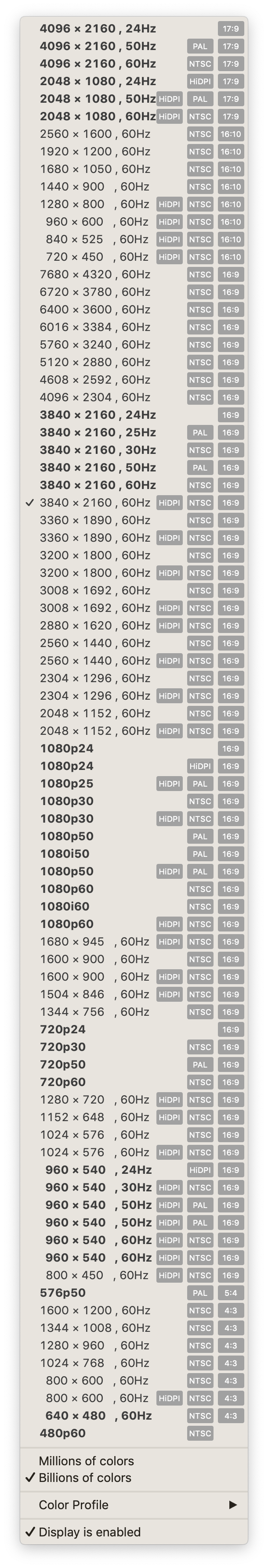

You should be able to get 4096 @ 60 Hz. Here's a pic. You'll see all the options I can get.
If you're only getting 30Hz @ 3840, it might be your cable, or card. I'm betting on your cable. Buy a good 4K cable. With any of these cables, YMMV.

Yes, I agree. I'm definitely not seeing those options, and I'm betting it's the cable. I'm wondering if it being set to 30Hz all day might also explain why it was more fatiguing to use (I'm a software developer).
I could never work at 30Hz. Too much mouse lag. I would start with the 4K cable. There is a huge difference between 30 and 60Hz.
