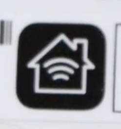

Does the bridge have a black sticker on it with a picture of a house with 3 lines in it?
If it does, then you should be able to just put your phone near the hub to add it....as long as the phone is a iPhone 7 or newer.

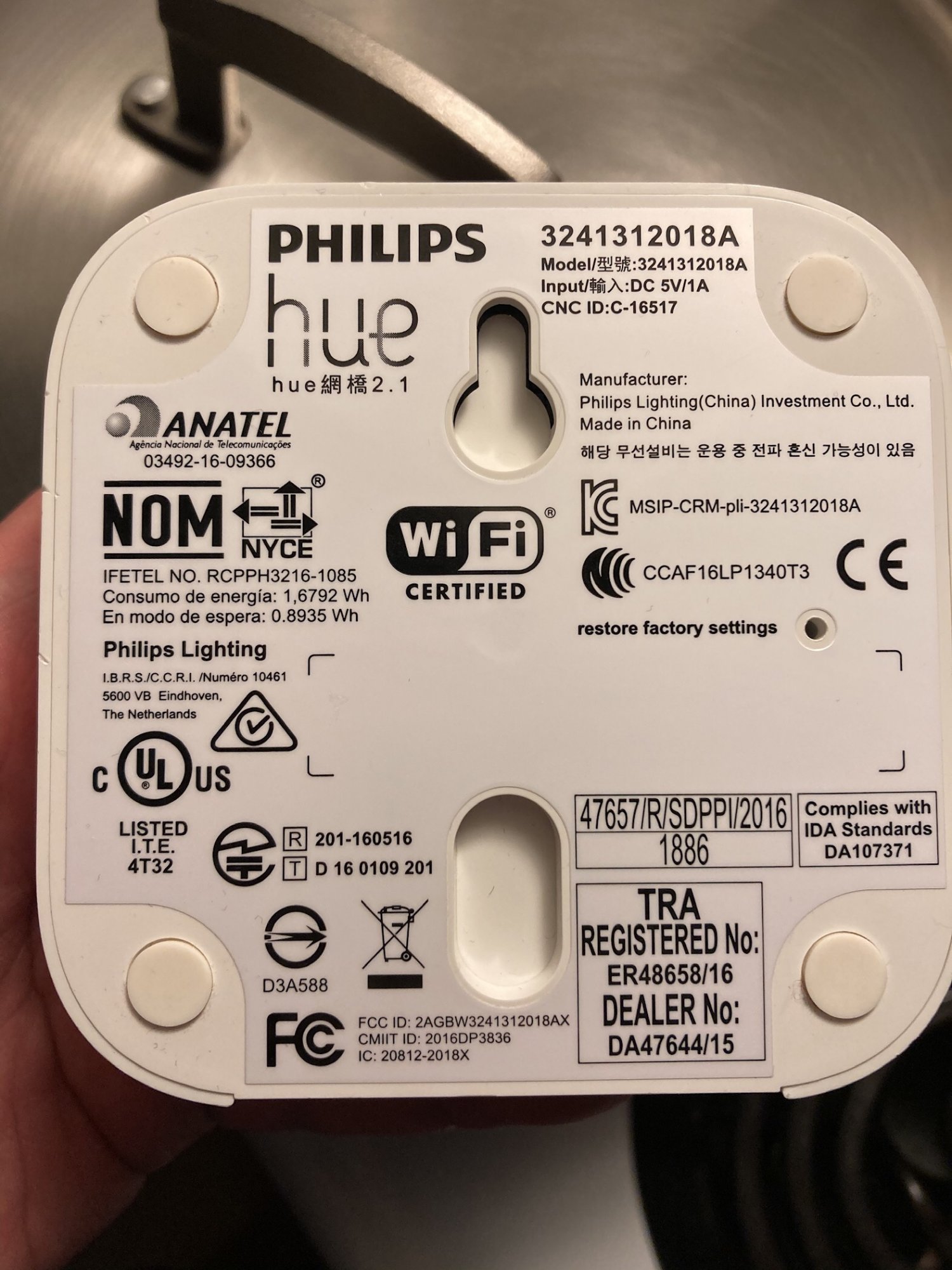

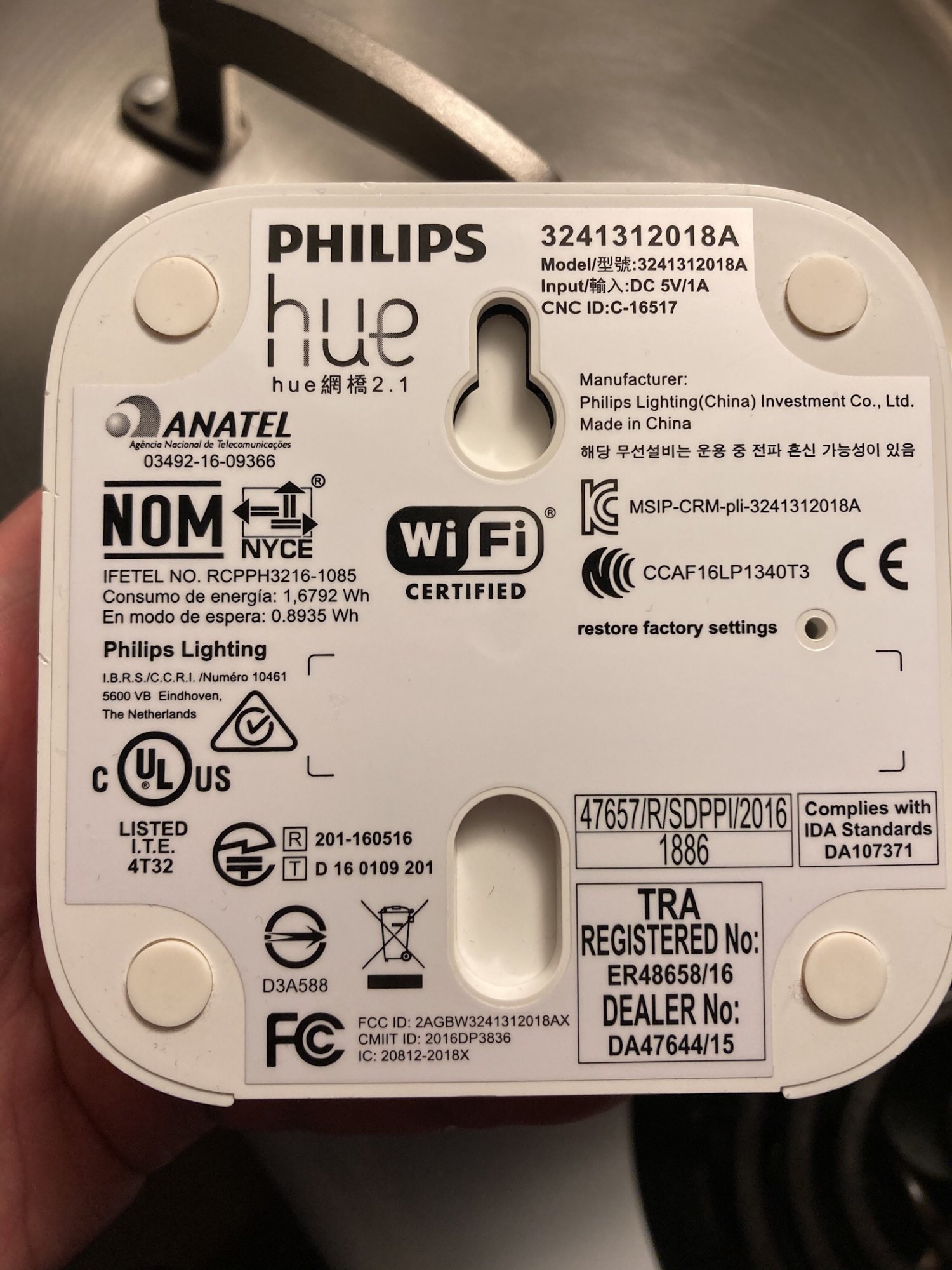

There are no HomeKit stickers on his bridge at all.
Mine has far fewer information but has the HomeKit sticker in that white space between the brackets. Is there such a thing as non-HomeKit Philips Hue hub?

The HomeKit sticker and code would have been in those bracket (below the WiFi certified label). I’d call Philips and see if they can provide the HomeKit code for the serial number.

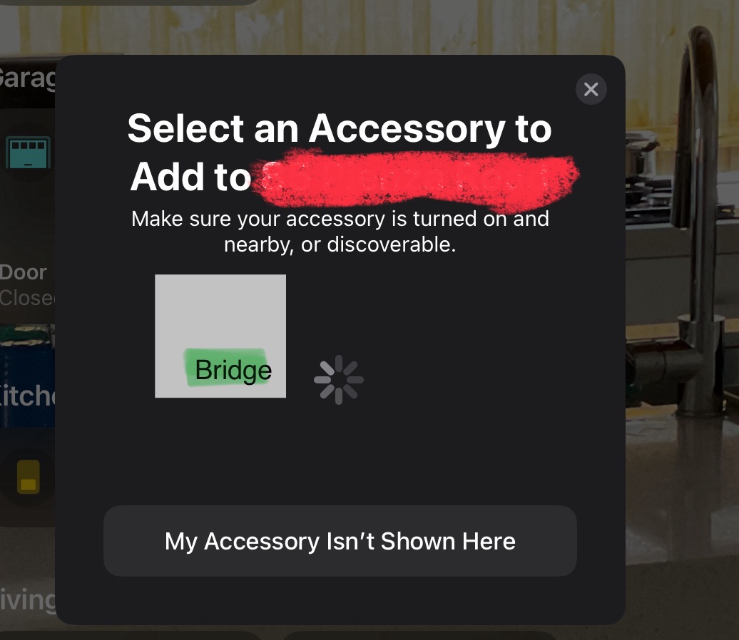

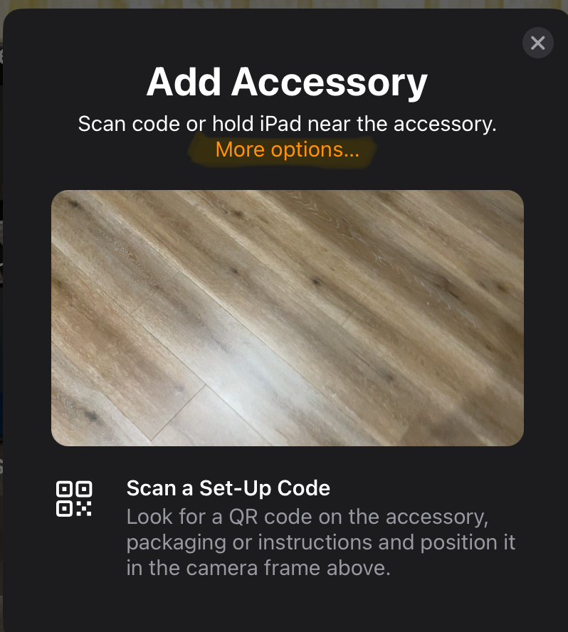

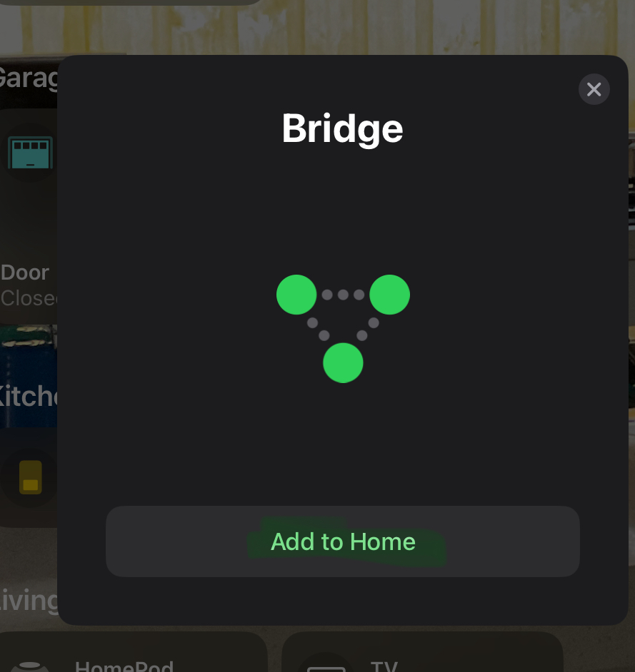

You can still pair it with HomeKit by doing the steps below
1. Click the plus in HomeKit.
2. Click More options.
3. Click the bridge if you see it.
3. Click add to home in the popup
Hope this helps! Tell me if any errors happen on your journey or if it works.
