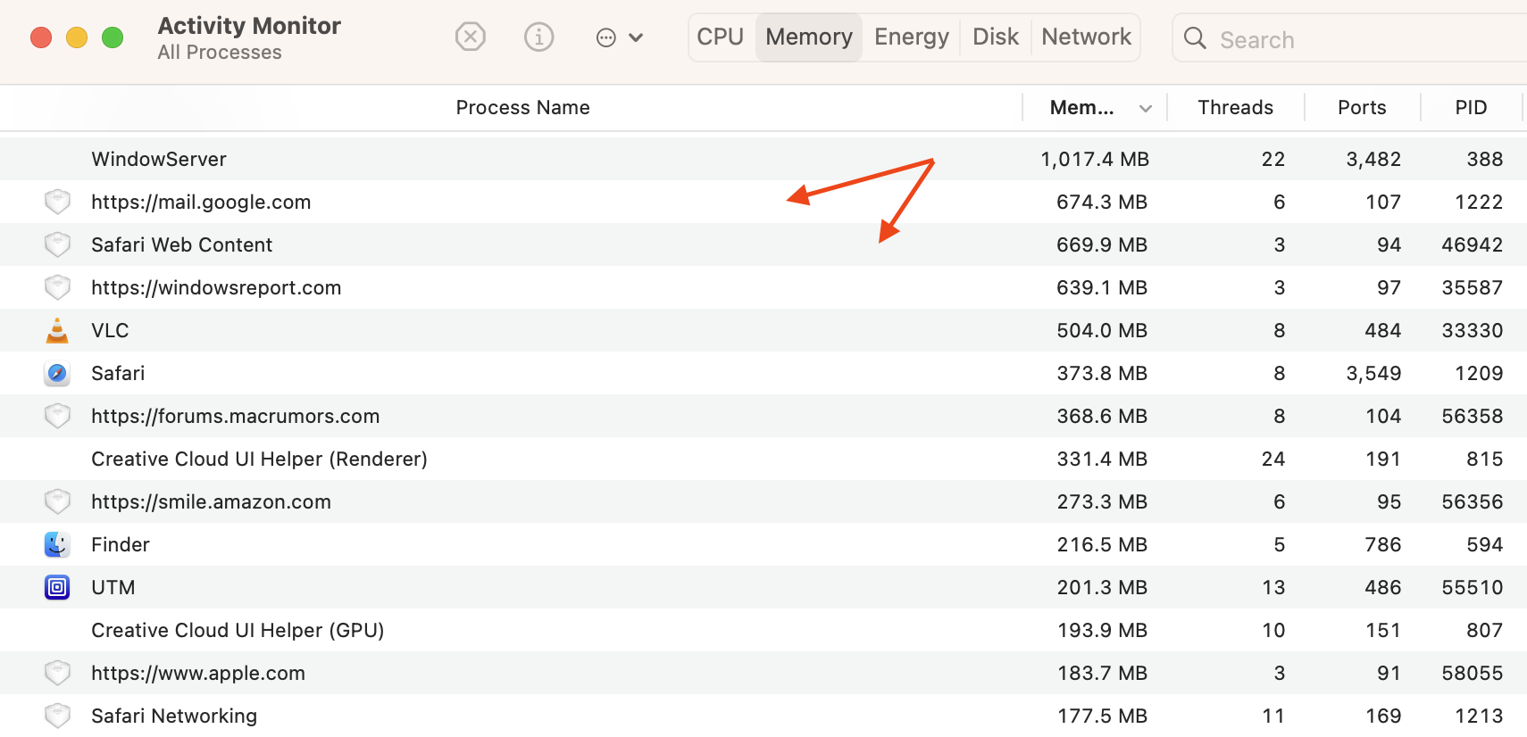

I'm running a TON of stuff on my work MBP with 16GB, so given the workload you've specified, I expect you'd be just fine to downgrade the mini as well to spend more on a monitor. I've had an ok experience with a U2723QE as well, which would get you to a USB-C native monitor, but I don't feel like it's a real upgrade over the old monitor from 2015. It's brighter...
