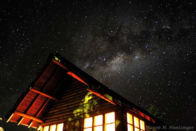

Here's my (final version - "no longer too blue") of my night sky shot in Tanzania from last summer:
This was 30 seconds at ISO 1600 with a WA lens at 19mm (30mm equivalent) at f/3.5 (wide open), manual focus, in a Canon 20D dSLR.
For minimizing shake, I used the camera's options for flopping the mirror up early and then the (IIRC 30 second) shutter delay. If I recall how this worked, when I pressed the shutter release, it wobbled and made noise as the mirror flipped up, then several seconds later, it tripped open, then closed the shutter (minimal shake).
Post-processing, I increased the effective exposure by another +1 stop to brighten it up, plus added some sharpening and color balance work. Given that the 30 sec exposure used here was long enough to cause all the stars to streak, I don't think that I'd want to go with any longer exposure times (shorter would be better). Similarly, I didn't want to use ISO 1600, but I really wanted to pull up the very faint stars in the milky way to really get the desired impact.
FYI, I had also tried some "deep sky" shots with a telephoto, but the relatively long exposure times with the narrower viewing angle made the streaking of stars much more pronounced. You can check out an example at 100% pixels from a 70mm lens by clicking on this link.
I'd say that the main thing is to just go grab your tripod, figure out how to set the camera up with mirror lockup and delayed shutter release, then try some shots at different settings. Then, don't give up on them if they look a little "blah" at first glance...give them a little bit of post-processing too.

cool shot, hh. what kind of light is inside the house? if it was a normal light, wouldn't that be way overexposed? Is it a candle? I'm thinking a candle would look different at 60 seconds, and I'm really trying to figure out what the source of light is in that house.
Yes, the lighting was from ONE candle.
Also, the funny green on the right side of front of the cabin is light from a spotlight around 200m away that appeared (when I took the shot) to had been fully shaded by an interposing tree. It turns out that it wasn't completely blocked: the green leaves on the tree effectively acted as a green filter, which produced this green-tinted light. The high ISO and long exposure time did the rest, as this scene is otherwise around EV -5 or -6.

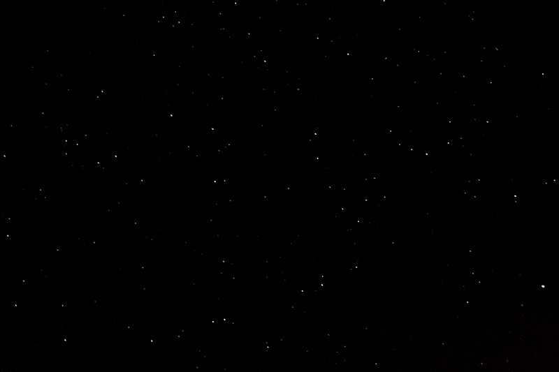

heres my first attempt
not so good, shutter at 30 seconds iso 1600, going back out to try iso 100 now
unfortunately theres not many good stars out tonight, theres a cold front coming through friday that will be good star gazing weather, it always clears out the atmosphere
ISO 100t didnt work out so well, guess im going to have to read up on it more, and find a better night

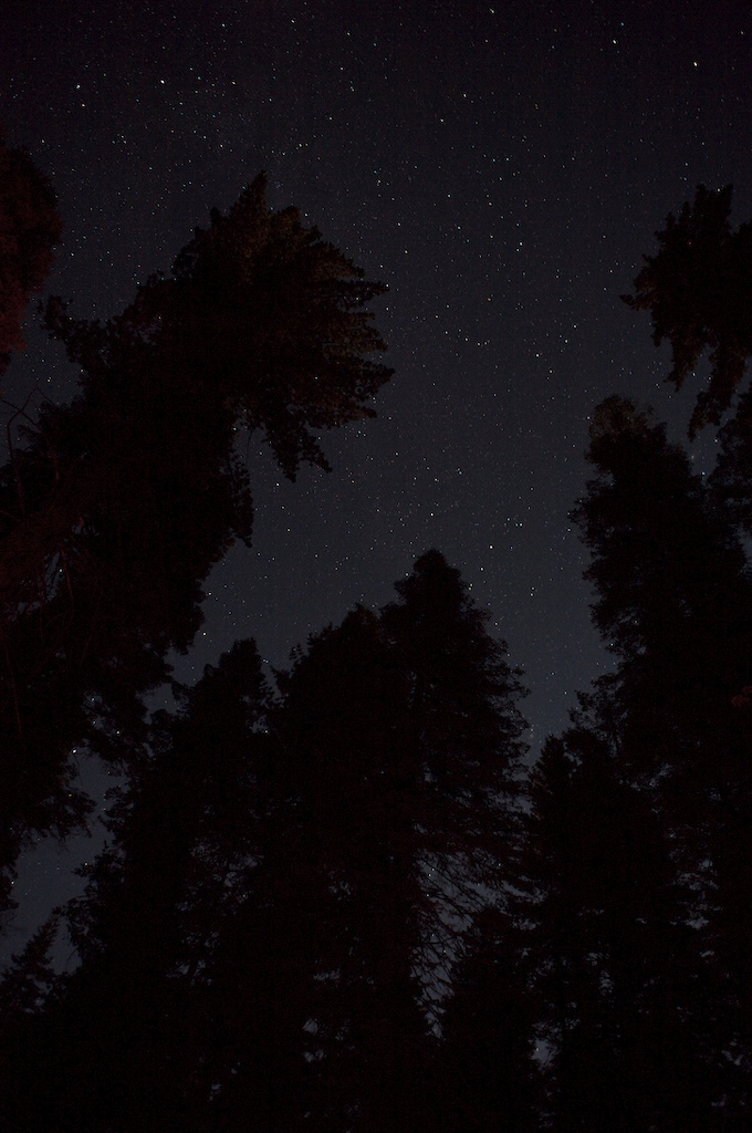

there has been some good advice and pictures posted so i'll just put one up too
this was taken at f5, 30s @ISO 400, pointed nearly directly overhead and zoomed in a bit

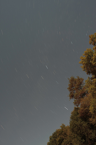

flashlight tag on the beach 😀
Model: Canon EOS DIGITAL REBEL XT
Shutter Speed: 20.5mins
F Number: F/9.0
Focal Length: 10 mm
ISO Speed: 100
Date Picture Taken: Oct 29, 2006, 3:25:45 AM

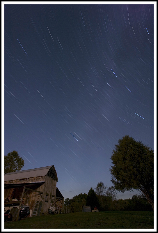

I'll add one
From Here
1,521 seconds at ISO200 f7.1
A quarter moon was peeking out just at the end of the shot --hence the well lit barn, it was pitch dark before.
Cheers
