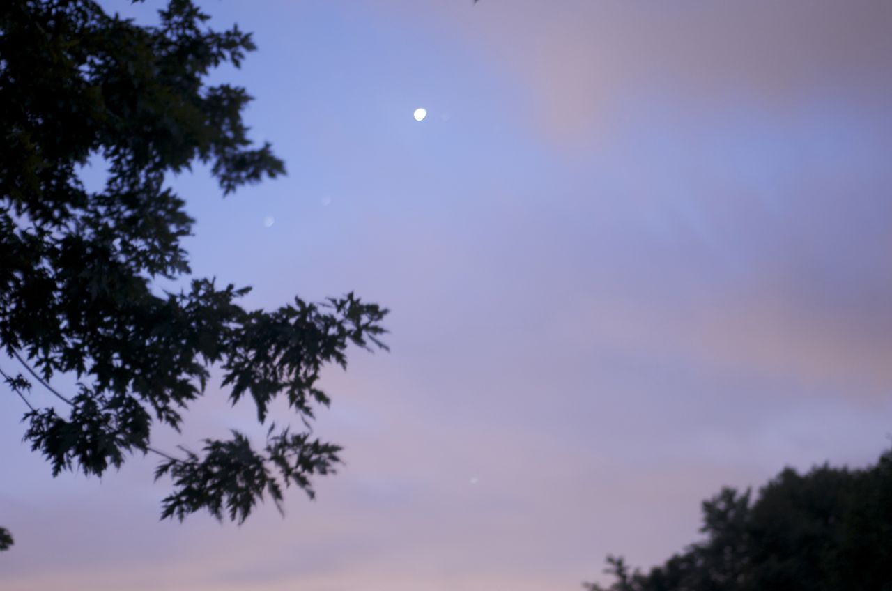

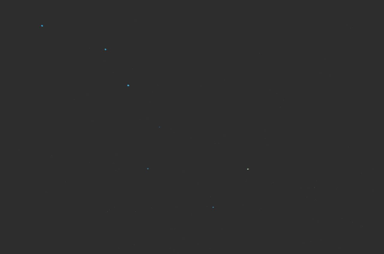

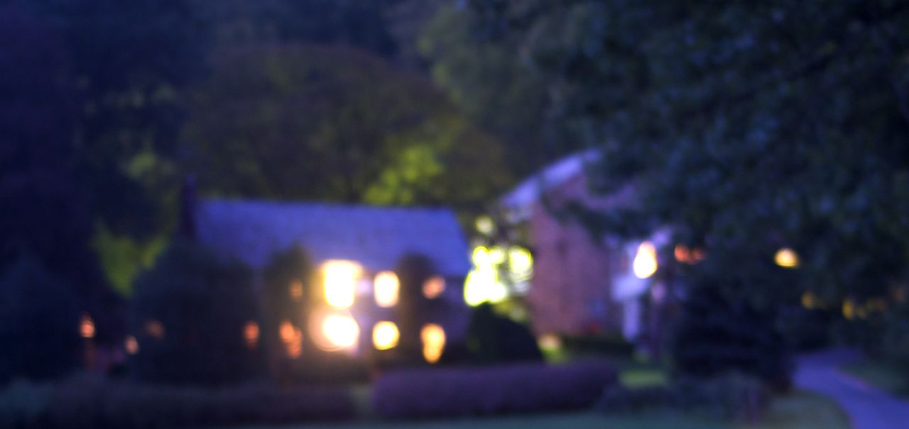

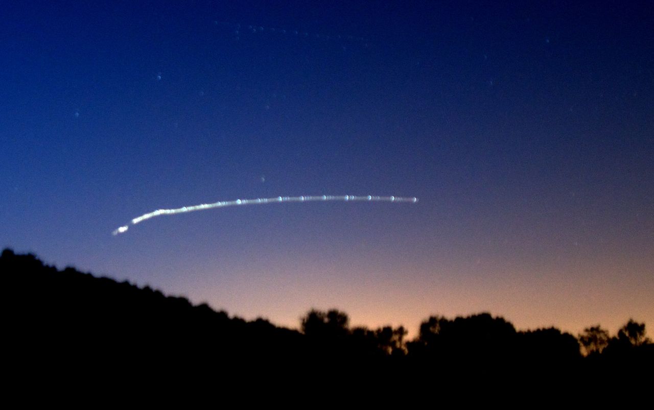

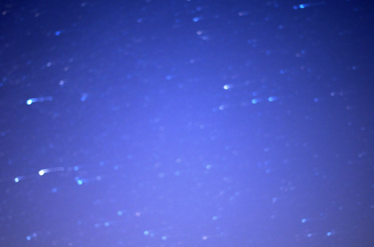

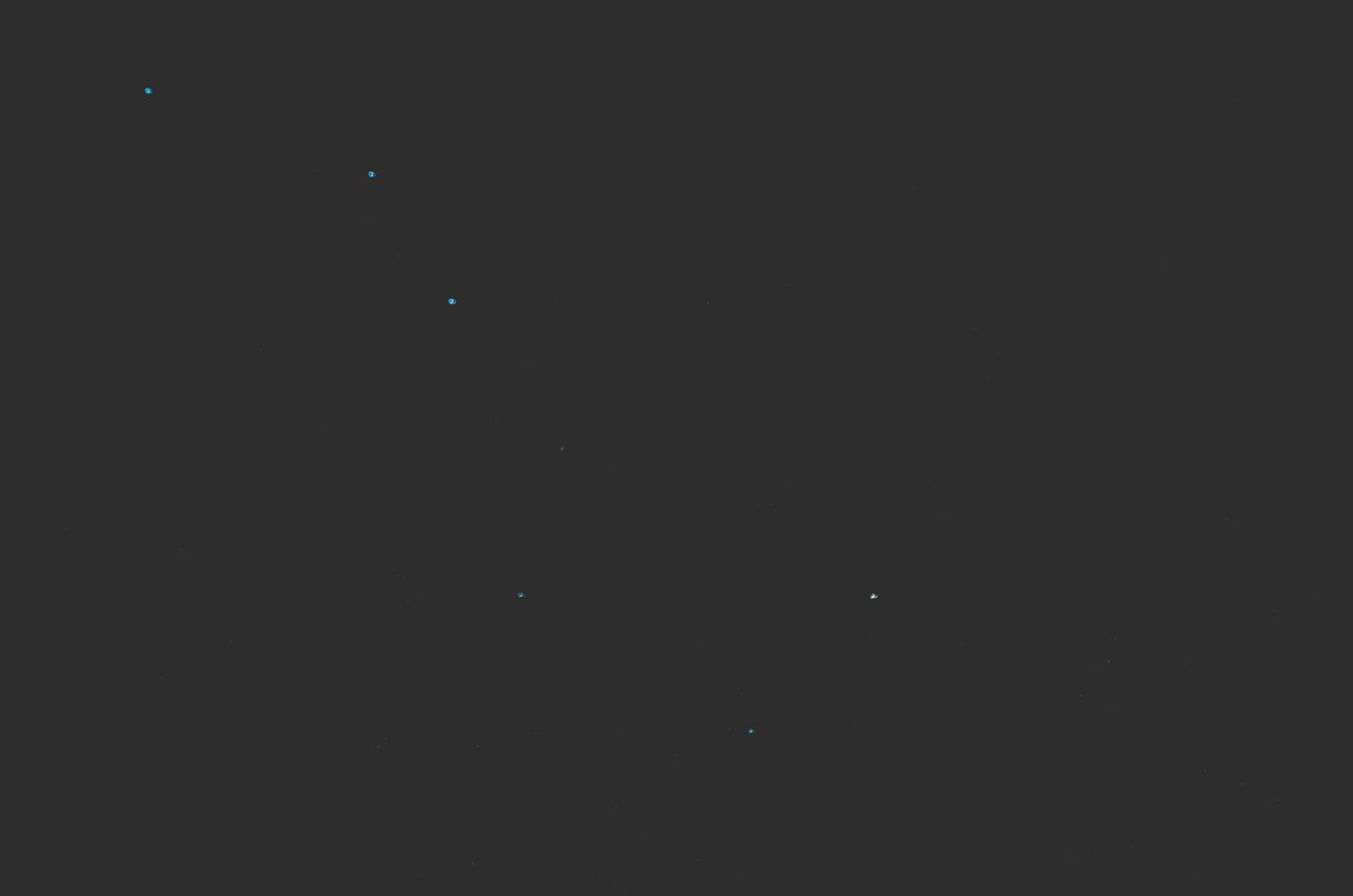

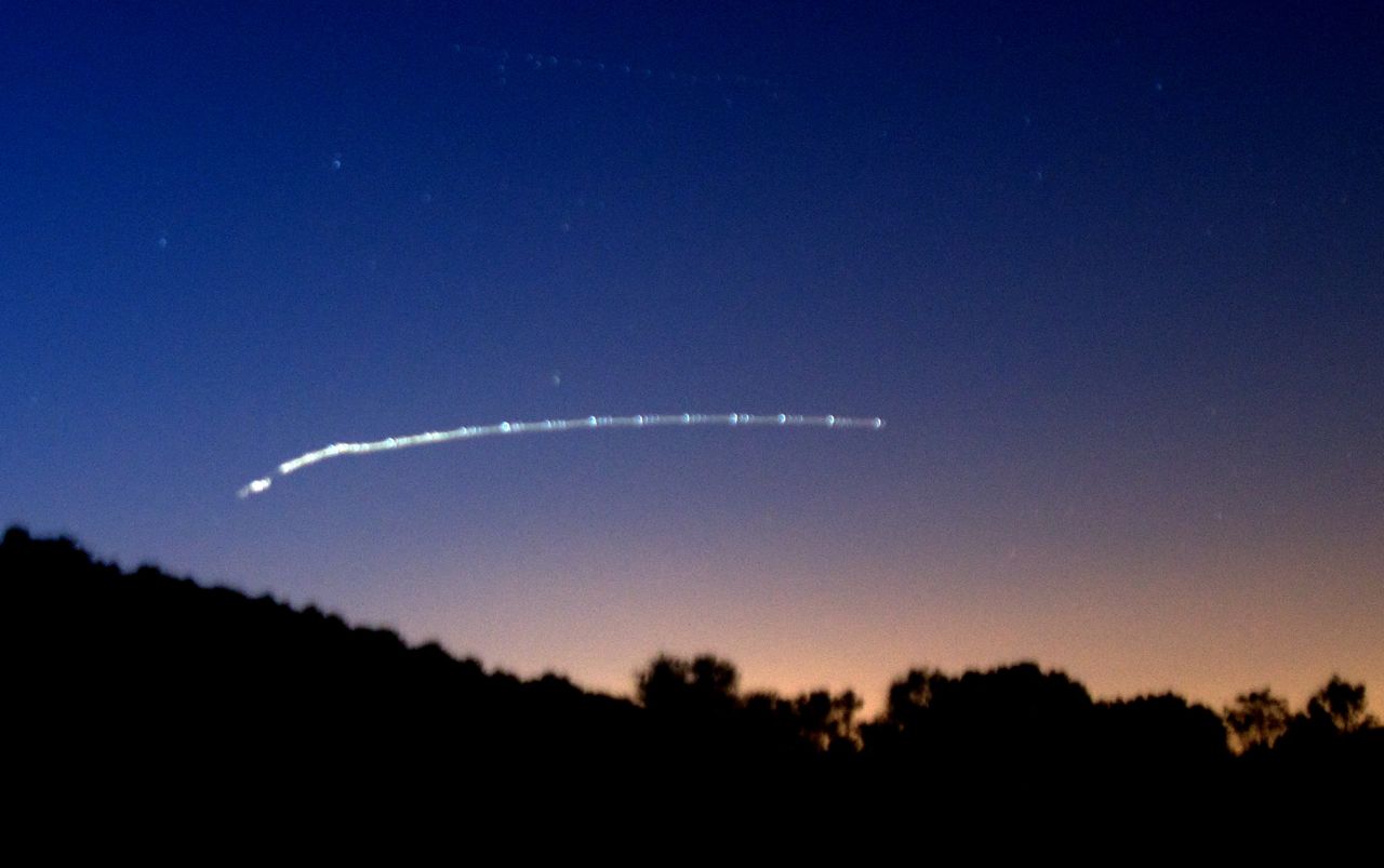

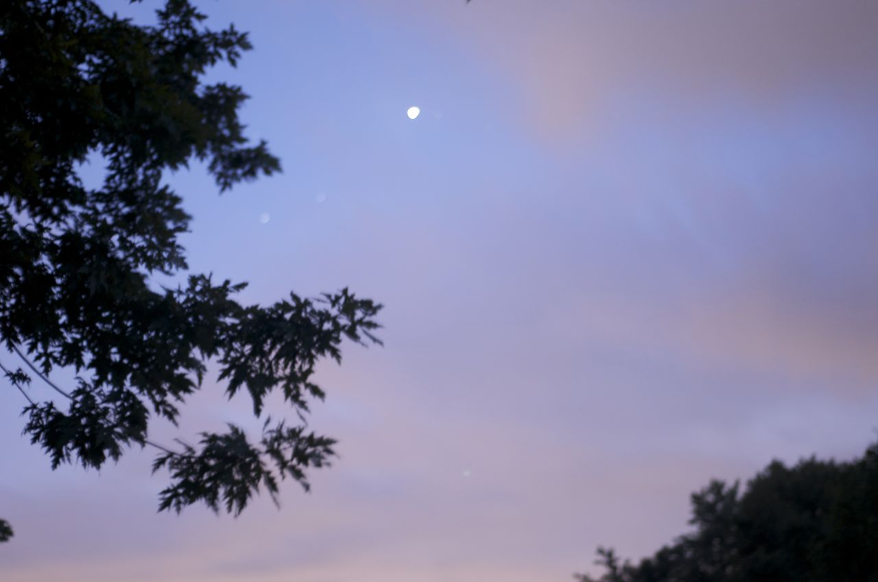

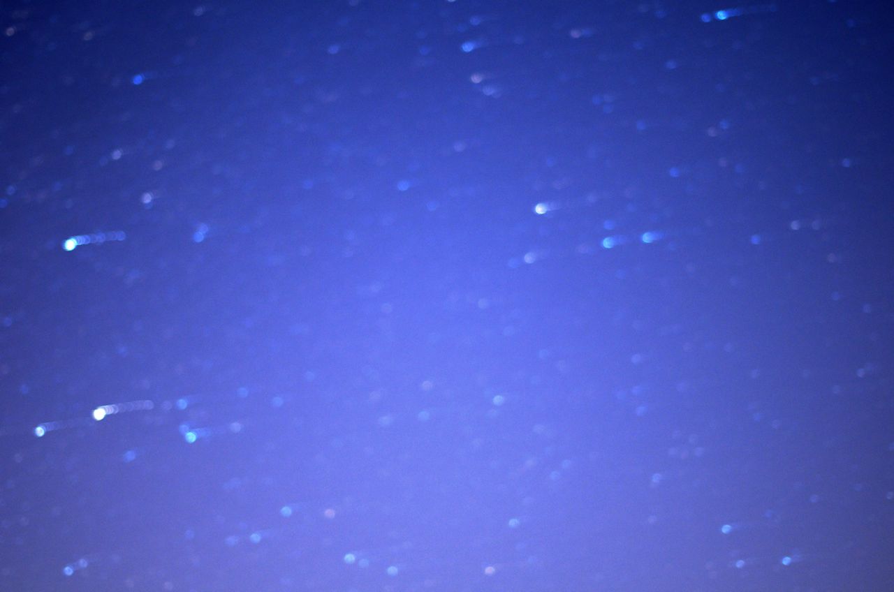

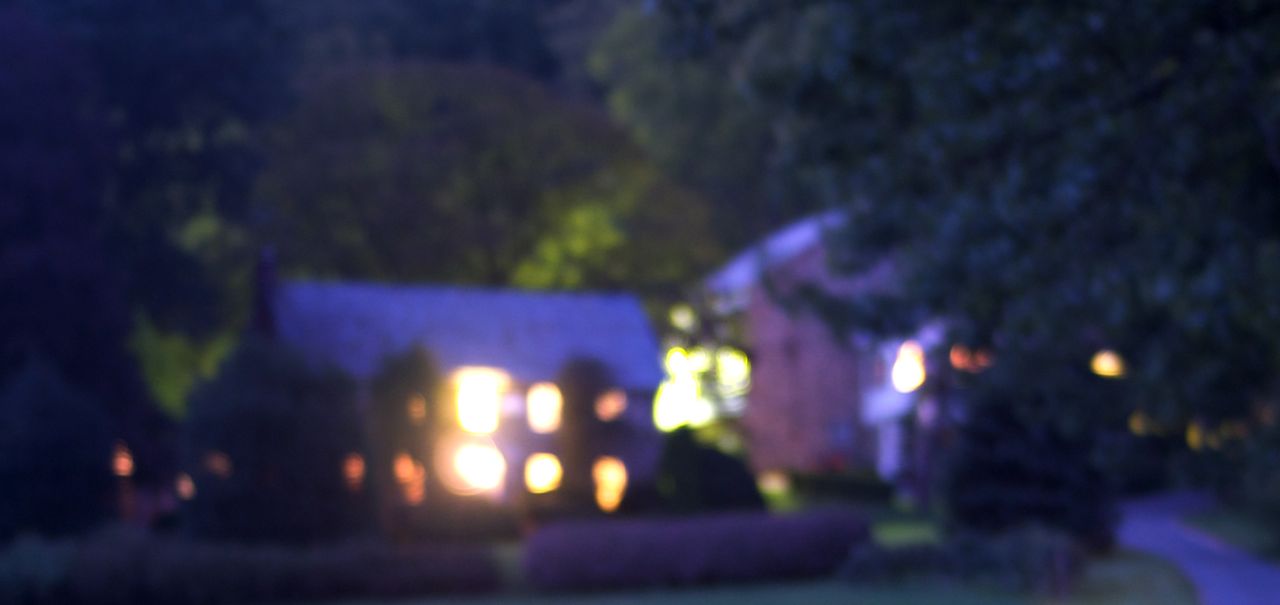

I agree, I've been out 2 nights winging it, I read a little bit in the camera manual, but now I have some more things I can try. I am trying to get a shot of the International Space Station one night when it flys over my area. From the information I have it should go through the bottom half of the big dipper. I shot the big dipper, but I am still not satisfied with the picture. I will attach some practice night shots I took on those 2 outings, some of the sky and some of the field and the farm house, and one of a helicopter light trail. I used a nikon 50 mm f1.8 lens the first night, and a sigma 17-35mm f2.8 the second night.

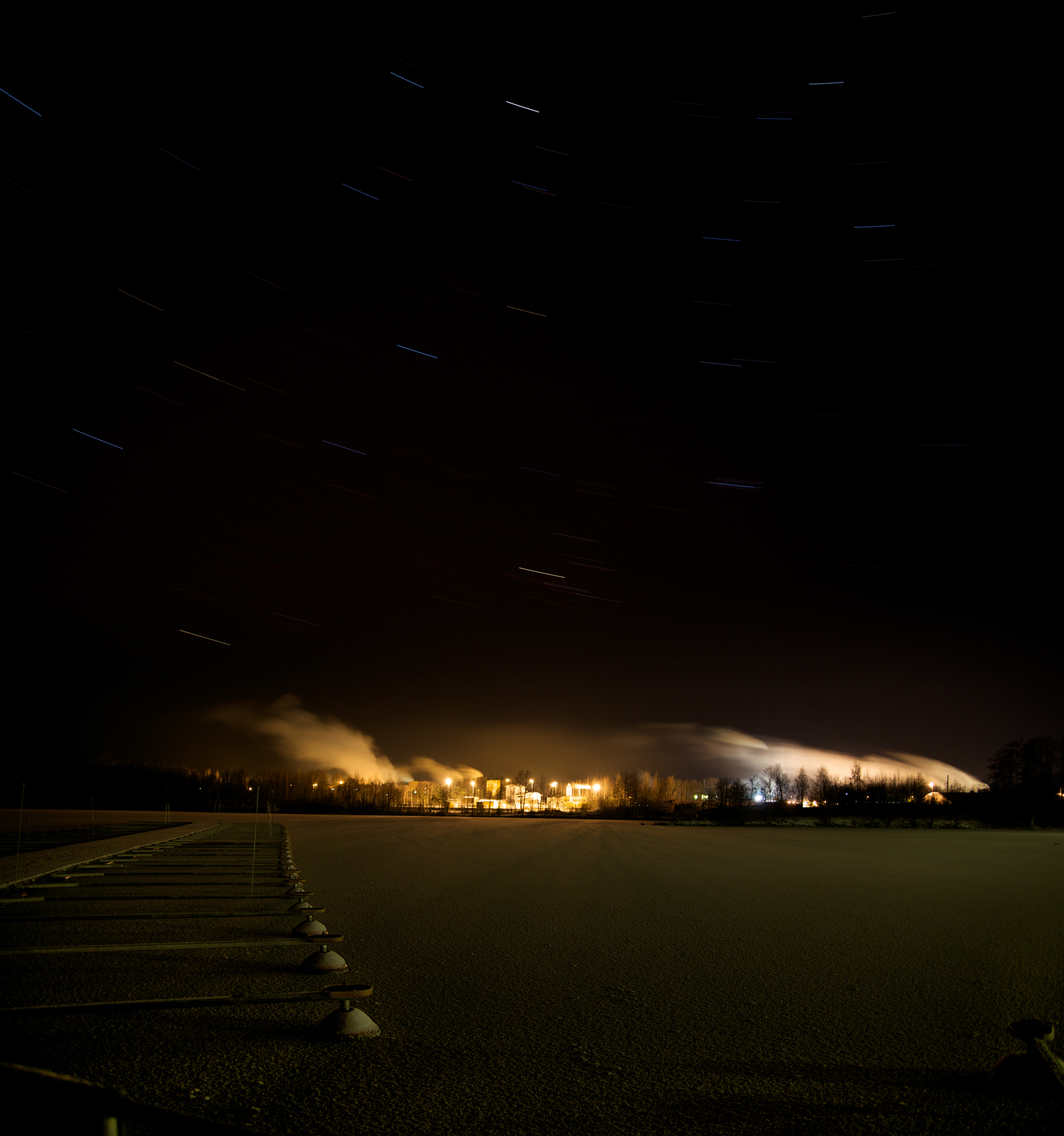

Ok I want to know how you got non streaking stars. usually, especially at 30 secs they are already streaked. Yours appear very nice, clear and lots of them.
This is a really good, one of the best ones i have seen, image and the amount of sky detail for 30 secs is amazing.
Now, I exposed 10 minutes and have nothing like that.. (I was going for trails but still, no nebula and believe me the sky was frigin clear and very cold at -20C 😀)
I thought i did well but that one blows pretty much any night pic i have seen so far, especially on this forum, way out of the water..
