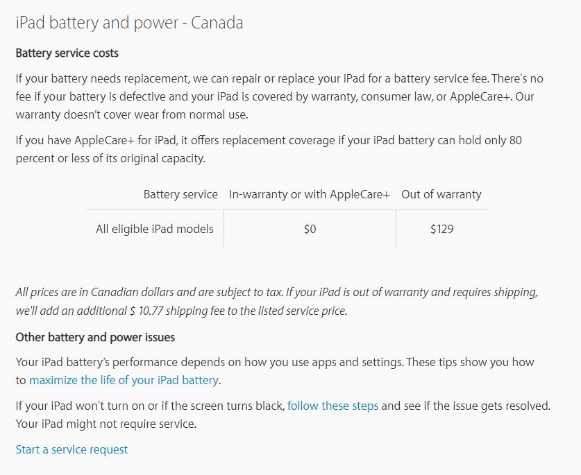

Where did you try to get it done? This is on Apple's (Canadian) website, so it appears that it is a service that they offer and the Air 2 is not yet on the obsolete list so they should still have parts for it. Was there something else wrong with your iPad that they refused service?

Where did you try to get it done? This is on Apple's (Canadian) website, so it appears that it is a service that they offer and the Air 2 is not yet on the obsolete list so they should still have parts for it. Was there something else wrong with your iPad that they refused service?View attachment 811841
No, nothing wrong with it. Based on what I read online, I assumed they would replace the battery. When I took it in store, they told me that they can only replace the entire iPad (for the battery replacement fee). Because I'm on iOS 12 and don't think I can transfer old apps to a new device, I declined.
Ah ok, that makes sense. Most places probably can't do iPad battery replacements in store so the whole unit swap is the only option for same day service.
That's how Apple does it with all iPads. You get a refurb unit unless you have an engraved back—in that case, they will replace the battery and you'll get yours back in 4–6 weeks. They state this on their support site.
