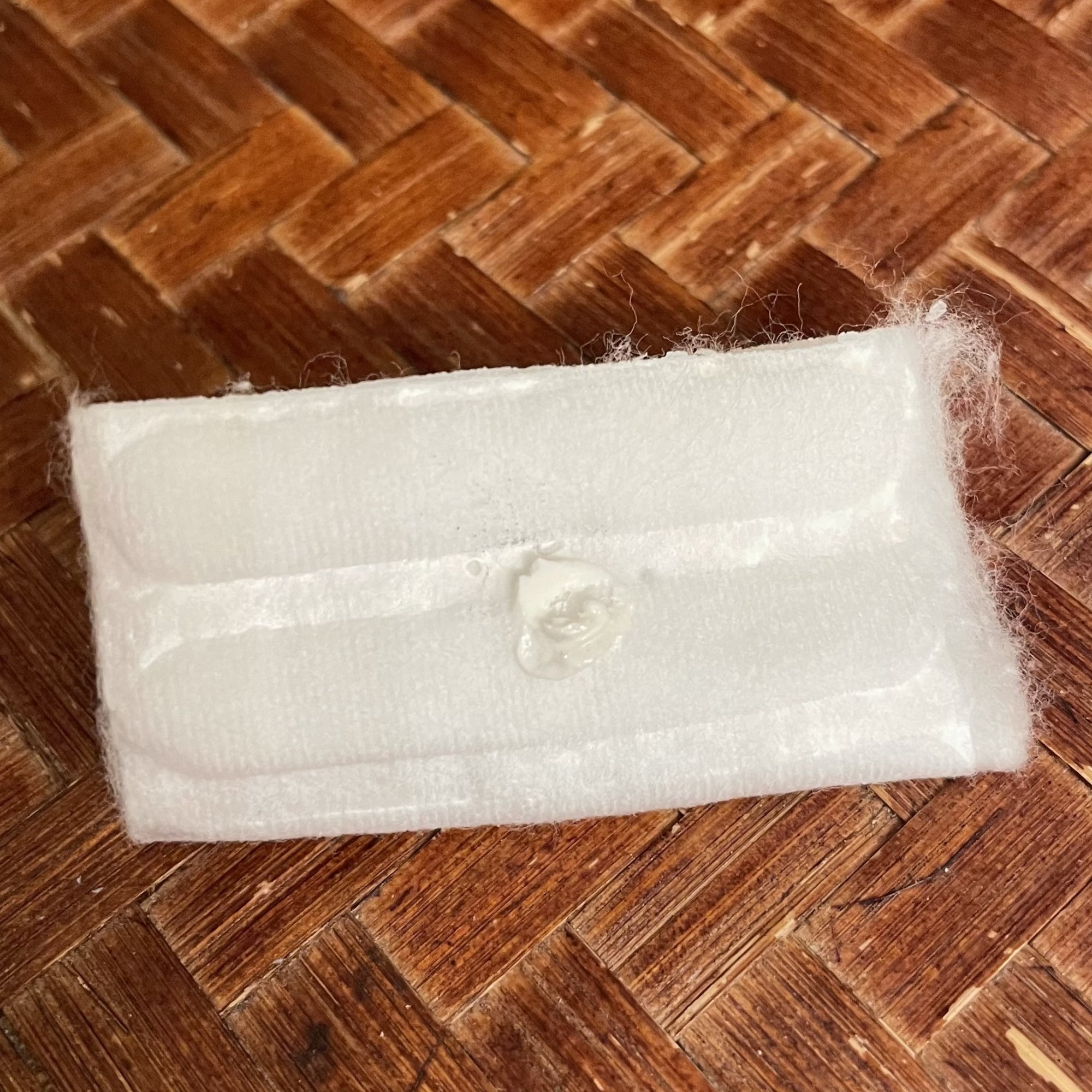

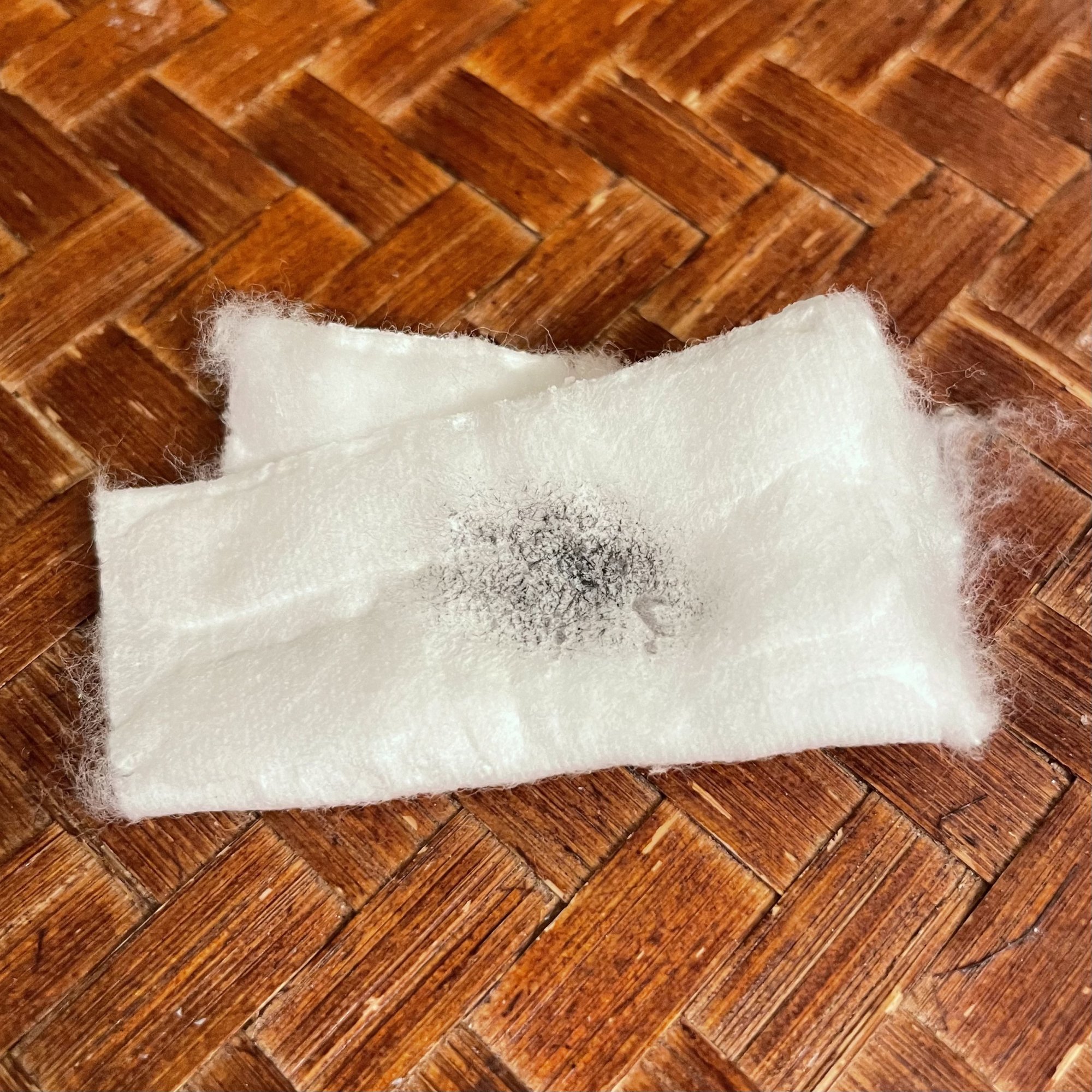

First thing I did when I got home was test it out! Used a white metal polish on a white cotton pad and gently rubbed the lower right corner of the phone. Stainless steel residue did in fact transfer onto the cotton pad, which means no PVD finish!
Only a small amount of transfer is on the pad but rest assured, I only went as much as needed to confirm because the phone is less than 12 hours old at this time so it doesn’t need a polish yet.

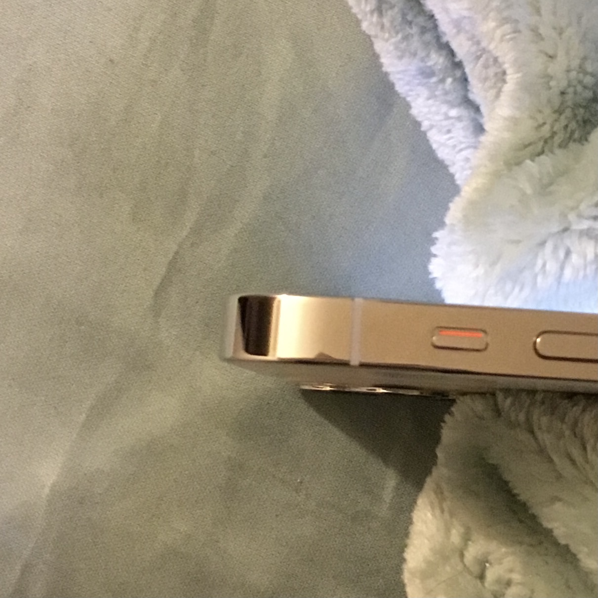

Today I was trimming my beard in the shower. Suddenly the water turns off and I’m covered in hair. I wasn’t about to get hair everywhere so I decided to wait for my complex’s water to come back on while browsing the web. Suddenly the water comes spitting out but it’s BROWN from who knows what, so my reaction was to jerk backwards. Dinged the upper right corner of my phone and get a little bummed out despite how minor it was.
Eventually I decided to sand and polish the corner already knowing it’s raw steel. Came out beautifully!
Small ding near the screen:
Sanded with 2,000 grit:
Perfect again!

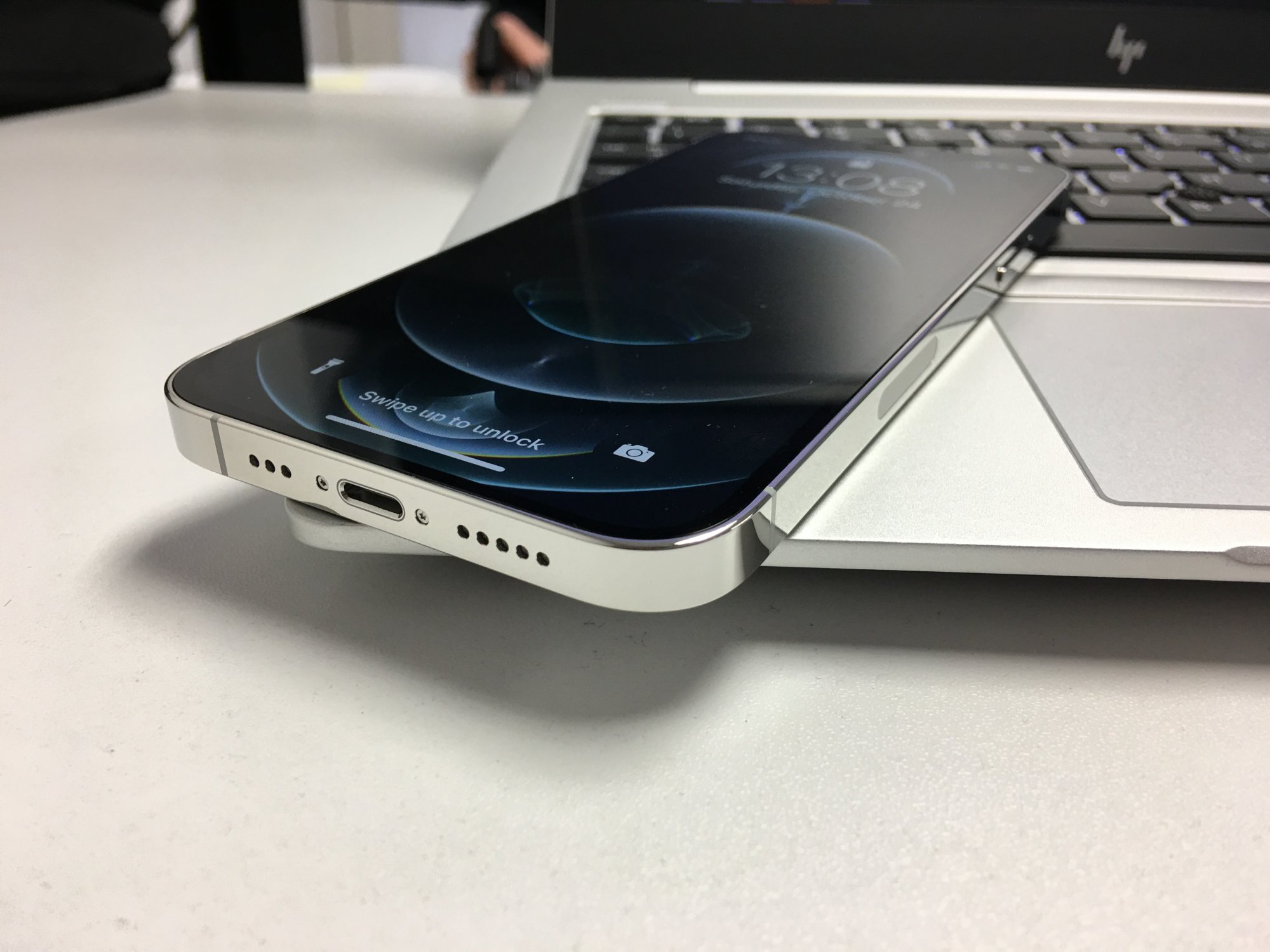

Looks like even with Silver iPhone 12 Pro it does have PVD coating.
Someone has Silver iPhone 12 Pro, and has scratches on the band, however Silver should be the easiest to be polished.
I went to the apple store today and the silver was already scratched near the lighting hole from people picking it up off the charger and this was after the phone being out for 24 hours.

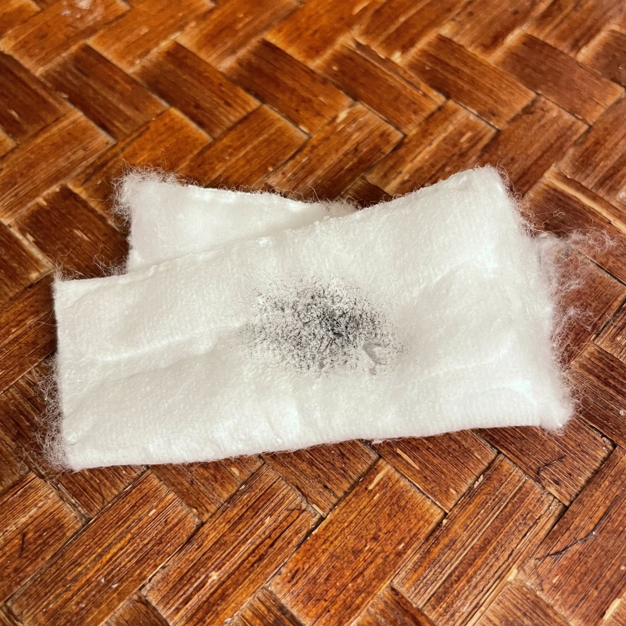

Means nothing. Any contamination will turn black. Doesn’t mean that it’s not PVD coated.

Having previously been in the automotive detailing industry, currently in the automotive/tech industry, and a hobbyist, once you learn the distinct smell of freshly polished metal you don’t forget it. I have zero doubts this is raw stainless steel and I think my photos speak for themselves.
