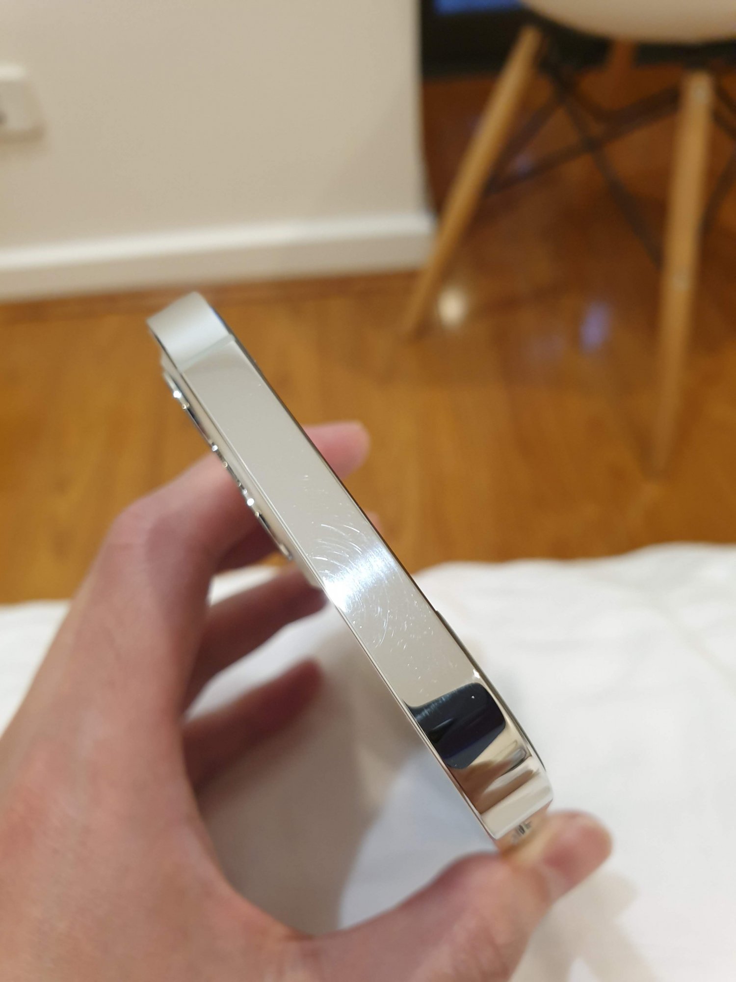

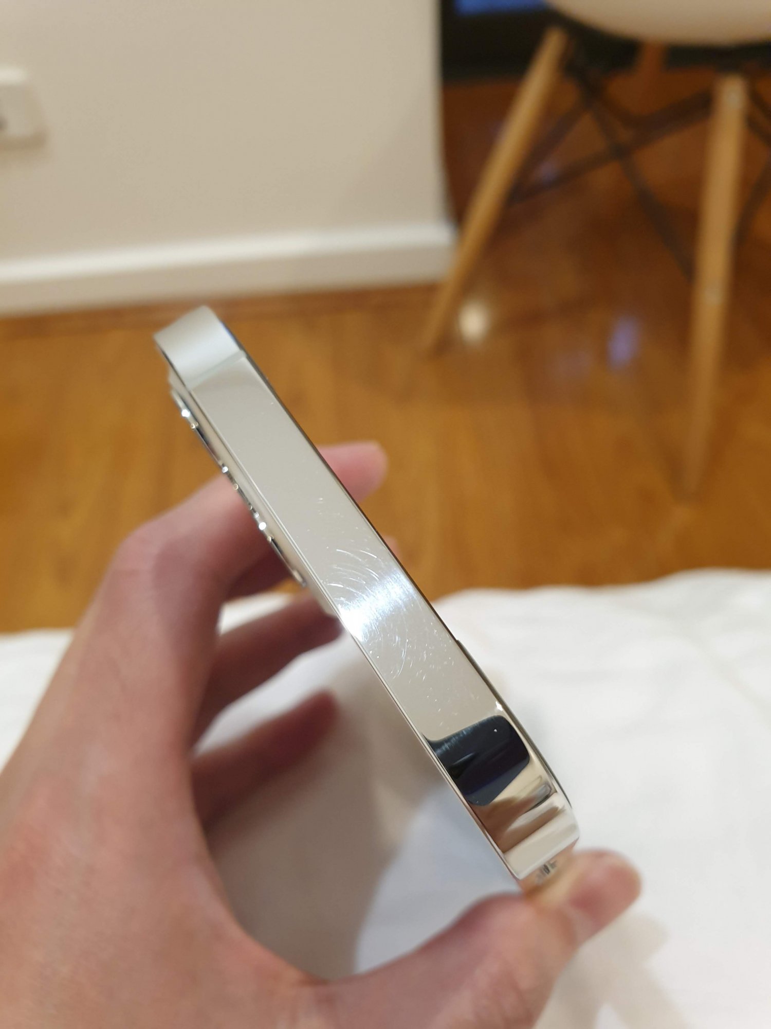

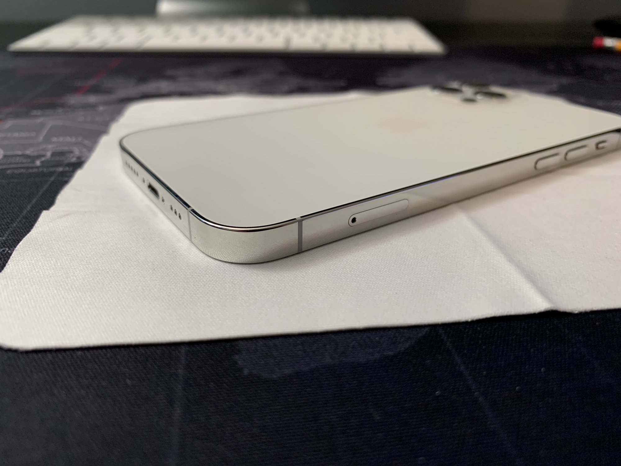

Hi there thanks for posting this. I recently tried to polish some scratches on my iPhone 12 Pro Silver using Autosol Metal Polish. However I seem to have created some swirl marks/scratches using the polish. I used a clean microfibre cloth and am using the Metal Polish variant (not sure if the stainless steel variant would prevent this?) any idea how I can fix the swirl marks? I’ve attached an image and a video. Maybe a bit hard to see as they only appear in direct light. Any help would be greatly appreciated!
A microfiber towel is too aggressive for polishing stainless steel in my experience. I would recommend having another go with a cotton pad as cotton seems to be soft enough for stainless steel.
Reactions: upandown
Thanks I tried this but seems to be leaving streaks on the metal based on the direction I’m polishing (whether it’s circular or straight line in one way) can’t seem to get the original finish where there are no visible lines/perfect mirror finish. Hope this makes sense. Is there a certain way I should be polishing?
Does your cotton pad look similar to mine? I find the fluffier cotton pads are actually harsher than the smoother, tightly packed pads. You could also be applying too much or too little pressure. The cotton pad should be folded in half or into fourths so you have a bit of padding for more even strokes.
Can you recommend a proper cotton pad to use?
Also I have Blue Magic Polish Cream, would that work or is Autosol better suited for this job?
I use generic cotton pads from the beauty section at Target.
I can’t say I’ve tried blue magic, but from what I read it seems to be a fine (vs. coarse) polish so it should work! If it doesn’t you can always follow it up with autosol or a cape cod pad.

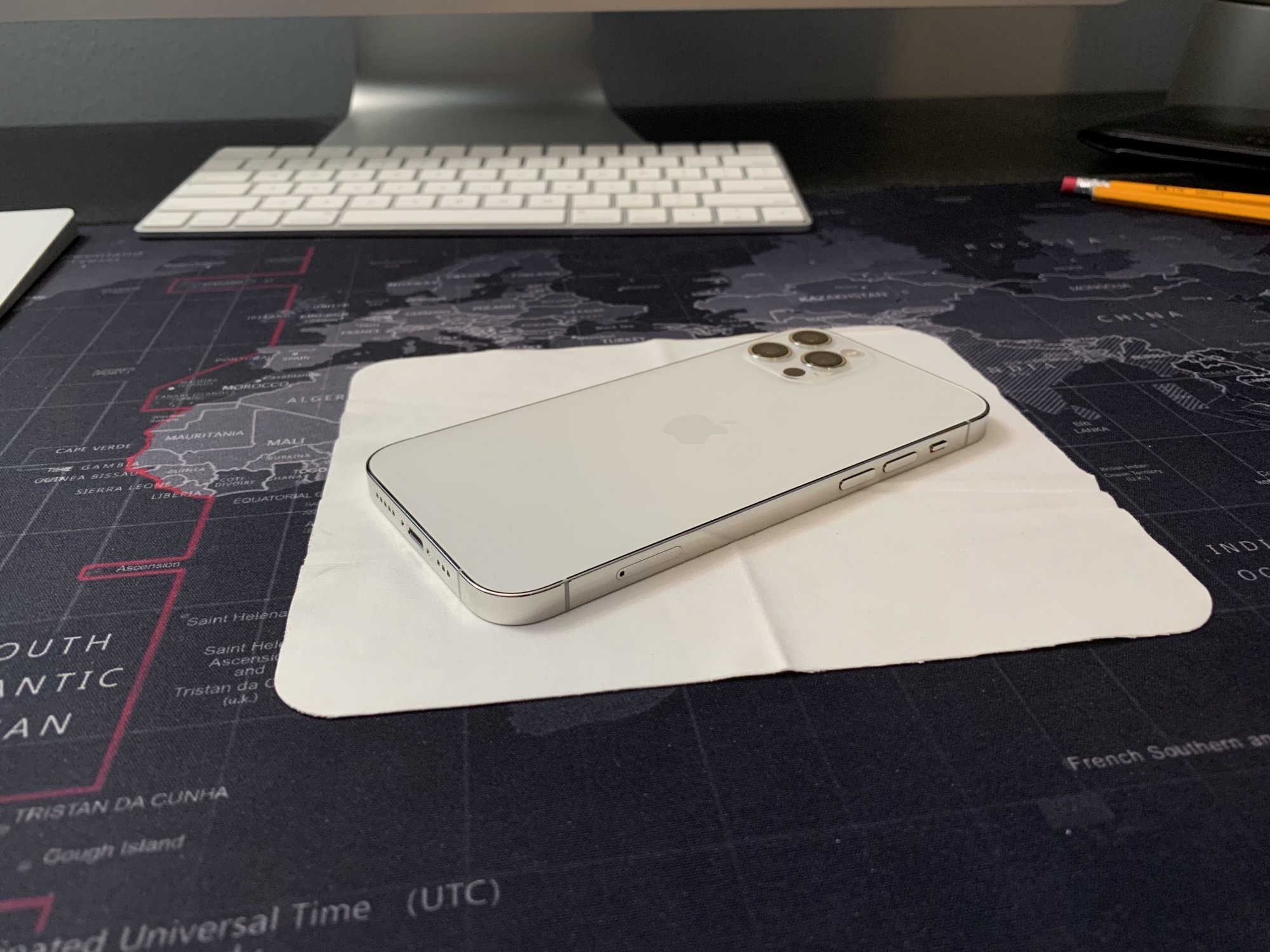

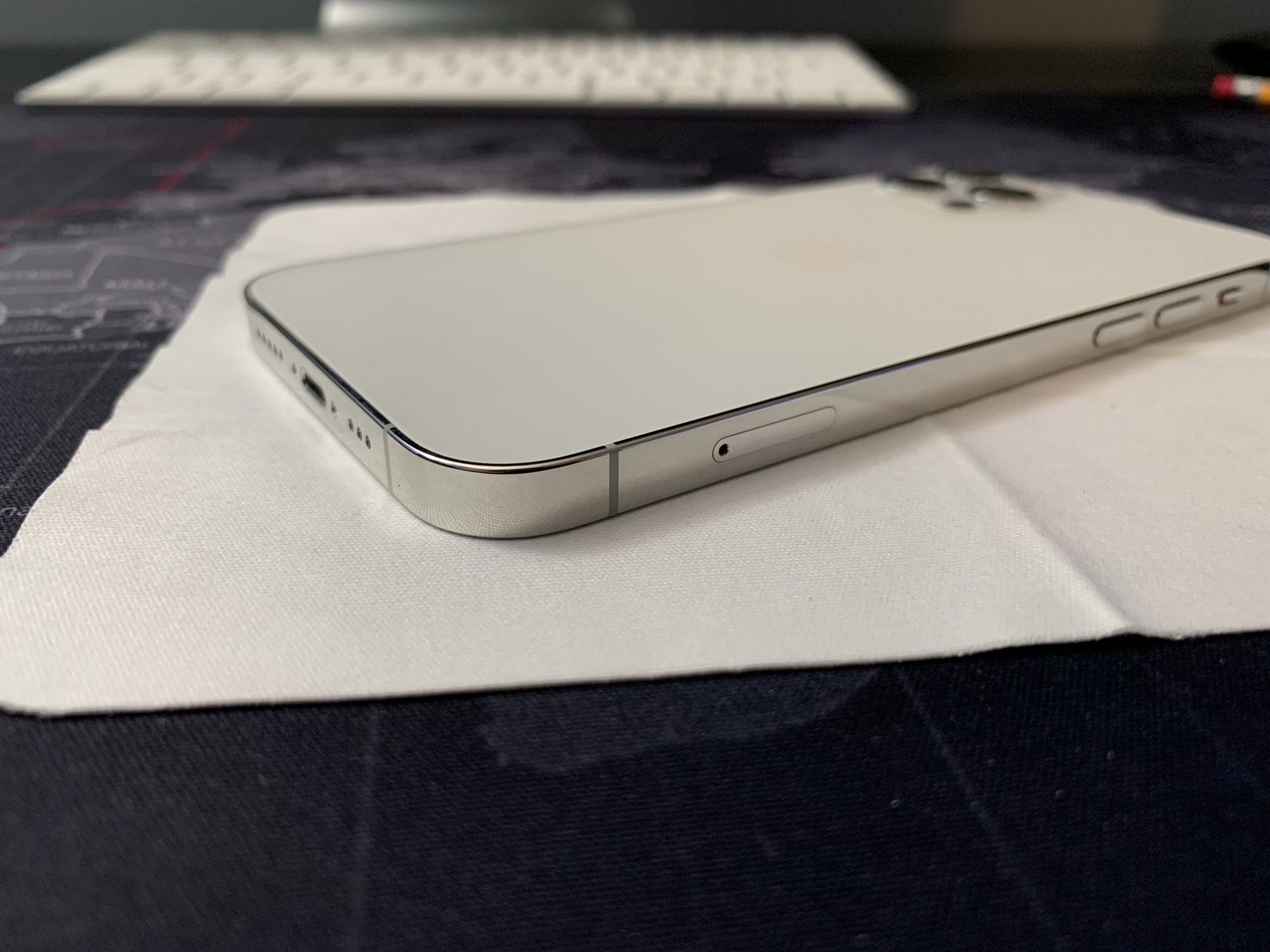

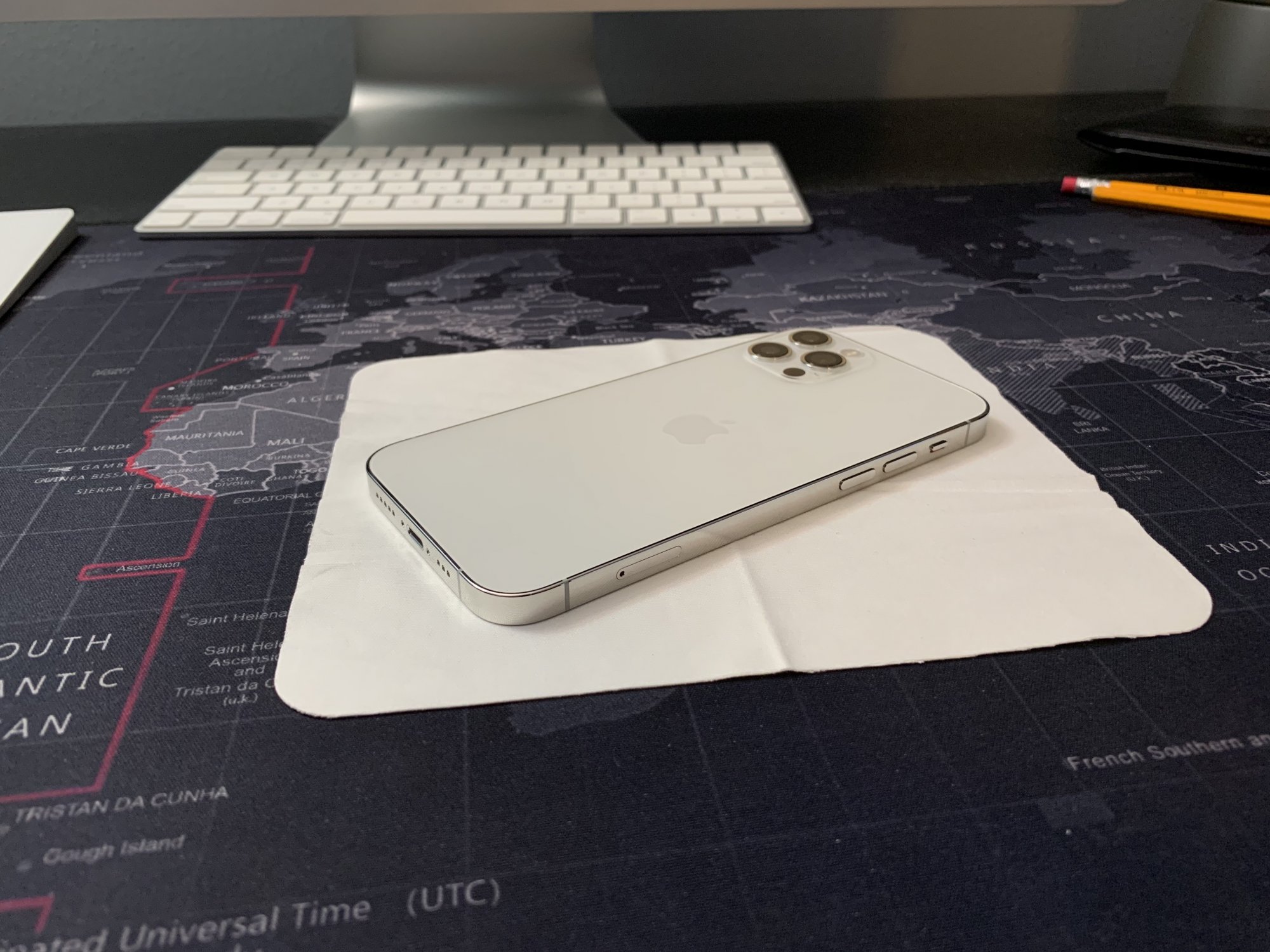

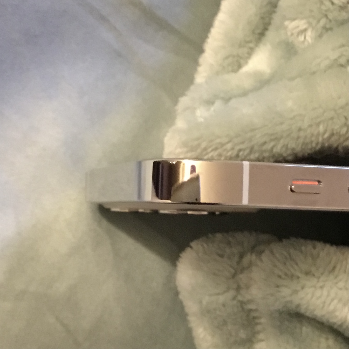

First thing I did when I got home was test it out! Used a white metal polish on a white cotton pad and gently rubbed the lower right corner of the phone. Stainless steel residue did in fact transfer onto the cotton pad, which means no PVD finish!
Only a small amount of transfer is on the pad but rest assured, I only went as much as needed to confirm because the phone is less than 12 hours old at this time so it doesn’t need a polish yet.
EDIT:
I’ve now had the honor of double confirming this.

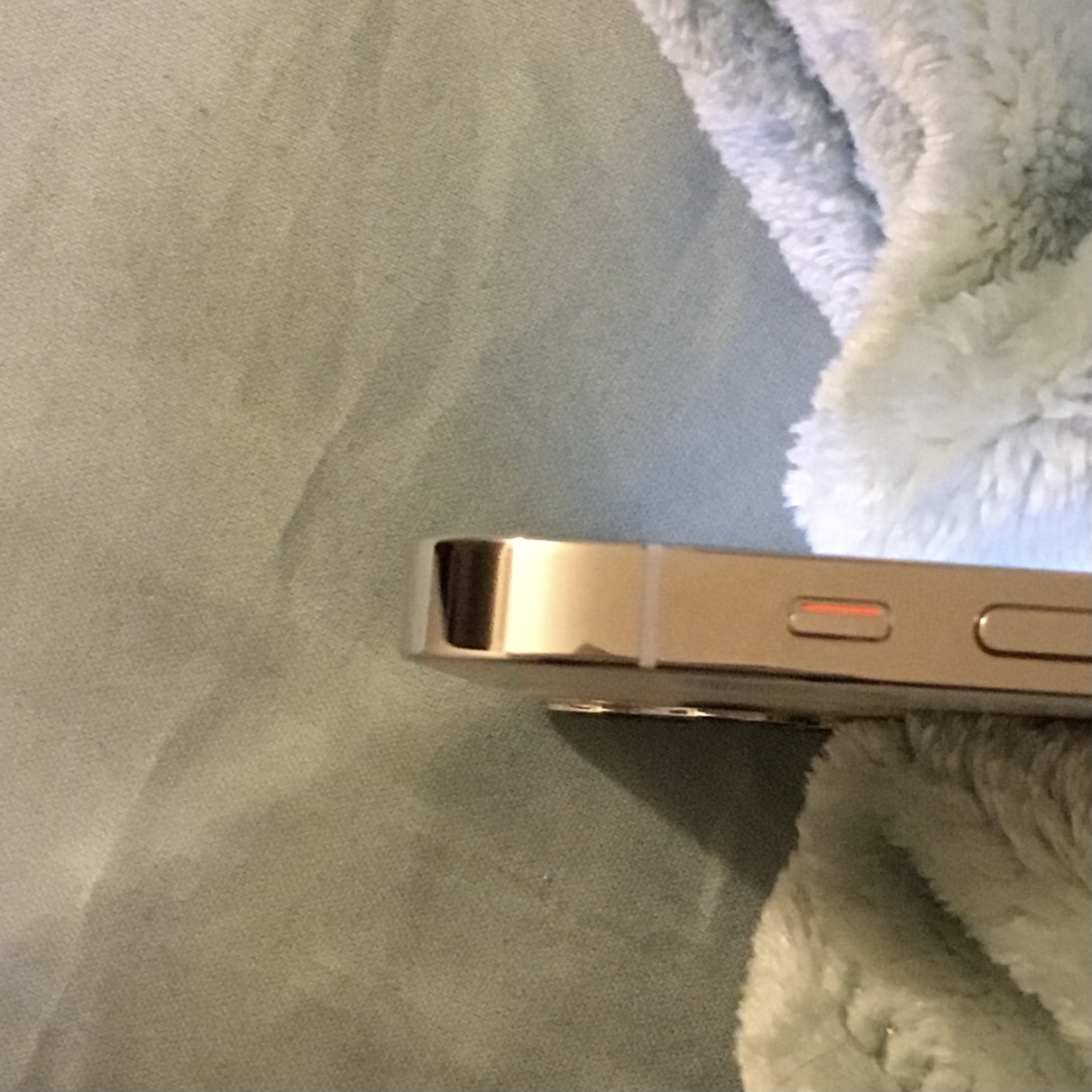

Today I was trimming my beard in the shower. Suddenly the water turns off and I’m covered in hair. I wasn’t about to get hair everywhere so I decided to wait for my complex’s water to come back on while browsing the web. Suddenly the water comes spitting out but it’s BROWN from who knows what, so my reaction was to jerk backwards. Dinged the upper right corner of my phone and get a little bummed out despite how minor it was.
Eventually I decided to sand and polish the corner already knowing it’s raw steel. Came out beautifully!
Small ding near the screen:
Sanded with 2,000 grit:
Perfect again!

How did you get on with the polishing, any improvement?
So I just tried the blue magic with a cotton ball on the 12 Pro. It didn’t really work out for me. I’m not sure why but I have streaks and it didn’t take out the marks.
What do you think brettka7?
If you see what appears to be streaks, that means it was too aggressive to polish out to the point that scratches are invisible to the naked eye. The main causes for this would be:
1. Polish too aggressive. From what I read, this should be a safe polish to use, but I have not tried it personally.
2. Too little or too much pressure. It’s more likely this would be caused by too much pressure. The cotton pad should be folded in half or fourths and you should not be pressing into the phone as much as you should be gently grazing the sides.
3. Cotton pad is worn out or torn up. If you are rubbing it over buttons or holes and the pad starts to fall apart, it should be discarded. Change in texture will result in a change in aggressiveness.
I usually do all four corners first, then do the lower sides, then bottom, replace the pad with a new one, polish the top, polish the upper right side, then upper left side. So I split the phone into 10 segments that I work on individually.
I also count out my strokes, partially because of boredom but partially because I want to keep it consistent. Assuming one stroke is forward-backward, I do about 200 strokes total to make sure the polish breaks down. The last 20 strikes, I lighten the pressure until it is just barely grazing the surface.
Thank you sir. I believe it was caused by too much pressure. I did one pass with way less pressure and although the scratches are still present I believe it’s getting better. I’m assuming it will take a few more times to even out the wear.
