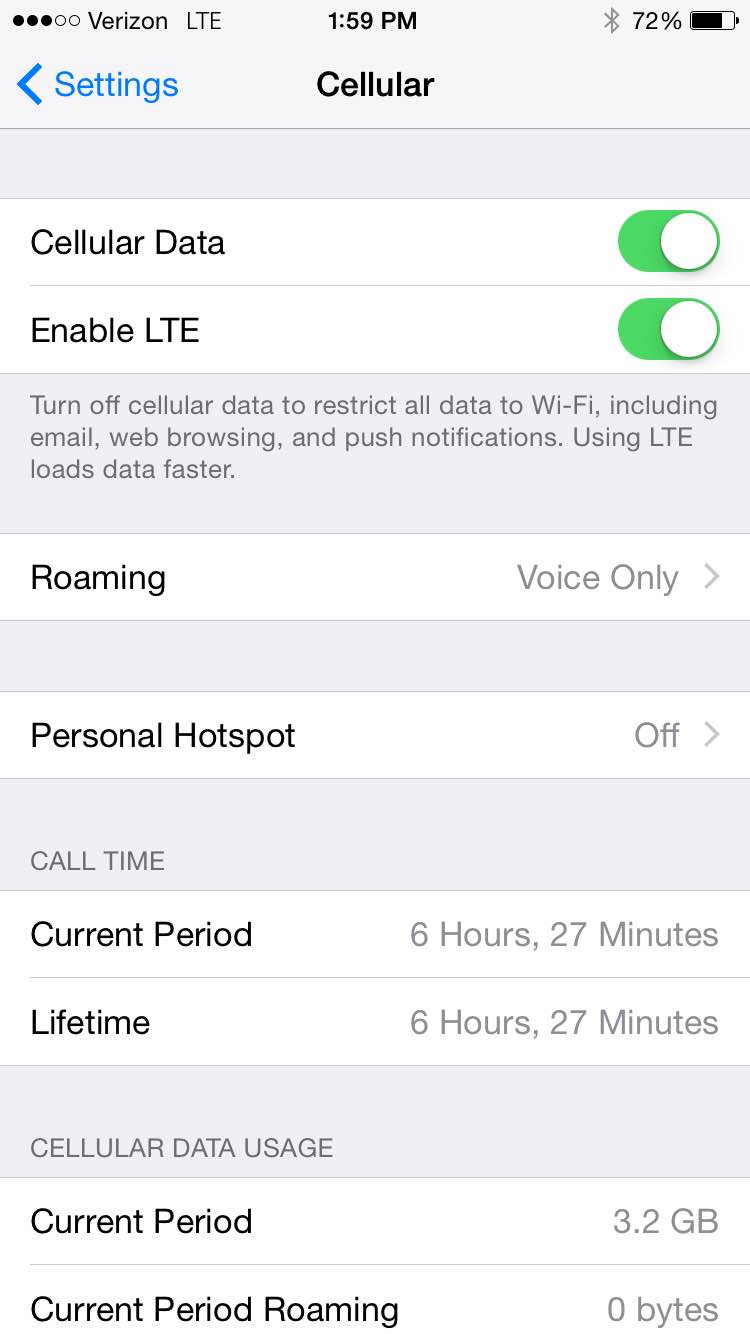

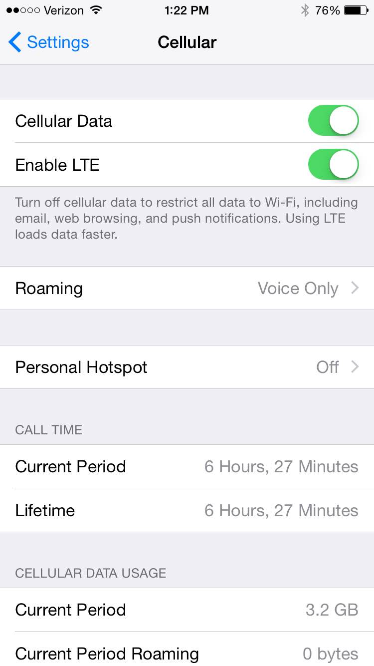

I think I am the only one that can't get this to work. The feature is enabled under My Verizon. It won't show up on my phone though. I've tried resetting every setting (including a clean wipe) and it still won't show. Anyone got an idea?
That looks like an iPhone 5S screenshot, and this only work on the 6 and 6+.
Under Enable LTE, where you have an on/off switch, I have the selection option:

When I went to add it on Verizon's site, it said it was already enabled. Probably because I selected Voice and Data on my phone first. This tells me logging into Verizon's site isn't needed to add the feature, you only need to enabled it on your iPhone 6.
