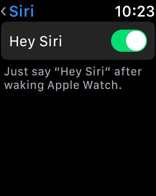

When I tap Settings > General > Siri, I don't get the options you are mentioning. Here is a screenshot. Why am I not getting the options? Also I don't see where I choose a voice for Siri. Please help.

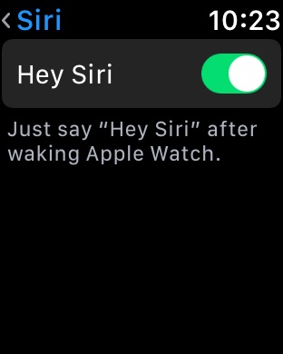

On the post you quoted, the bolded part - it needs to download Siri first. Make sure your iPhone and Apple Watch are paired and charging, while connected to your wifi. This should start the download process for your AW.
Ok other than making sure both phone and watch are on WiFi and the watch is on its charger, I don’t need to do anything else to have Siri download? I don’t need to somehow initiate the download ?
None, it does it automatically. Mine only took like an hour, not overnight; then the options showed up and my AW started to have voice feedback.

The phone and watch are on Wifi and the phone and watch are connected to each other via bluetooth. They both are also connected to chargers even though they both are already 100% charged. I'm just waiting to see the options appear. I've got my fingers crossed.
Take a break, it will show up eventually. Or like what Apple suggested, it will do it overnight.
I re-read your earlier post. So just to be clear that you have Siri setup first on your iPhone. The voice: Male or Femail and language: list are downloaded to to iPhone first and then downloaded to your watch. As reported earlier in the thread: if you switch voice / language Siri selection on your iPhone forces a download to be scheduled for you iPhone.

Yes last night I had completed all that you mentioned and ensured bluetooth and wifi setup was correct before going to bed. This morning the options were still not present; therefore, I called Apple technical support. The technician walked me through the same checkpoints as listed in this thread (great job forum contributors!) . The technician also had me check all settings on both watch and phone. We still could not get the options to show to allow Siri to talk. So, my Siri still isn't talking. A bug report was submitted and now I must wait, unless we can identify a resolution on this forum.
