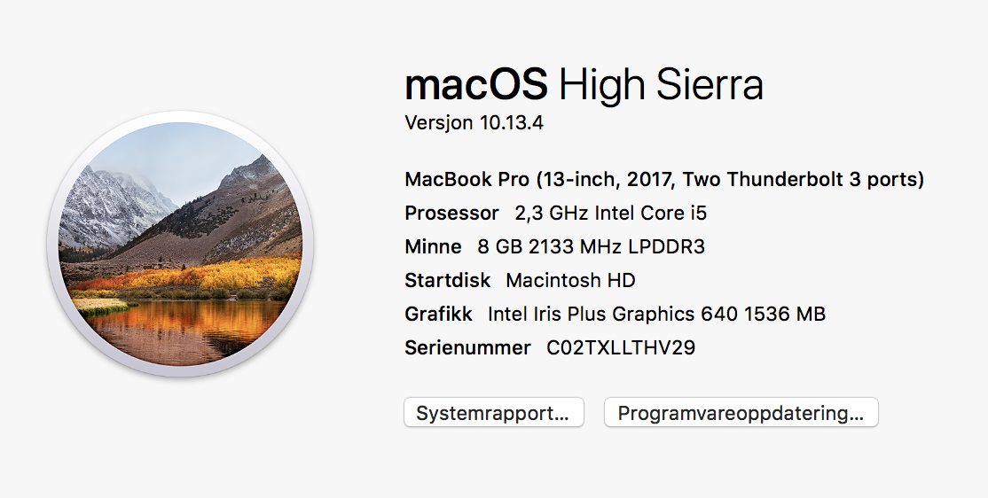

Hey people, I have had the same problem since 2014 with different MacBook Pros . This screenshot is my latest machine. info. I´think I have a virus or a spy program who's following my backups thru the library IPHOTO(iCloud) or Google picks. I have deleted an reinstalled my last 3 devices and it keeps coming back. I also have some other symptoms of being hacked. I use VPN, virus scans, different security programs, but no solutions...What To do ?
