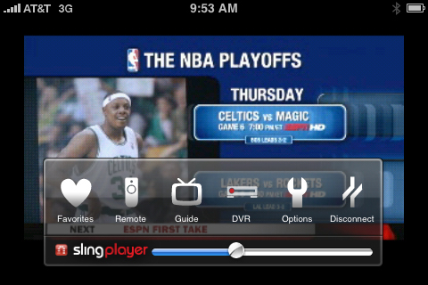

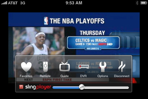

Ok, the question that everyone wants answered:
If you use voipover3g, can you add slingplayer to the list of programs that are fooled into thinking it is on wifi when it's really on 3g?
Who will be the first to answer? 😀
Fine, I'll do it myself.
Yes, it works.
Hooray!
Hell yeah 😀
The SlingPlayer now works perfect with 3G.
Take that AT&T 😀
lol

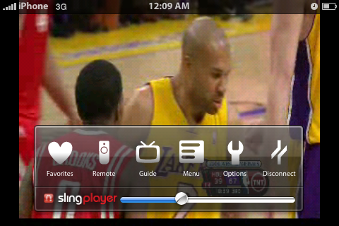

Actually I cant tell the difference between Wifi and 3G slinging, they both look clear. Its not like youtube that looks grainy on 3G.
This hack alone is worth jailbreaking if you got a slingbox.
Big thanks to patrickvanzandt for the instructions on this.

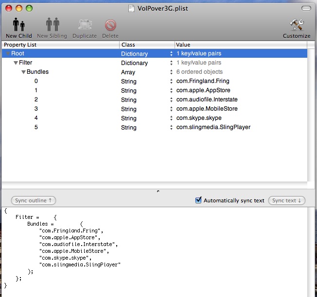

Can someone please post step by step on how the use VOIPover3g on a Mac? The are no instructions in the app. Thanks in advance!
You gotta jailbreak your phone and install cydia.
Then search in cydia for Voipover3G.
Install that. Then SSH into your phones file system and follow the directions above posted on the link.

I have VOIPover3g installed already and I can see my iPhone in Finder. Do I go to Home or Mobile inside iPhone?
Ok...I've followed the instructions, but I still get the "needs wi-fi" pop up.
- I jailbroke my iPhone 3G 2.21
- installed voipover3g
- added the com.slingmedia.SlingPlayer string to voipover3g.plist

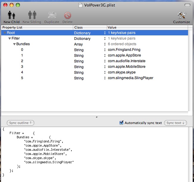

I read this in another post...will try when I get home but could explain the problems everyone is having
My issue was with 2.2.1 - if you are running 2.2 or greater, you must install "Backward Compatibility" for mobile substrate layer before installing VOIPOVER3G. If you forget, just uninstall, then reinstall after. (remember to re-mod your .plist if you uninstall/reinstall).
Go all the way to the root where you're not into any folder.
And from there navigate to:
/Library/MobileSubstrate/DynamicLibraries/VoIPover3G.plist
