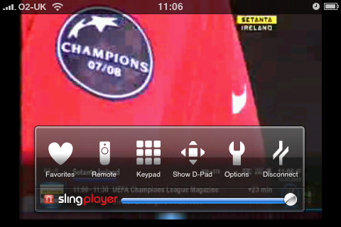

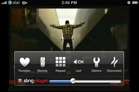

Here's a picture of mine.

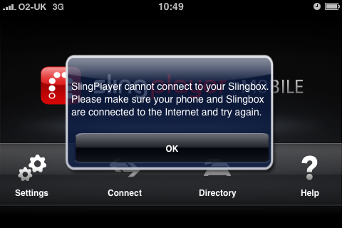

Im still having the same problem, it says connecting then this message pops up " SlingPlayer cannot connect to your Slingbox. Please make sure your phone and Slingbox are connected to the Internet and try again." (which both are true) and when i switch to wifi it works just fine...why is this?

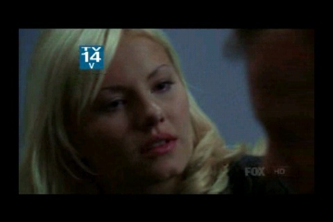

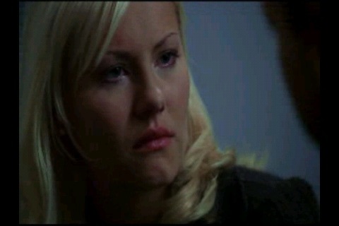

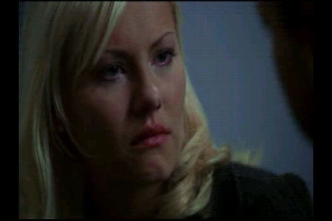

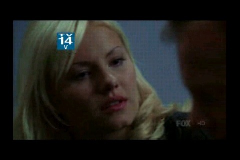

now if i can only figure out how to get the stream's display ratio closer to ideal (see attached pics). it either has the correct ratio 16:9 with black bars on BOTH the top and bottom, or it's stretched vertically.
i have the newest slingbox pro HD hooked up via component.
Do you read? Check my earlier post if you want this thing to work over 3g...this is for voipover3g
Here, I'll make it even easier....
My issue was with 2.2.1 - if you are running 2.2 or greater, you must install "Backward Compatibility" for mobile substrate layer before installing VOIPOVER3G. If you forget, just uninstall, then reinstall after. (remember to re-mod your .plist if you uninstall/reinstall).
Yes I just did that as well and still the same message pops up saying it cant connect
Make sure that you also have the latest firmware for your slingbox AND that you have setup your slingbox and router for internet viewing. The slingbox needs a dedicated port (mine was 5001) to communicate with devices outside of your network that are not PC/Mac based.
After I updated my slingbox firmware and opened a port I could start using the 3g connection with the Iphone slingplayer.
Hope this helps!
-Alex-
Hope this helps!
-Alex-
Alex, thank you so much thats what it was...for some reason i had to reset the slingbox's internet streaming, now it works fine over 3G, this is awsome! thanks again =)
I believe the iPhone's screen isn't 16:9... hence, you'll have black bars with media.

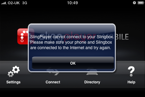

I can still not get mine to work over 3g!
My slingbox is at my girlfriends house, I can access it from my wifi at my house so i no the ports are correctly configured.
I have just tried this but I only tried it with thr tricker tree app I uninstalled it, then I installed Backward Compatibillity then tricker tree app.
" you must install "Backward Compatibility" for mobile substrate layer before installing VOIPOVER3G. If you forget, just uninstall, then reinstall after"
Any other tips???

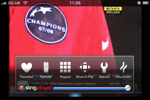

Any other tips???
I completely uninstalled Voip3G then installed Tricker 3G. I had no need for the other program as Tricker takes care of Slingplayer and Skype, and that's all I needed. Didn't want to mess with the SSH hacking, etc.
Just wait until Sling comes out with their update. Per my contact at Sling Media, this is a known bug (video squeeze). They intended to use the whole screen and will do so. This may be one limitation of the old Slingbox hardware (Classic, AV) in that they may not be able to fix this for those using that platform. Pro HD and Solo users should be fine.
