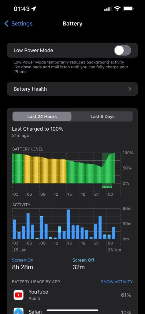

Been noticing slow charging speed on my 13 PM. It takes about two hours to go from 55% to 100%. The initial period, the iPhone didn’t “race” to 80%. It seems like it was trickle charging all the way. Below is the image of the graph. Anyone knows what I should do? I’m already using the Apple 20W power brick.

I see. I noticed different behaviour when I had my 13 some months ago. It speeds through 80% and then slowly charged to 100%.
Reactions: max2
80 to 100 takes a while as the running theory is charging quick to 100 diminished battery life.
Agreed with only charging to ~80% (probably why there is a setting for it). There is automatically reduced current (which I believe you refer to as ‘running theory) and from what I recall it is less successful in placing the electrons in the right “spot”.

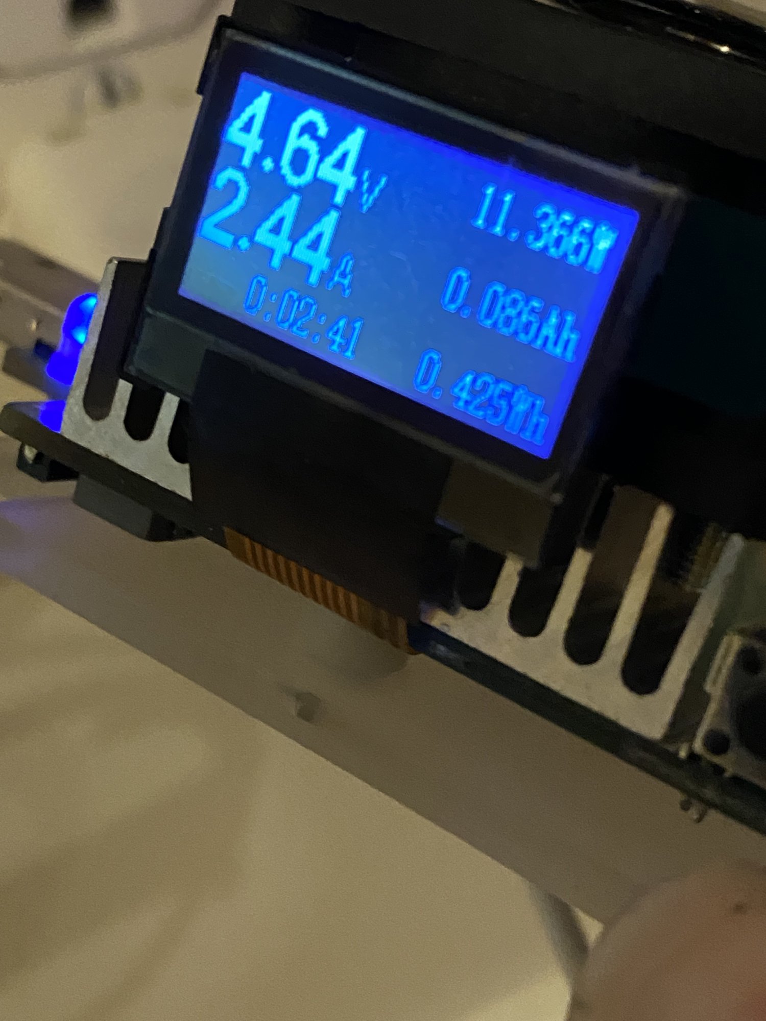

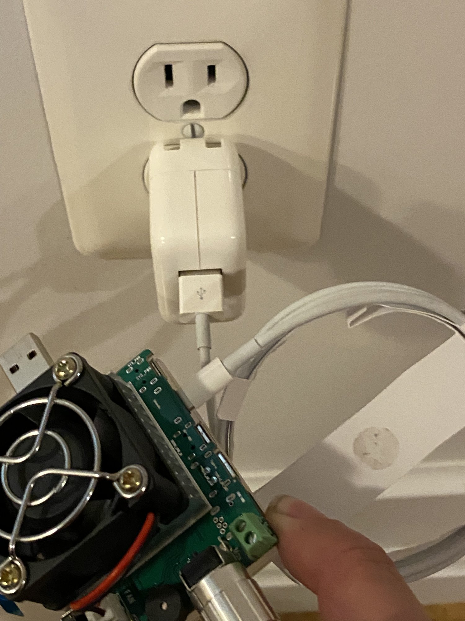

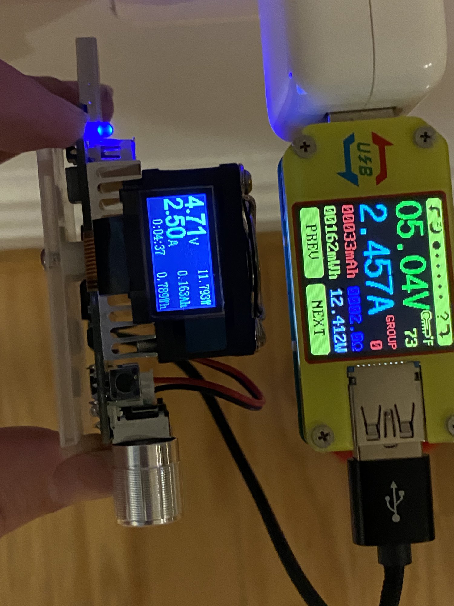

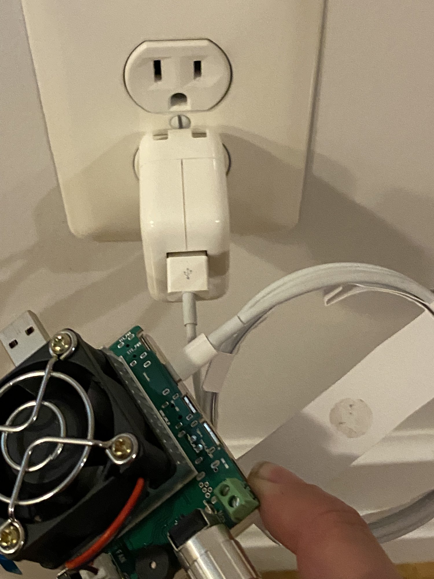

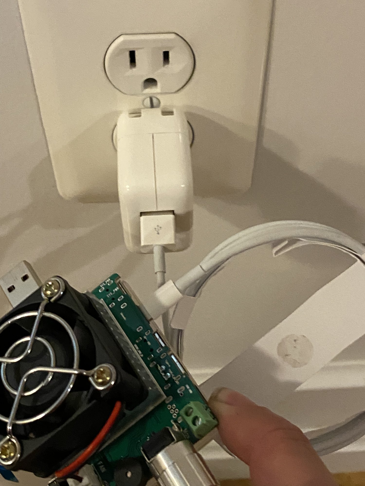

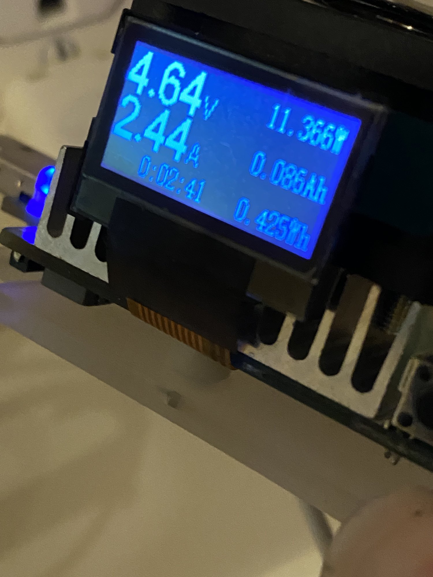

Slow charging is generally a result of a poor condition or cheap cable. Like mentioned it could be the pins on the connector, always look at them before you plug a phone into them. If you see a burned/black pin discard the cable. Also like mentioned the last 20% will intentionally charge slow to reduce the strain on the battery which is because as a battery is charged and its voltage increases its internal resistance increases if a high current is maintained it makes heat. And since the battery is the resistance it would be heat in the battery.
For example this is a 12 watt iPad charger connected to a USB load simulator via a brand new Apple cable.
Just to get it close to 12watt I needed to increase the load (thus current) to the point the voltage was dropping (due to the resistance of the cable) passed the safe 5volt +/-5% that a LiPo charging circuit would keep it. And thats a brand new brand name cable. Using a 10 foot long knock off cable from the local gas station....your not doing yourself any favors.

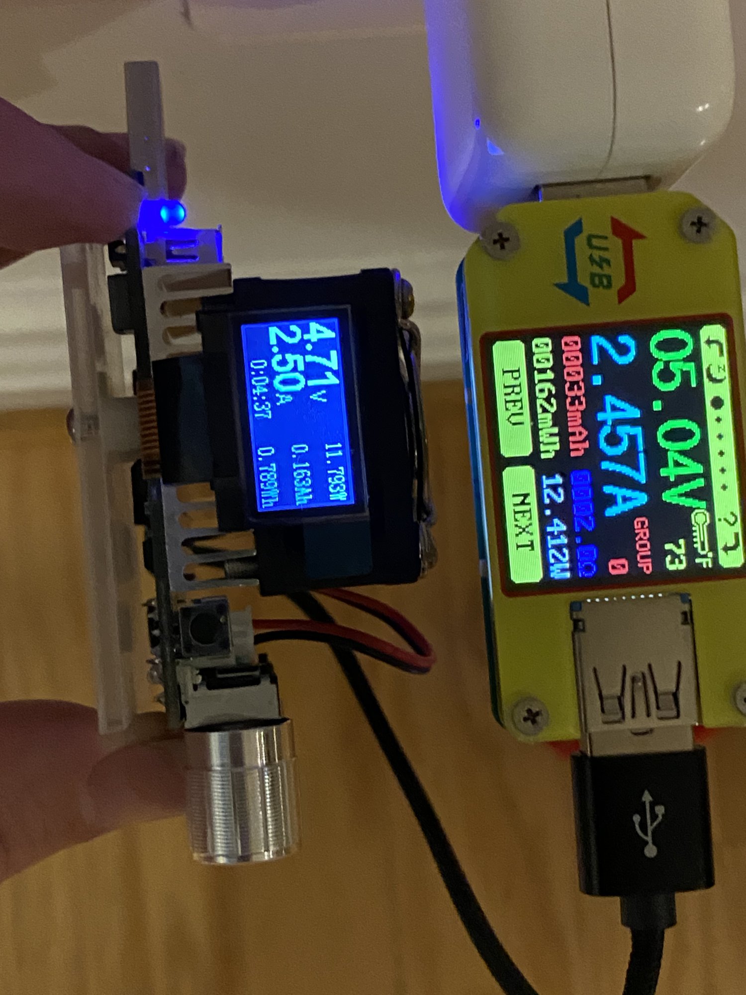

Here is a 6" cable. It gets a lot closer but using a USB tester plus the load simulator lets you see of the voltage, current and wattage drop through the cable.
So yeah, if your phone is charging slow and the cable looks like crap then toss it.
View attachment 2025913View attachment 2025912
