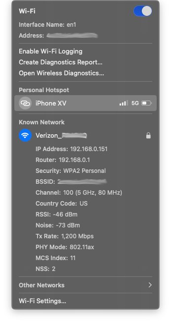

My M1 Mac mini is in the same room as my Wifi router, distance is 2m (that's like 6.5ft in the weird units).
My router is set up with different SSIDs for 2.4GHz and 5GHz and supports 802.11ax, the mini is always connected to 5GHz.
Sometimes the Mac gets the expected 1200Mbps link, sometimes it will just stay at 300Mbps, seemingly without reason, and will just stay there.
I'll get an Ethernet cable set up soon anyhow, but wanted to ask whether anybody knows how to fix this in the meantime as the low speed can be a bit annoying.
Digging deeper it's stuck at MCS Index 15 which is 802.11n, with 2 streams that gives me the 300. Which is inconsistent with the Phy Mode listed as 802.11ax. And it doesn't explain why I can't consistently get a 1200Mbps link, not even from so close to the router.

For now I tried changing the wifi channel. If that doesn't help I'll try this. Ethernet is coming soon, I just need another switch.
My M2 Mac Mini's wifi speed is highly erratic (in the same room as my router; speed fluctuates between 866Mbps and <100Mbps). I "solved" this problem by using ethernet, but in my case, at least, the problem seems to be interference from neighboring wifi networks.
Edit: I posted about it here
My Mac mini is ~3m from my router, also a telecom provided access point — which equates to limited adjustments/tuning. Furthermore, maybe relevant, my Mac mini is vertically standing.
I counted 37 other networks (in range) — I live in an apartment building.
The link speed is seemingly accurate, according to this table:
