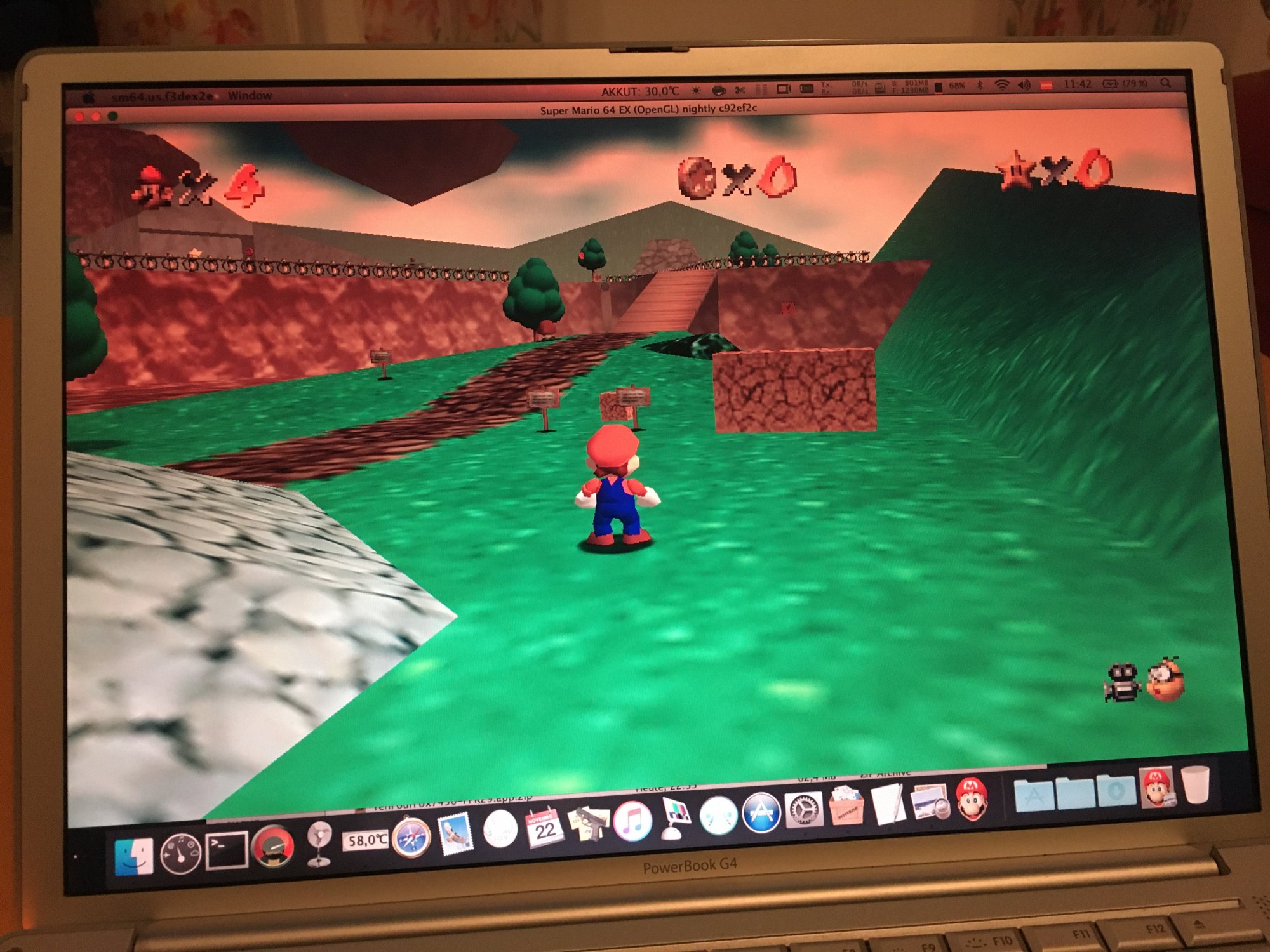

I just wanted to say thanks again to alex_free! The port works great on my PowerBook G4 DLSD. Initially I wanted to try it on my TiBook but I somehow overlooked that SM64PPC requires Leopard (which I don't have on my TiBook). I've only played 15 minutes so far. Everything works great and performance is great 👍 BTW: Are there other old-school Nintendo games out there that can be compiled for Mac? Also I'm wondering is this based on a reverse-engineered code or a leak?

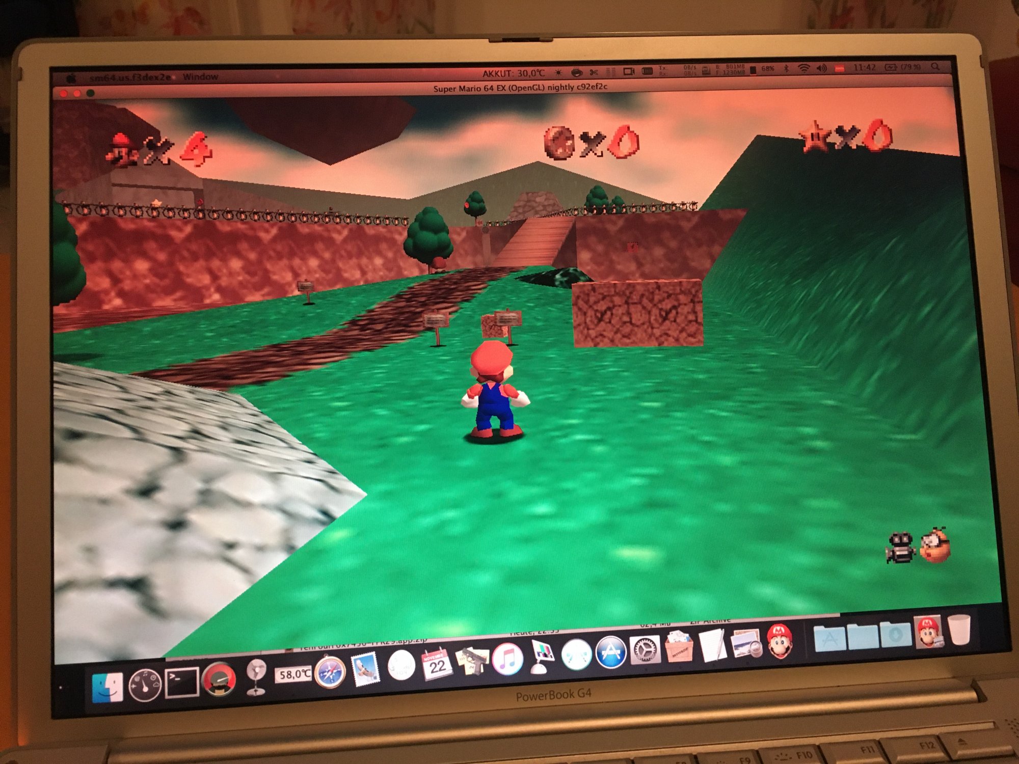

Your welcome, Tiger is possible and I’ve even beaten the game on Tiger, but a release isn’t out yet due to some small issues I’d like to correct or look at more.
This is a first of its kind port, very exciting times. The ROM itself was decompiled into MIPS assembly and then matching C code was written.
After that, it was taken a step further by adding modern OS support on top. So reverse engineering + custom programming to make it work on computers. You can compile the original decomp for the N64, and generate an exact byte by byte ROM.
Their are actually quite a few decomp projects that have gotten to the “write matching c code” phase, but nothing yet besides SM64 has a port out. There’s a 007 Goldeneye N64 decomp, Perfect Dark N64 decomp, and many others I’m watching the development of.

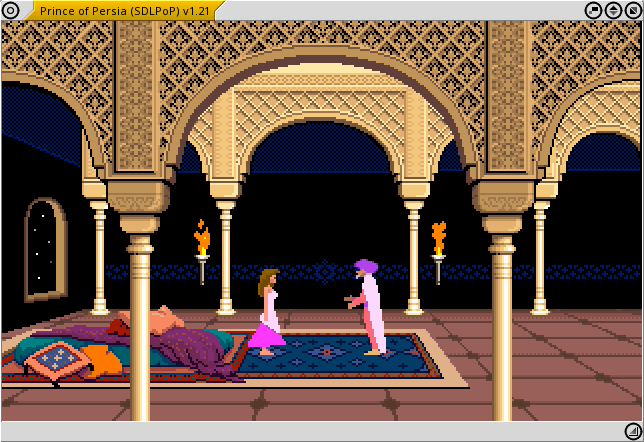

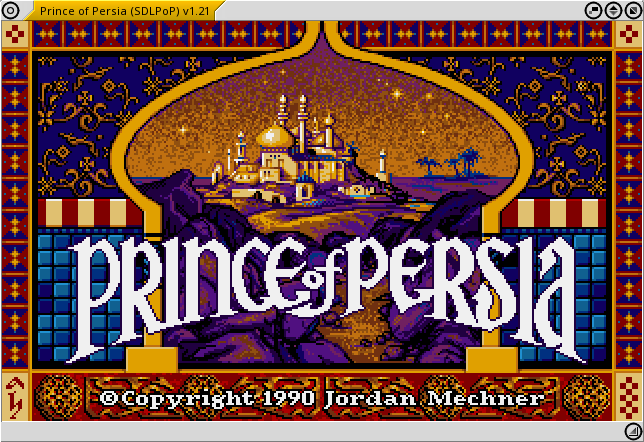

@alex_free : Have any interest in this prince of persia port? Already works on 10.9. Maybe you can work your magic on it. https://github.com/NagyD/SDLPop
So the official project is broken on Mac OS X 10.4, but I managed to find THIS which is basically everything that needed to be fixed fixed! The author of the previously mentioned forked has done it for Tiger, but now that 10.3.9 is a possibility with Panther_SDL2 I'm gonna attempt that so I still have something to do regarding this.
