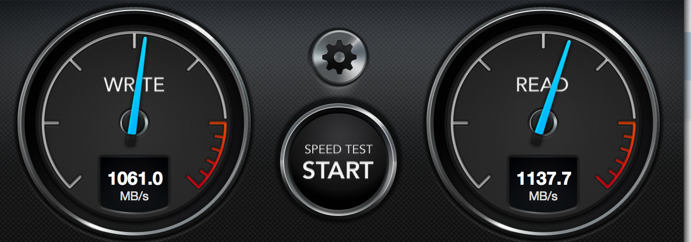

I have a Predator X as replacement for my dead SM951 (which now does 100MB/s read and 5MB/s write...) - 512GB.
Slot 2 via Amfeltec adapter, seems as good as it gets - note this system is FileVault enabled which can reduce speeds.
Slower than the SM951 for sure.
