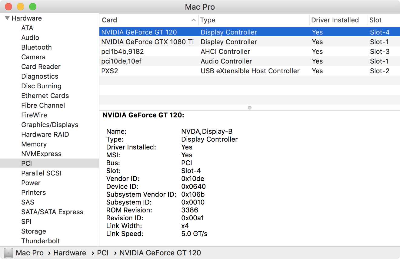

I had no trouble using the Apple version of the GT120. It works fine even as the primary card, just not much for performance.

GT120 is one of the simplest / safest solution (especially if you prefer to have your boot screen via display port), but not that cheap (if compare to it's performance).

The GT 120 is single-height, powered off the PCIe slot, and works well if you just need a boot screen (or older MacOS compatibility). I bought one for my Mac Pro for the same reason.

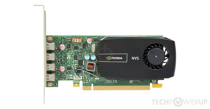

The 2GB NVS-510 with 4 mdp ports is probably the smallest. Drivers are built into High Sierra and it should be Mojave friendly.
Just looking for a Metal supporting card for my 5,1 Does this 510 support that? Also, you mentioned Drivers built in, thought this needed flashing to get away from web drivers?
