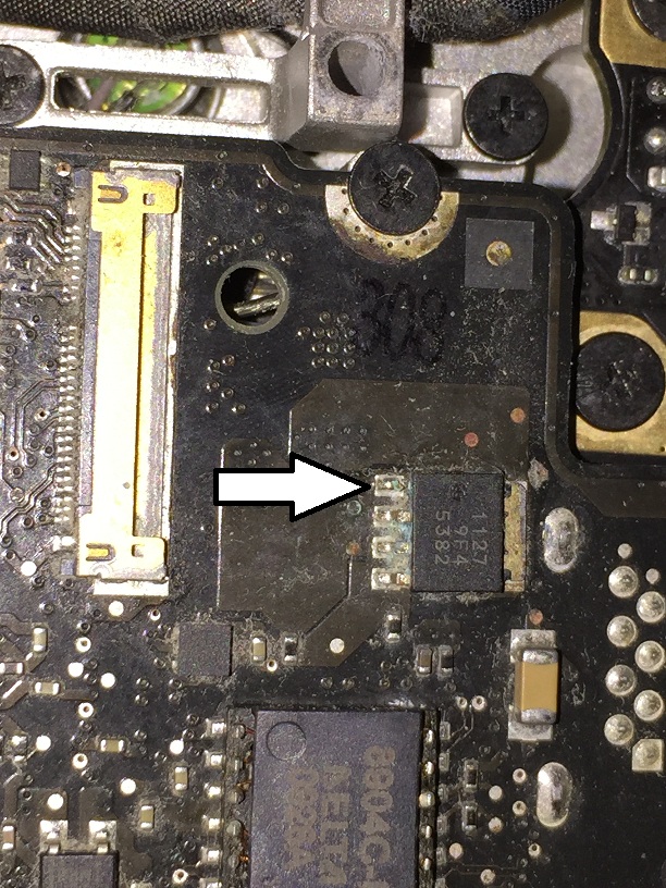

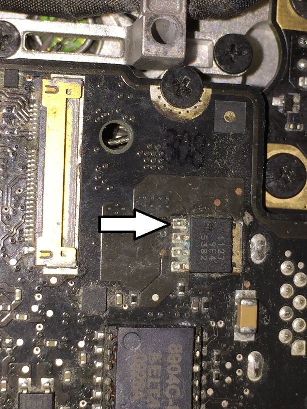

Hi!
I have the same problem with a 2011 Macbook Air. My one had water damage and the charger IC (and the pads around it) was very badly corroded. Also I found two FETs what were short. Second U7000, new FETs from a donor board and still have no 12V. With battery everything is fine until the battery dies.
I've started from the first part of this thread and doing some of the prelim testing.
Have 3.4V at G3Hot rail, have just under 18V at the right side of the small mosfet or whatever the component is located close to the upper right by the DC-in board. It has 4 legs on the inboard side and one solid pad on the side facing the edge of the computer. I've taken a picture shown below.
The one thing I noticed is that the top most leg (would be closest to the back of the MBP) looks to be broken. Would this cause some issues?
