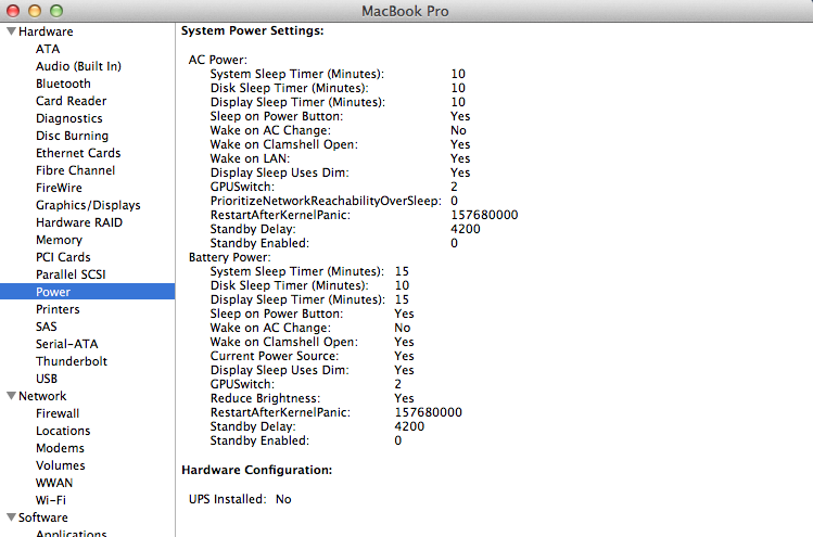

I am experiencing a very similar issue. It looks like the battery indicator lights are functioning correctly and display 5-6 lights. If it displays 5, the 6th slowly flashes (like it would when typically charging). Computer will not start without MagSafe plugged in.
Many threads have recommended to disconnect the Battery Indicator lights to see if they are the root of the issue. I tried this and it made no difference. To check that these lights are functioning correctly, I disconnected the battery and pressed the Battery Indicatory lights. They all flashed as they should when not connected to a battery.
I have tried a SMC reset to no avail. PRAM reset to no avail.
The MagSafe light is green most of the time when plugged in. It has been amber at certain points after being disconnected for more than a few minutes, leading me to believe that it is charging the battery.
Any thoughts or suggestions would be greatly appreciated.
What is showing in your System Information/Power tab?
There's a lot of information there about the health of your battery, such as the full charge capacity, number of charge cycles, voltage provided by the battery, etc.
There's no device or health information about the battery --- really strange!
How old is your MBPro?
You said that you disconnected the battery... Did you re-connect the battery before viewing your System Information?

Weird indeed! It is a mid-2011 MBPro. It has been out of commission for a couple of years, until I purchased a new HDD and installed. Replaced old thermal paste due to ongoing GPU issues (praise the 2011 GPU issues with the MBPro). Runs well enough now, but I cannot install newer OS because it "is not connected to a power source", even though the MagSafe is plugged in.
The battery was connected when I viewed the system information.
I am running OS X 10.7 currently, so Coconut Battery is out. Downloaded the knock-off Battery Health and it looks like everything is at 0's and unknowns.

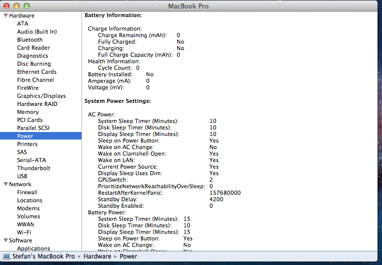

Is there any difference in System Information/Power tab, battery connected, or disconnected?
My concern is that it SHOULD show something about the battery, even if would just be blank data.
Your screen shot doesn't even show that there is any provision, or possible connection for a hardware battery, other than a UPS, similar to what a desktop Mac would show.
The OTHER hardware that does not show is the magsafe adapter hardware. Not even mentioned on that hardware tab.
That's maybe why I would suspect that the DC-in board might fix that, as it might be a blown device, similar to a fuse, on that DC-in board.
It looks exactly the same with the battery disconnected as it did when connected. I will give replacing the DC-in board a go and let you know how it goes.

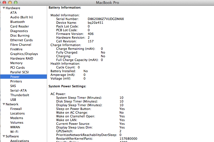

So, I just replaced the DC-in board and same deal. It is not detecting the battery or the MagSafe. Any thoughts?
*UPDATE* So after disconnecting and reconnecting the MagSafe while the battery was plugged in, I got it to display both the battery and the MagSafe. Below are the screenshots. Does this lend any insight?

I will assume that the magsafe adapter is working OK. Now you have replaced the magsafe board, and you got the logic board to recognize both the battery, and the power adapter.
There is some data missing, such as Cycle Count.
So -- leave the battery connected, along with the magsafe adapter. Do BOTH an SMC reset, then an NVRAM reset. Hold the 4 NVRAM reset keys (Option, Command, P and R) while rebooting, until you hear the boot chime sound 3 times, then release the keys. Check in your System Information that the battery and magsafe adapter are still both showing in that Power tab. Shut your MBPro off using the normal Shut Down through the Apple menu. Leave it OFF and plugged in to power for 24 hours.
After that 24 hours, do you get ANY charge on the battery, and (important, I think) is there ANY number other than zero showing for Cycle Count on the battery? If so, what is showing, and what is the amount for Full Charge Capacity?
If you have a number there, is the battery fully charged to that amount (more or less)?
Hopefully you have a charge now. If everything is still zero, then most likely your battery simply sat too long without charging, and "all hope is gone" -- you need to replace the battery now.
