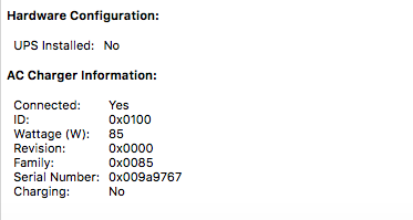

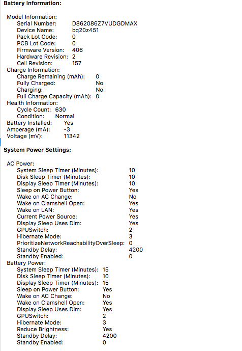

Alrighty. So I left the MagSafe plugged in overnight and the battery shows some information within the System Information tab. See attached images. However, this again is only possible if I disconnect and reconnect the battery to the logic board while the laptop is on. Could this mean a faulty/shorted connection cable running from the battery to the logic board? The piece of unplugging and plugging has me confused. It may be worth noting that after the unplug/plug process, the light on the MagSafe turned orange, even though the battery status said "Not Charging". Upon unplugging the MagSafe, the laptop died fairly quickly.
Keep in mind that the magsafe LED has 3 colors. Green (power, no charging), Amber/orange (charging), and Red (a hardware error of some kind, often a fault in the battery) The red LED is not often seen, and ONLY appears when there is an actual hardware problem. You may be seeing orange, when the LED is actually red.
I would expect that you need to try a known-good battery - which you haven't tried yet, correct?
That's correct. I have not tried yet. It looks to be amber/orange.
Any thoughts on the disconnecting/connecting piece? I find it odd that the MBP only detects the battery and MagSafe AFTER doing so.
