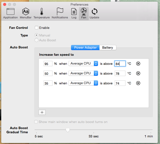

These are my settings if anyone was wondering. seem to work great. i am sure i could tweak a little more with some more rules thou...

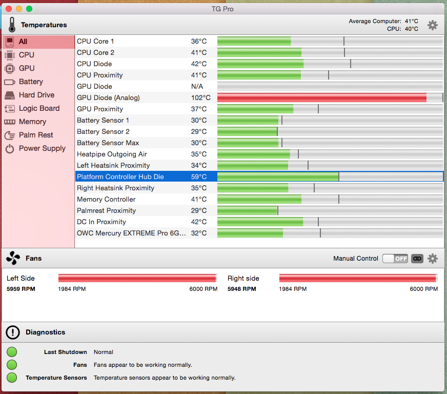

So i turned on my Mac this morning and bam... my "GPU Diode (Analog)" is running over 100C! this has never happened. been using this app for a while now too... i have turned off, let cool, etc. 1 min after turning on mac its super hot? It was not doing this last night and no changes were made...
see below:
That reading is just incorrect. Your dGPU isn't even active.
You never really have to worry about GPU heat anyway. Since its TDP is lower than the CPU, the latter always reaches its 100C temp limit first, which means the systems runs at full fan speed or throttles before the GPU goes beyond 90C.
What you see is just an incorrect reading when the dGPU is inactive.

Ok that is what i thought, it may be correct. do i have a bad sensor or something? It happens randomly, it is happening now again for the 2nd time. my issue is that now using TG Pro or another app if its showing its this high my fans will always be running full blast. but if i disable it, and it gets too hot and they dont kick in i am screwed. what shoould i do
Its just very weird to me that sometimes its red and over 110 and other times in in the 40's lol very confused.
The biggest issue is that you can not use the setting to set fan speed to specific speed when any temp gets over a specific temp now b/c this one is always over 110 randomly. my fans have been running full blast the last 10 min, so i quit app.
what are your guys temps for this? I dunno the dif between the GPU Diode and GPU Diode (Analog)
ok so i reset my mac and it ran full blast for 20 min or so, just the desktop, i was doing nothing and the gpu analog thing was around 100C. so i got bored and opened a website and boom, slows down and immediately goes down to 43 and stays there, then open this site in def tab and again boom, fans and over 100C again... i also noticed that when it slowed down the GPU Diode that always said N/A turned green and went up to around 44C. and then open a dif site/app and goes back to NA... what the hell.
here is what it looks like 20 sec after my Mac is turned on (just sitting idol and doing nothing):
-- Notice the "GPU Diode" is N/A and the "GPU Diode (Analog)" is hot.

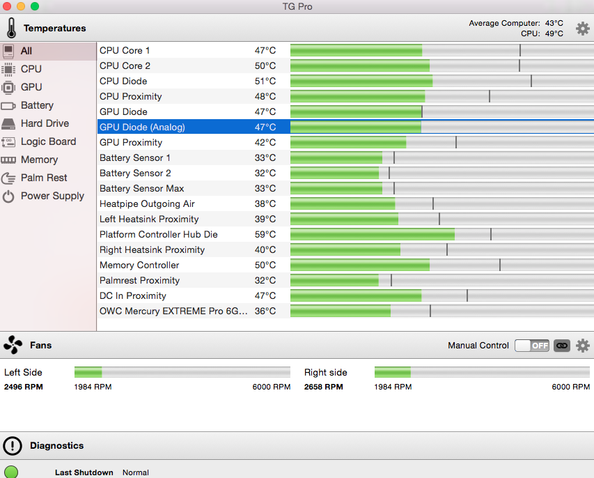

Now here is what it looks like when i opened firefox and went to a website (www.tomshardware.com):
-- Now notice that "GPU Diode" went from N/A to 47C & now is active & the "GPU Diode (Anaolg)" is no longer super hot and red.
CPU Diode does not read out when the dGPU is inactive.
When it says anything other than N/A it means you have the dGPU active.
The analog sensor near the dGPU is just confused for some reason when the iGPU is active. It is really nothing to worry about.

Interesting. My problem is that the analog one is always at either around 43 or around 100-110. So I am not able to use the setting for if any temp excesses a specific temp. And I can't set it at over 115C. Don't want my cpu to ever get that hot before the fans kick in.
So what exactly is the did between the regular gpu diode, the analog one, and the proxi one? Sometimes the analog one is running alone, then sometimes they are both on together
It's just really weird that it was never an issue till 2 days ago. And the fact that opening a new website tab can shoot the temp from 40 to 110 in 5 sec.
