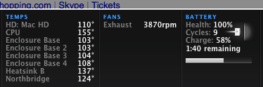

I'll post a follow up photo to the one include here. The phone represented here indicated the temps. with SmcFanControl on..i'll report another photo of when SmcControl is off and i'm doing the same thing, i.e. watching something on hulu, have itunes open and surfing the web, also OmniFocus is always open so that too.
Edit: Another question. SmcFanControl; battery drainer?

Looks like you have the 15" model. I'd expect some differences, mostly because there's only a single fan. Anyway, it'll be interesting to see what your test shows. I'm guessing the 15" fan will have a higher normal speed than the 17" (interestingly enough, the 17's right fan is the same part as the 15's).
edit: To answer your edit - yes, increased fan speed will decrease battery life.

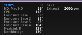

It doesn't feel hot on the bottom of the mbp. Its slightly warm but in no way hot or a discomfort.

Looks like your temps are similar to mine and the case feels about the same, too. It's interesting the fan does indeed idle at 2000 RPM. I take it you're saying the case doesn't feel all that different from when you were running SmcFanControl at >5000 RPM? If so, I guess it's a question of whether that difference balances with a bit more noise.
Just for fun, I ran iTunes Visualizer "G-Force", which is CPU intensive, first with the 9400, then 9600. They had same overall heatsink temps. The fans both started ramping up once the case bottomside sensor 4 hit 95F, with CPU diode at 176F. I didn't run it until the fan speeds stabilized, but in a past test they did at about 4400 RPM. They will go higher when I'm stressing the 9600 and CPU (X-Plane, for instance).
