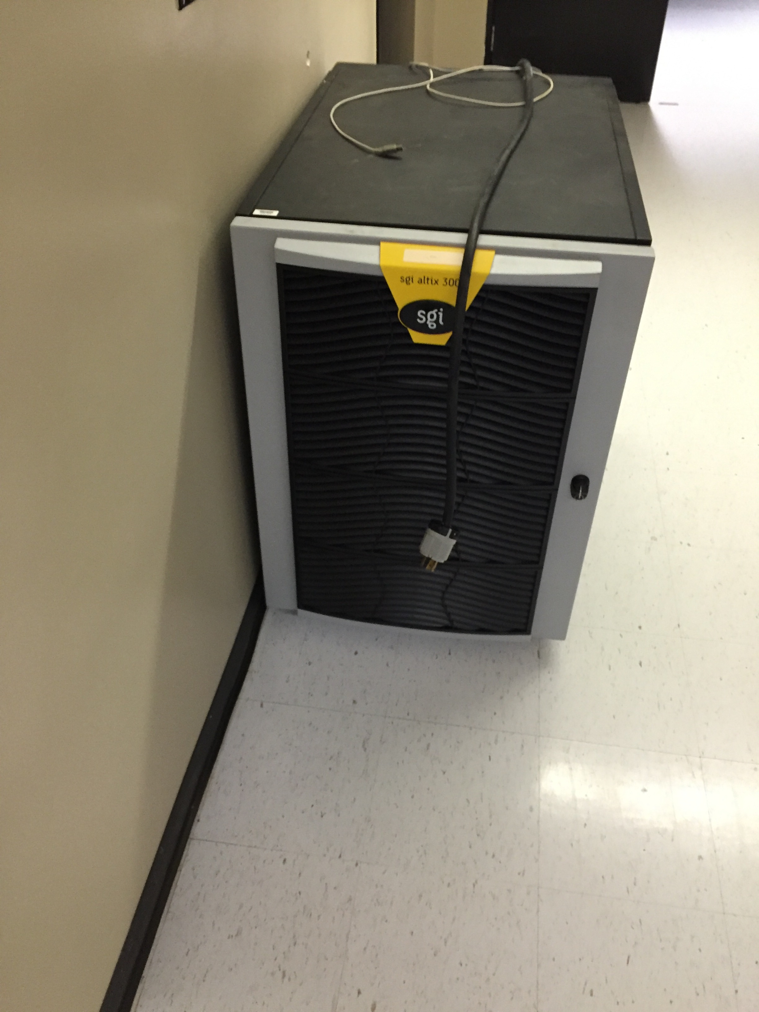

BTW, if SL is an "Intel" operating system, does anyone want to help me install it on the 12-processors SGI Altix 3000 minicluster that's currently sitting outside my office door? It's Intel after all...

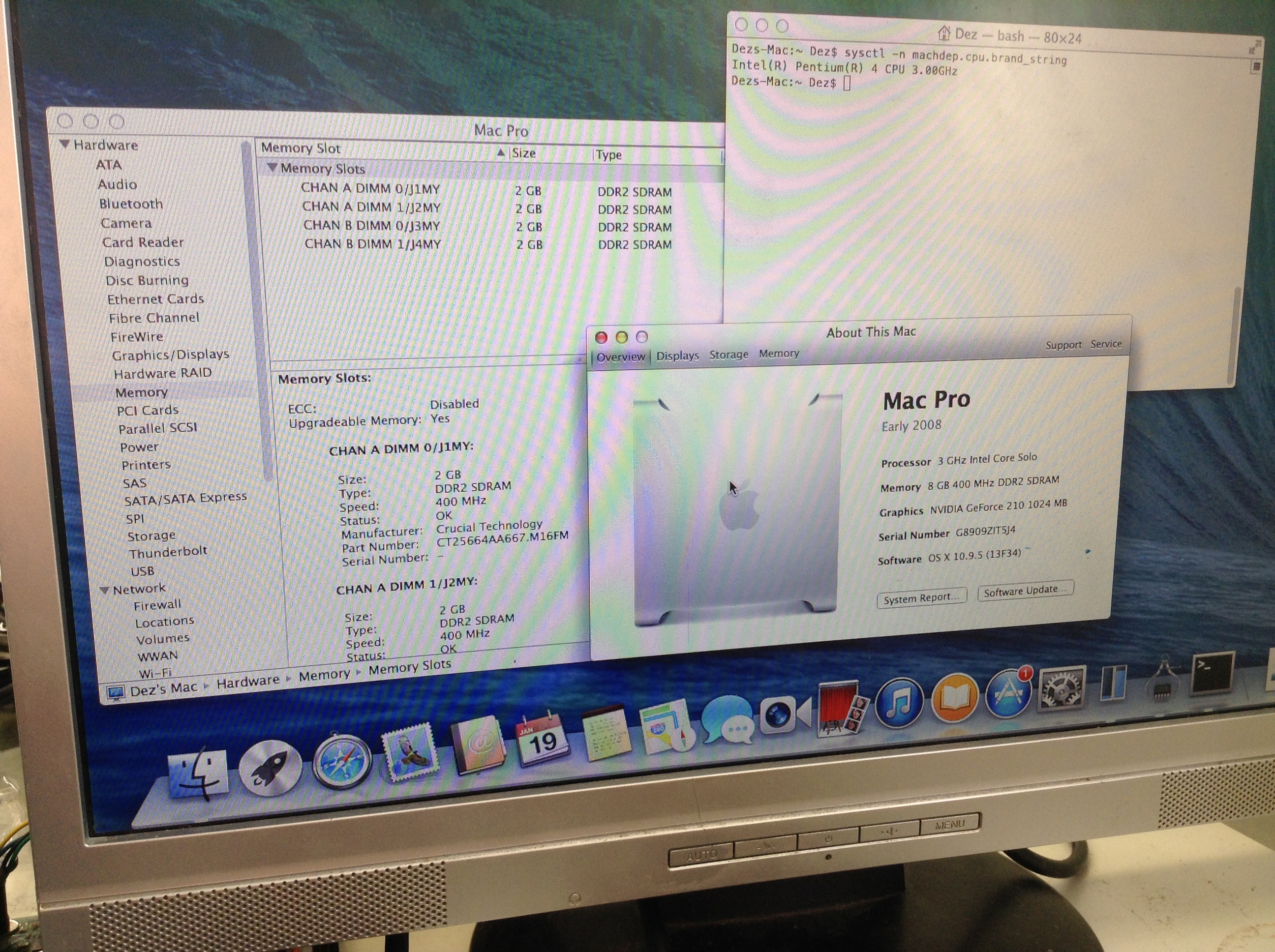

SL is a x86 OS yes but with System requirements 🙂 officially on a vanilla kernel SL will boot on a minimum of a Yonah CPU with a Patched kernel you can get it to boot on a SSE2 CPU as long as the kernel has a SSE3 emulator written into it... with that Done I have been able to do this... Snow Leo on an AppleTV anyone? 🙂
I also have a 64Bit Pentium 4 From 2004 (one of the first x86_64bit CPUs from intel) so what else to do then Load it up with 8GB of ram and slap Mavericks on it 🙂 (Wish you could do this with your 2004 64bit G5 heh)

I'd love to do it, but no publicly released version of OS X will run on it. It wouldn't surprise me if the proverbial black hole in Cupertino has a couple of versions compiled for IA-64, as I would almost be willing to bet that it would have been under consideration in the days before the Intel(or should I say x86) transition. At least in the early days, IA-64 looked promising and Apple would have had fewer hindrances to using it than established x86 makers. Ultimately, I think x86 was the right decision, but I would have still loved to have seen Itanium Macs 🙂
As it is, I think it's running an older version of Red Hat, although I haven't had the motivation yet to haul it into my office to plug it in and check(unfortunately my office is the closest place to its current location with the required electric service). Even Linux distros for IA-64 are getting pretty thin these days.
