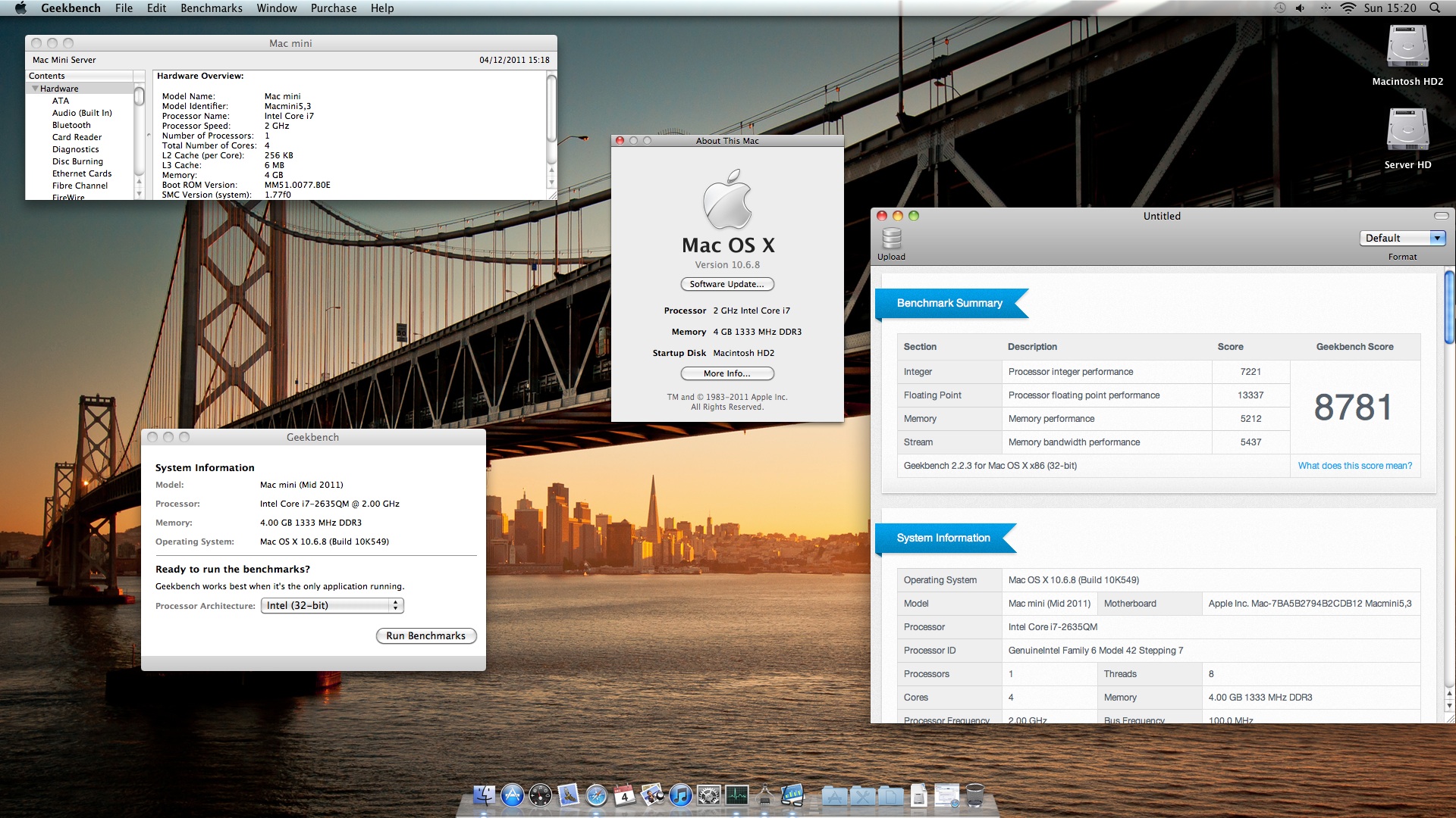

Are people still trying to do this? I managed to fix the performance problems with the 2011 mini under 10.6.8:
