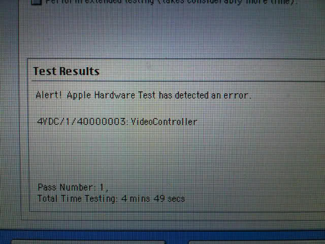

Edit: here is the pic and error
anybody? i have the following error.
toldjya ;). I also had this same error after the lane width decreased.
Bring it in to the Apple Store or call up AppleCare and arrange a pickup. Mention the error and decreased GFX performance. They should replace the motherboard.
+1. When you call/take it to the store, make sure to mention http://support.apple.com/kb/ts2377

Would it help me to mention the error someone posted the pic of (Alert! Apple Hardware Test has detected an error. 4VDC/1/40000003: VideoController)
