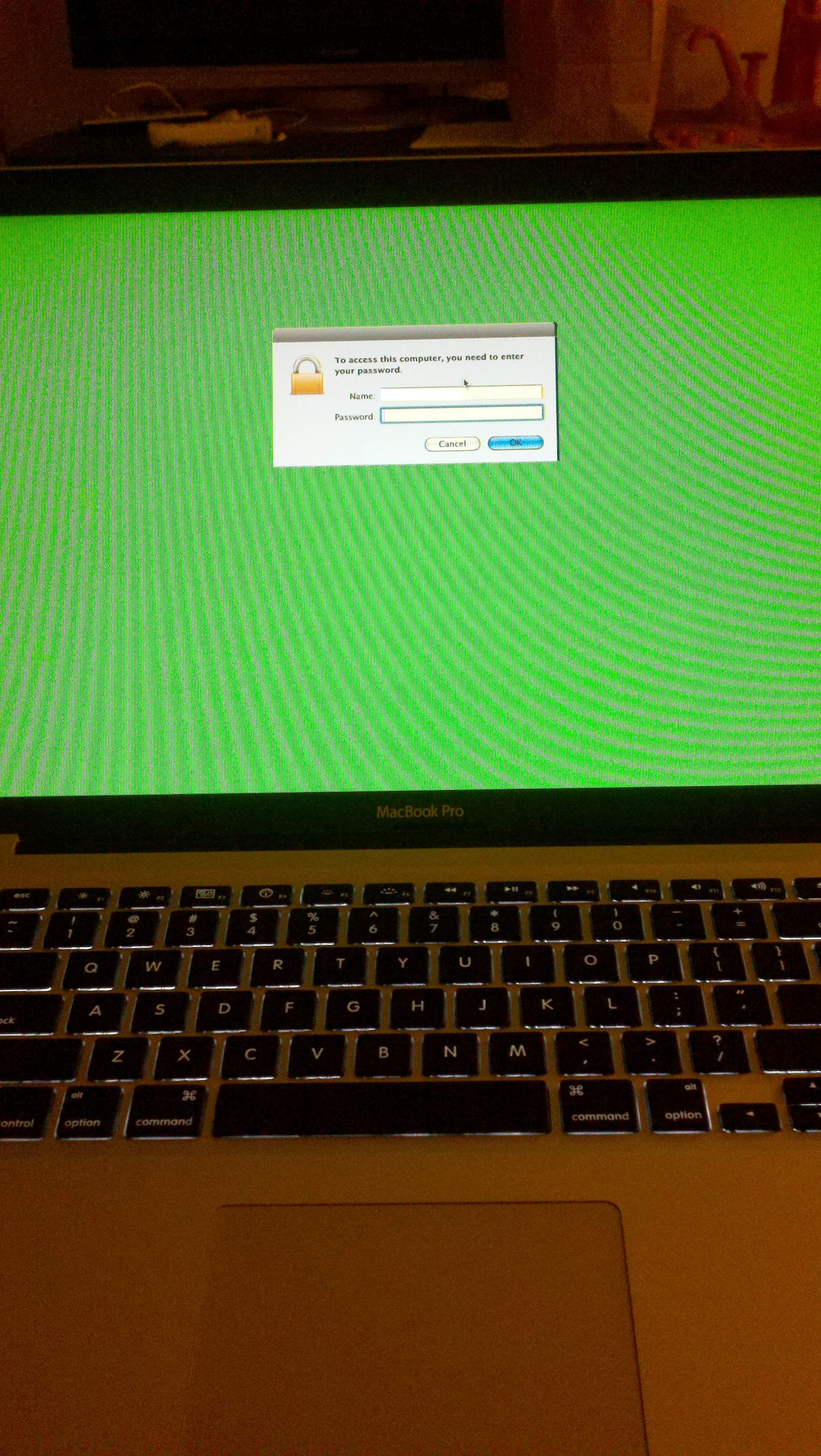

MBP 15" 2GHZ INtel Core i7. Maybe it's my cable from the screen at the hinge, sometimes mine is all green where it should be black. ( or sometimes the white login box is green) moving the lid will fix it , it comes back randomly. Just happened now, I took a photo and video clip to show the Apple genius' Still under warranty so I hope they get in there and fix this "intermittent" issue!
