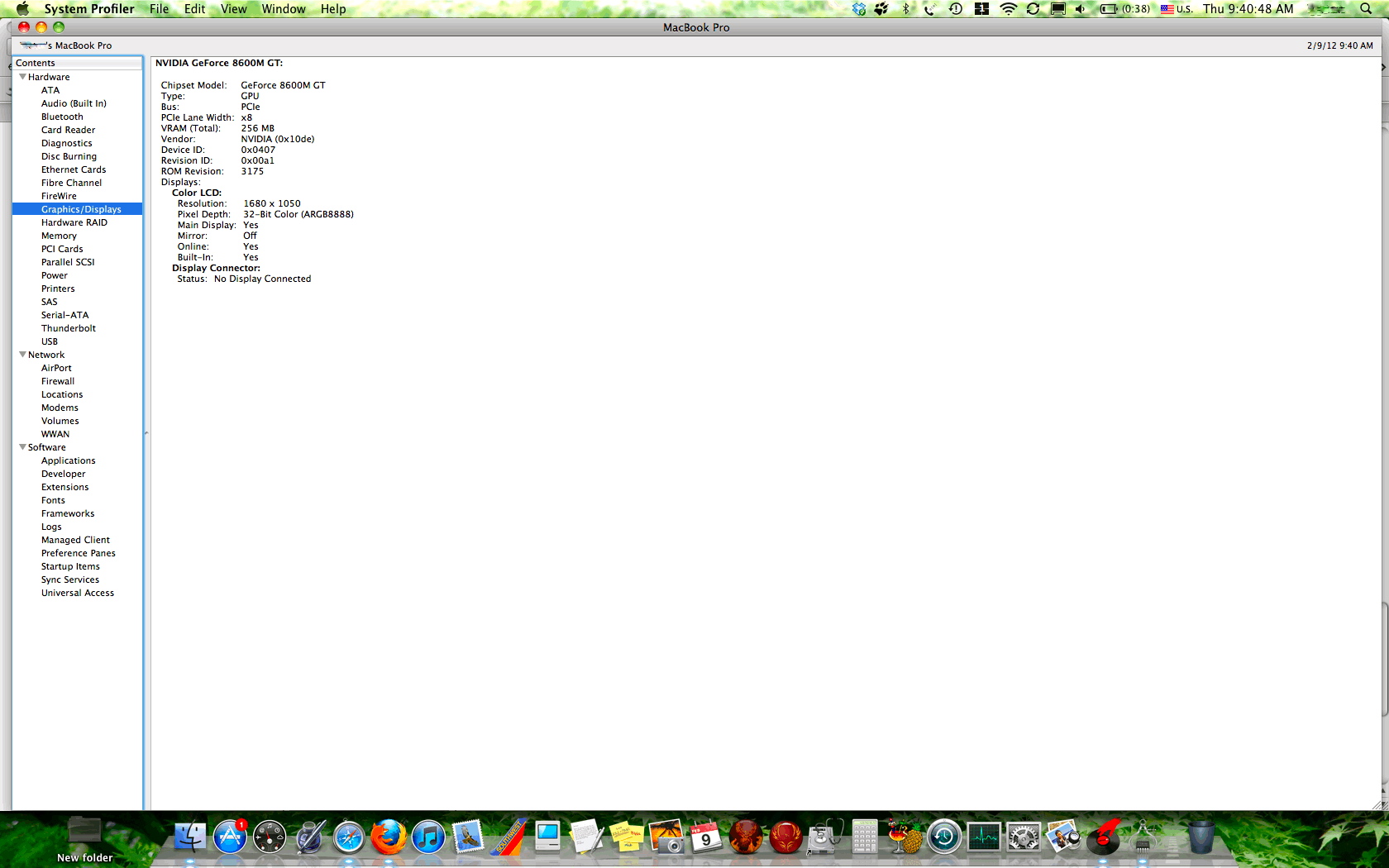

So...I went into look at the System Profiler...and saw this. Is it the beginning of the end for mine? Original card, over 4 years of nearly problem-free service, says it was built in the beginning of January 2008.
Sorry, I missed this.
Yes, the PCIe lane width reduction is one of the first signs of failure. That lane width will eventually go down to 0, at which point your screen will blank. When mine did that, I was able to remote in and take screenshots of the gfx card not showing up, period.
Even if you take it in to an Apple store now, it will fail the Nvidia test.
Provided you are within the 4 year date-of-purchase window, you'll get a MLB replacement.
In my opinion/experience, these chips are pretty much ALL bad.
Like I've mentioned in previous posts, my first chip failed in about 3 years. Second one in about 2.5 months, next one under 1.5 months. I figure I can pretty much induce failure in any 8600M GT. Just a bunch of high heat/cooling cycles from high graphics loads through games and whatnot under Bootcamp/Windows/Parallels.
The PCIe link is only 8x, not the full 16x it used to be.
Hmm, I didn't know about this. So, if my system profiler reports the PCIe lane width as being x1, does that mean that my card is on the verge of failure? For what it's worth, I haven't experienced any issues while encoding videos, doing normal system operations, or playing games.

Took it to the store, they ran the test...and then it showed up as fine. Go figure. Not to mention it's outside the four years. :/

Reboots and shut downs weren't altering the system report that I was running with a PCIe lane width of x1. I did a SMC reset (unplug power supply, remove battery, hold down power button for 5 seconds - although I held it for 10 just to be sure), and it seems that the lane width is now being reported as x8. I can't say that I noticed any change in system performance in going from x1 to x8 (not that I had any issues to begin with, nor am I doing graphics-heavy things like gaming)... either way, it's a bit of a relief to think that I still have some more time. It also saved me a trip to the Apple store - this is probably one of the first things they would have tried, and then I would have felt like an idiot for not having done it myself.

Edit on 2/14: well, crumbs - I checked just now and my PCIe lane width is being reported as x1 again. Between my initial post and this edit I had the computer sleep twice and did one reboot. I guess I'll be making an appointment with the Apple store after all...
