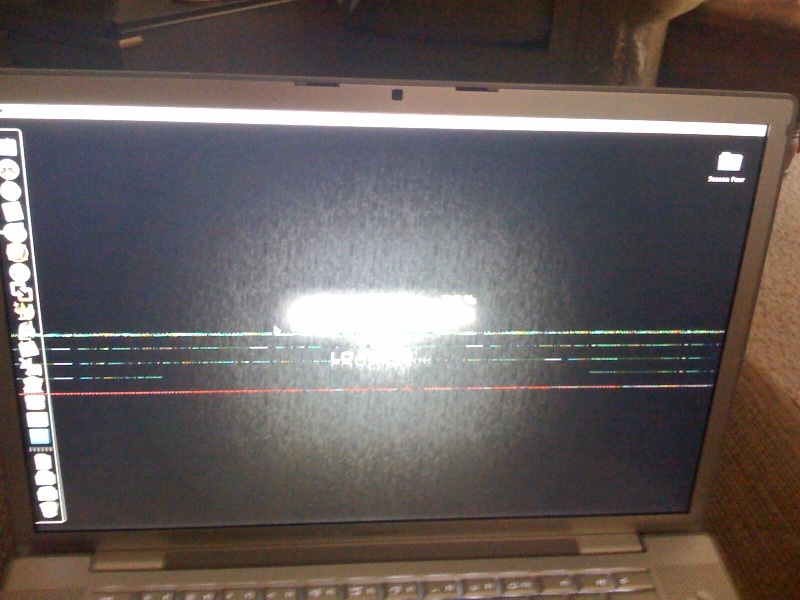

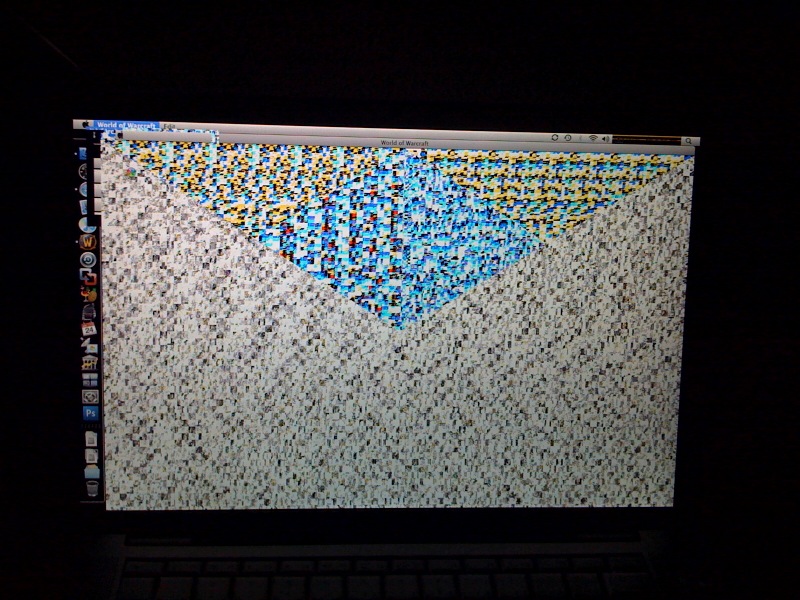

I have had mine replaced twice and now I am getting this after three months of having it replaced.
:eek:
you had the same config as me....
don t say you are glad...
