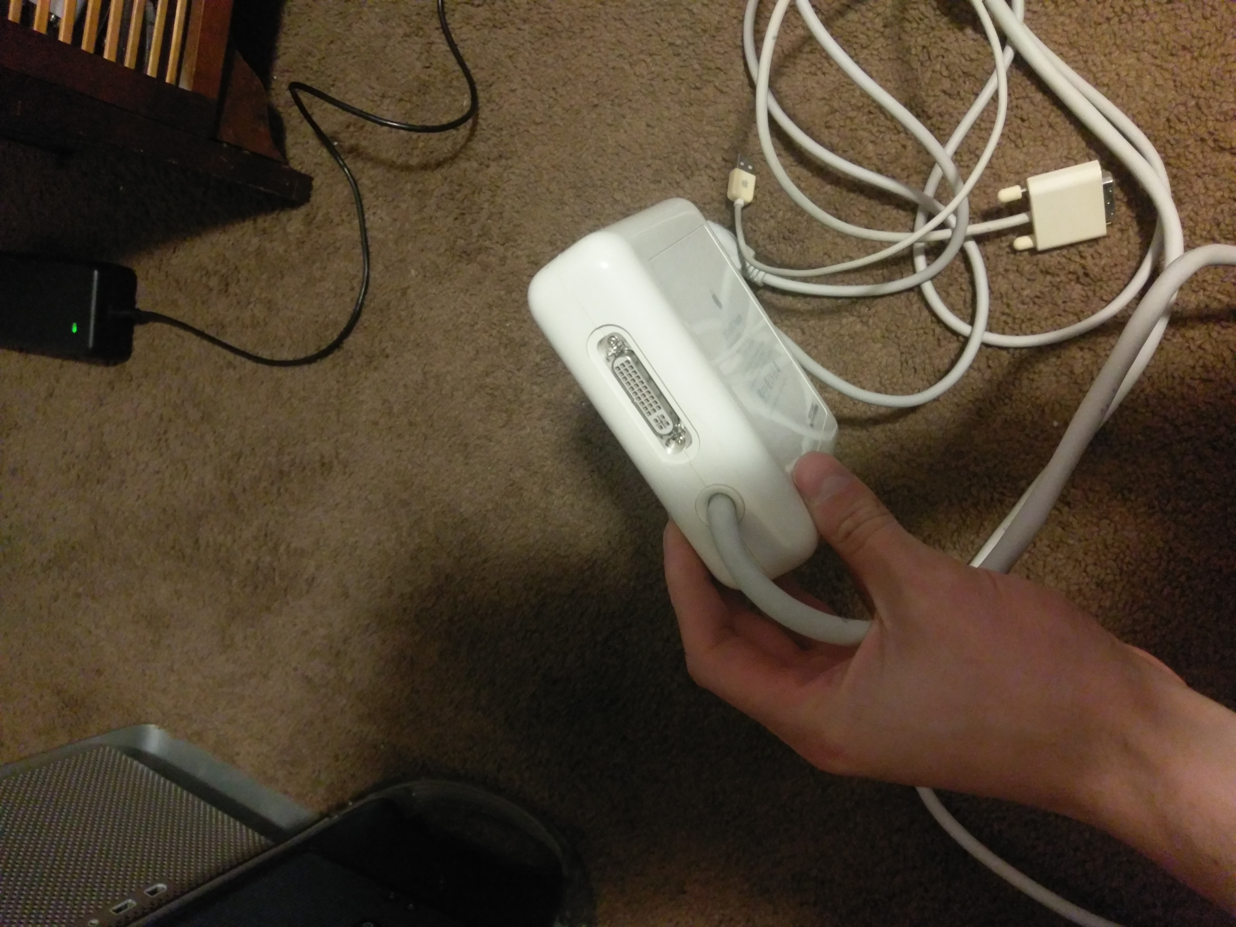

What you want is this:

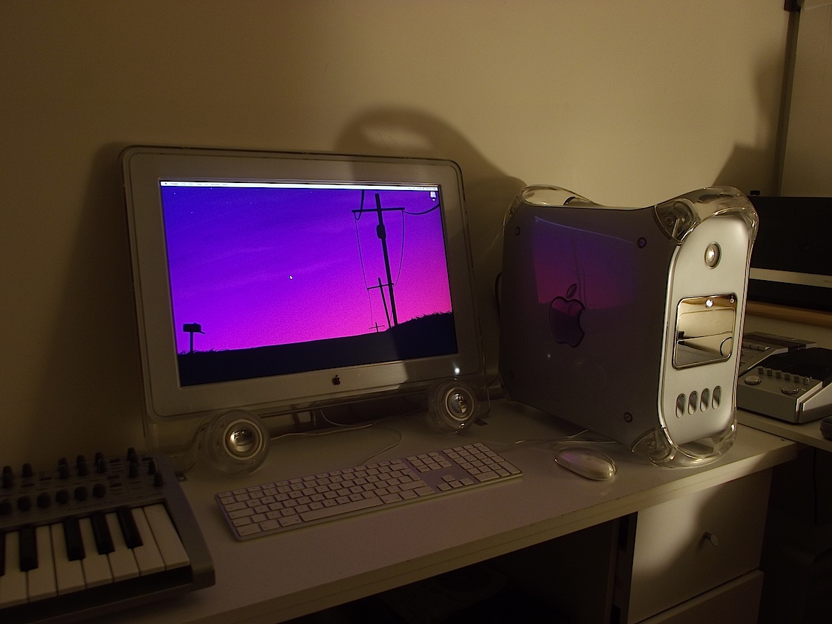

I'm typing this from a Mac Pro that has the same 23" display that you have. It will work on anything with a DVI port after you get the adapter.

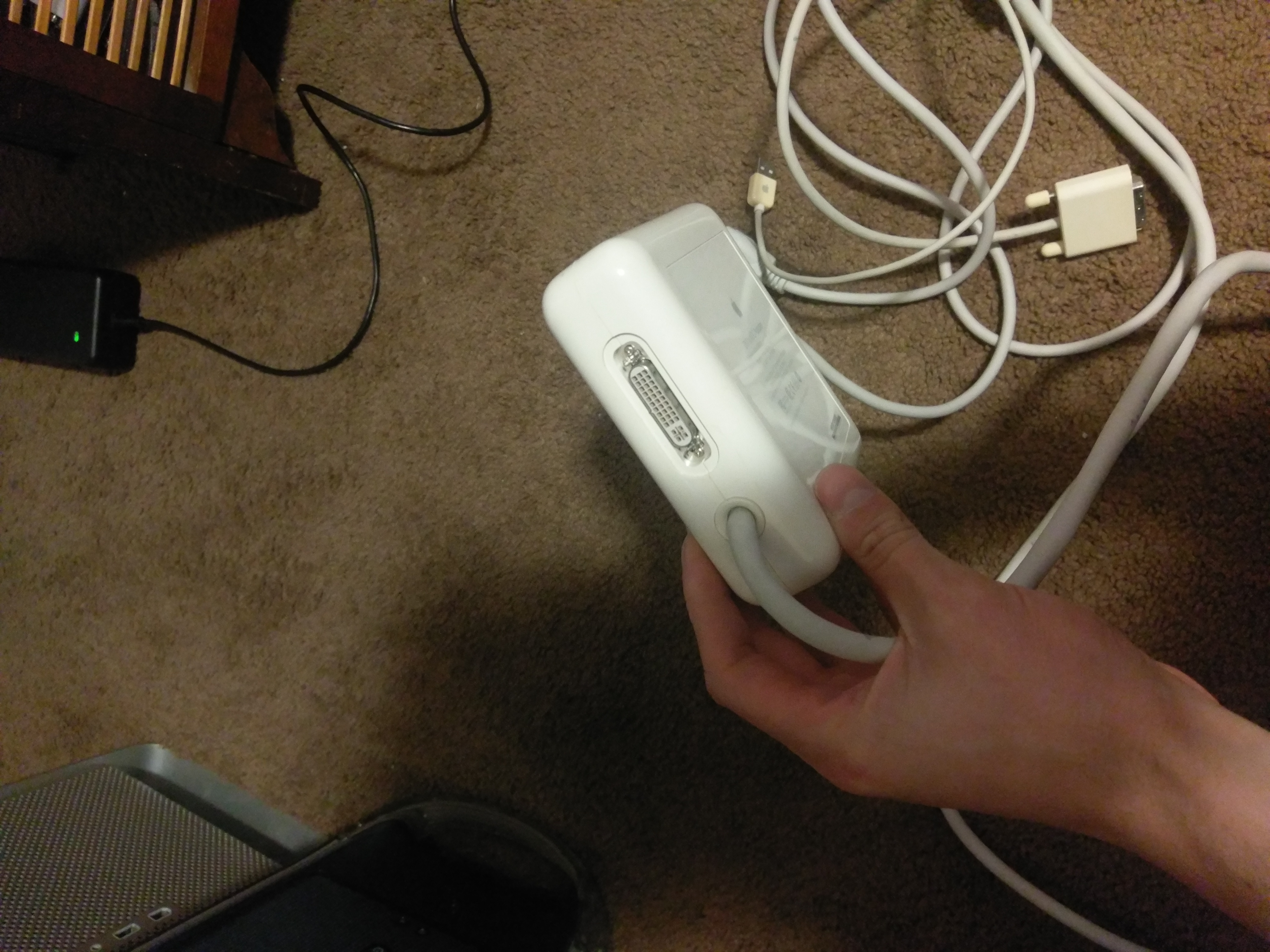

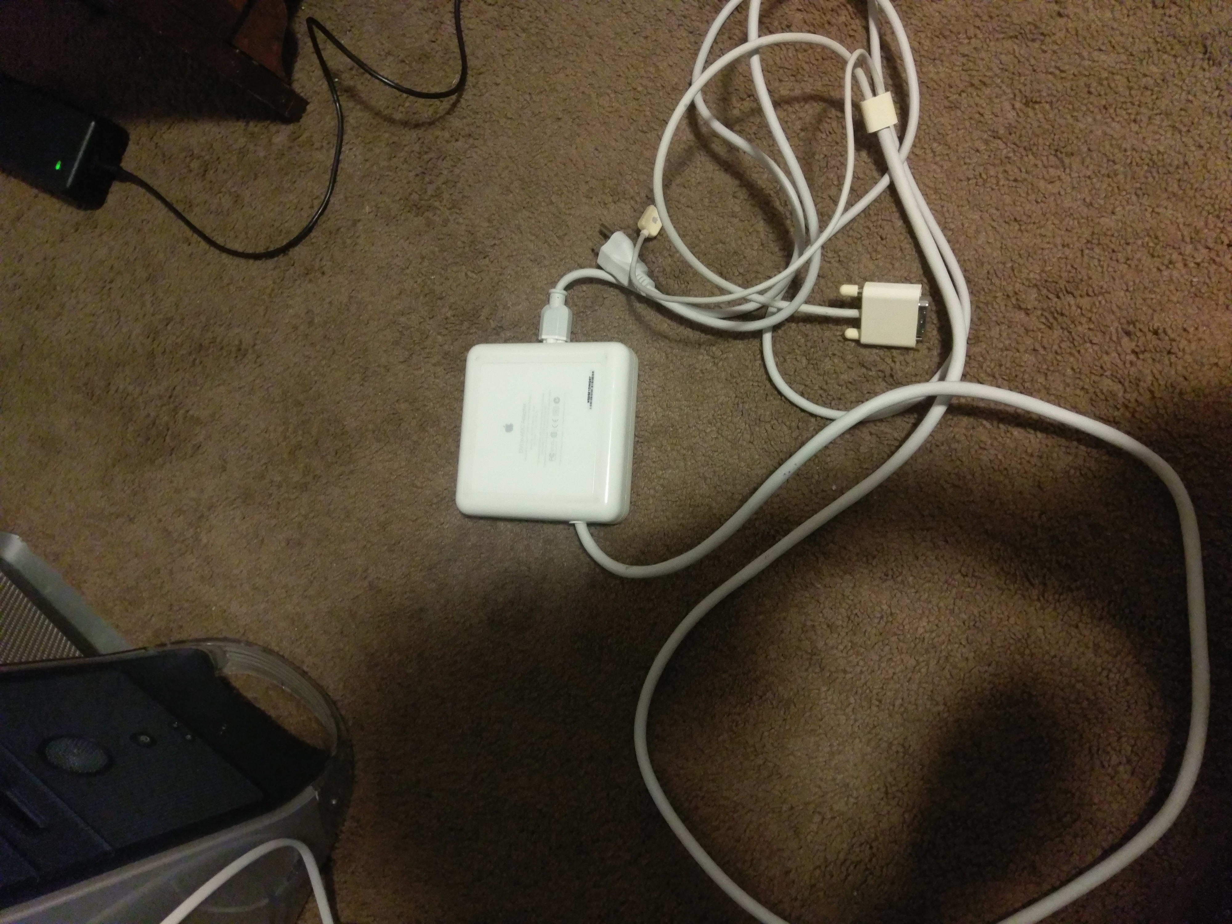

I've never seen those 3rd party ones. But apple ones are available (like in my photo above). I have two, one of which was by luck. I got one on eBay for 30 bucks. The other showed up with another cinema display at an e-waste center I like to shop at.
Ditto for me. One from an eBay seller along with other attachments and the other being thrown out by a recycling centre with a 22" ACD. The centre thought it was just a power pack.
