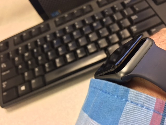

The exact same thing happened to mine yesterday. The screen came off for no reason. First, the Force Touch stopped working as I unsuccessfully tried to delete my notifications. It finally worked when I pressed harder. Later I saw that gap between the glass and the chassis. Luckily, it's still covered under Apple Care, which expires at the end of this month. That was very close! It's Series 1 and I've had it for almost 2 years. One of the early adopters. I made an appointment at the store and, to my surprise, they don't handle it the way they would do it with iPhone swaps. Now I'm gonna have to wait for at least a week to get a replacement. So un-Apple, I should say!

As an easy adaptor you should know you have a Series 0 and NOT a Series 1.😱 Also if it is a swollen battery (most likely culprit) then it is covered even without Apple Care since Apple has acknowledged the problem and agreed to offer replacements.

Nope, the battery is fine. It looked intact under that screen LOL
Apparently, they don't do any repairs/evaluations at the store in regards to the Apple Watch. They have to ship them to their repair centers even for a simple evaluation. This is the very first glimpse of the new Apple. I think it's going to be even worse and might affect a wider array of products down the road. It's all about cost savings for them now. We can thank Angela and Tim, and the rest of the executive team with their millions haha.
