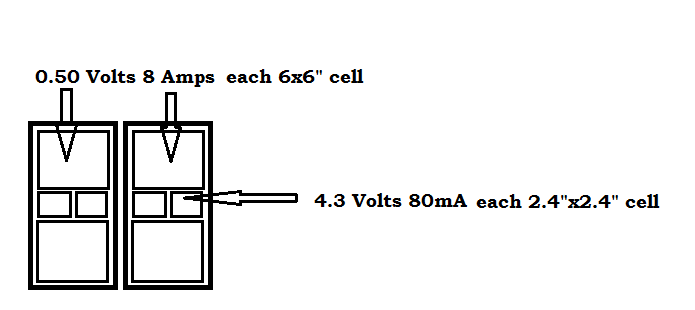

I don't know how much luck you will have using different sized solar cells. I'd stick with identical ones. Also, what kind of regulator are you going for? I think you need to find cells that put out 7-9v open circuit for a regulator to reliably provide 5v. I'm having a bit of trouble locating a switching 5V regulator that can handle the 3-4A I'd like to have. I'd like to be able to charge an iPad at the fastest rate and several iPod Touches at the same time.
Using different cells makes no difference to the electricity I do believe (or thought that's how electricity worked).
Also for the regulator you might be looking for, try the LM350T: http://www.fairchildsemi.com/pf/LM/LM350.html

Better double check that data sheet. The LM350 is a linear regulator with a 3v dropout voltage. (If I'm reading the data sheet correctly, I'm no expert.)
That means you will need solar cells with at least 8v output. At 3A you will be burning up 9 Watts in the regulator. Over 1/3 of your power will be wasted heating up the regulator. And that is best case.
I think a switching regulator will be a much better choice.
I'm wondering about the LM1084. A switching regulator with a 1.5v dropout voltage and can supply up to 4A.
I see in your solar panel diagram 4 cells at 0.5v and 8A and 2 cells at 4.3v .08A. I'm confused about how you are going to wire those to produce the 6.5-8v you will need to drive the regulator.
If you put the 4 larger cells in series you will get 2v at 8A. If you put that in parallel with the smaller cells the output will drop to 2v as soon as you exceed 0.16A. If you put them all in series you will get 10.6v but only 0.08A. I can't see any good way to combine the dissimilar cells. I don't think the electricity adds up the way you expect.
