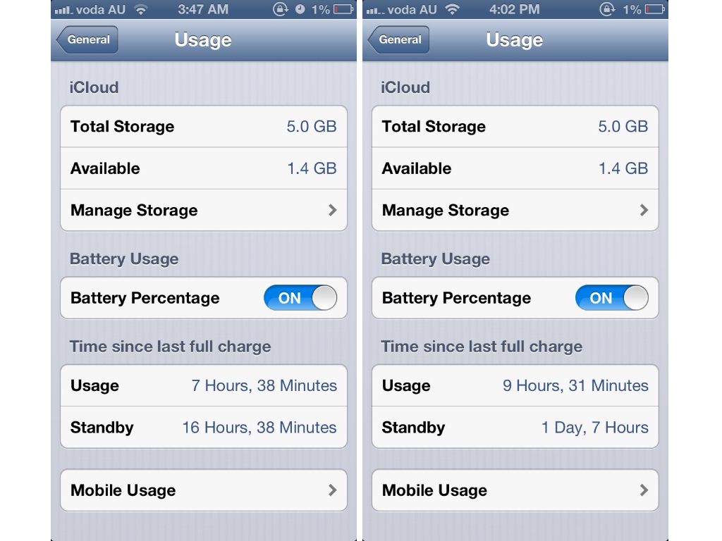

For my result,
- I spent about 3/4 of the day on wifi.
- Had 2 seven minute calls and quite abit of 2D gaming like lemonade tycoon.
- A lot of flipboard and Facebook.
- Constant checking of usage times in settings.
- 5 to 10 mins of apple maps navigation.
*I think I could have hit ten hours if I didn't use my gps for navigation during the day.
Alright guys, thats it. I hope this works for you. If you have more questions, just message me.
Below is my Before and After screenshots

Worked like a charm
Just wanted to than you and let you know I reached 5+ hours use and 20+ standby. Before I was getting 3 and 8. Much improved.
