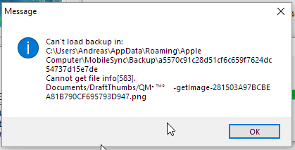

Hello,
I am also facing an issue where the data connection to my carrier gets blocked and Apple is blaming the carrier and the carrier blames Apple. And both say the only solution is to set up the phone from scratch and not load my data backup. As this would mean a horrendous amount of work and loosing data I still try to avoid this and therefore was super happy when I found this thread here yesterday that for the first time seems to point me into the right direction.
So I took a new unencrypted backup and wanted to start but unfortunately the backup doesn't load into the tool with the following error message:
"Can't load backup in: ...
Cannot get file info[583]"
Any idea how to fix that?

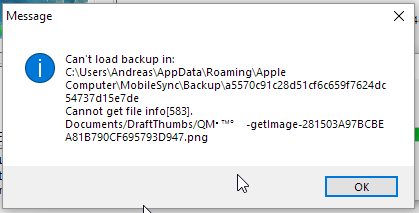

Hello,
Andreas
DOUBLE SOLVED!
First I used a different software to edit my backup. It's not free though but worked very nicely: iMazing (https://imazing.com)
And second after deleting the com.apple.managedCarrier.plist file and restoring the backup my mobile data finally works again.
Andreas
DOUBLE SOLVED!And second after deleting the com.apple.managedCarrier.plist file and restoring the backup my mobile data finally works again.
Andreas
I don't know why iBackupBot didn't work for you. I've had it crash on me, but not seen your issue.
One trick that might have worked is to set iTunes not to encrypt (as you apparently did) and then have iBackupBot itself make a backup. Edit that one and restore from that edit.
In any case, I am glad you found an alternative software that works. And thanks again to Caliwolv, the OP of this thread. He was the first I saw to figure out that the problem was in the com.apple.managedCarrier.plist file.
