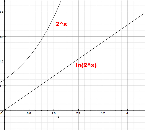

I have attached below a graph comparing 2^x and Ln(2^x). You'll see the Ln(2^x) has become linear. As you can see with both the graph and the physics equation, once you apply Ln, the exponential is removed.

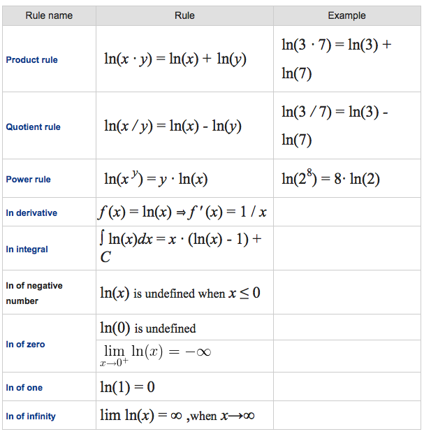

Also attached some important rules of dealing with Natural Logs.
