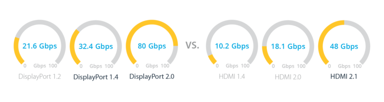

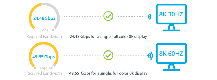

I found this article informative.
Display port 2.0 will have around 80gbps throughput and can support crazy stuff but still not coming out till later this year. HDMI 2.1 does 48gbps and supports 8k fully.
But, you only need around 25gbps to do 8k at 30fps and frankly that would be fine. So a lot of display port 1.4 ports in can support 8k at 30fps, and of course HDMI 2.1 does 8k as well.
Reactions: ph001bi

They mixed up data bandwidth and wire bandwidth but the conclusion remains unchanged.
24.48 Gbps and 49.65 Gbps may be valid data bandwidth (but it doesn't look like they used CVT-RB or CVT-RB2 or HDMI timings to calculate those).
DisplayPort 1.2 is actually 17.28 Gbps because 8b/10b (it takes 10 bits on the wire to encode 8 bits of data).
DisplayPort 1.4 is actually 25.92 Gbps because ditto.
DisplayPort 2.0 is actually 77.37 Gbps because 128b/132b and FEC.
HDMI 2.1 is actually 42.67 Gbps because 16b/18b.
They mentioned DSC which can effectively double the bandwidth (I think 3:1 is possible but Apple does 2:1 if they enable DSC at all - Big Sur doesn't enable DSC in some (most?) situations). Another way to double the bandwidth is to use 4:2:0 chroma sub sampling (chroma sub sampling reduces color resolution but luminance is still max resolution). DisplayPort 1.2 can't do 4:2:0 but it can do 4:2:2 which allows for 150% bandwidth.
