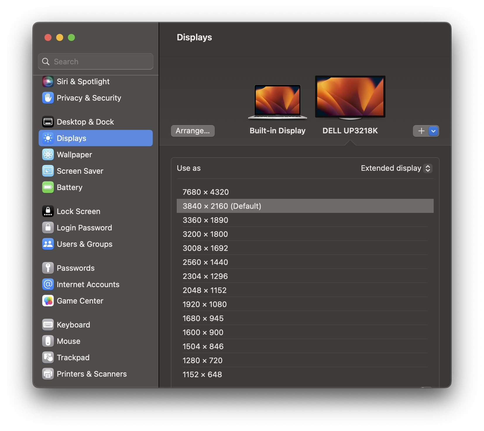

Hi all!
Writing here because it seems like this is the most complete info on getting the Dell UP3218K working in macOS at 8k60. Has anyone tried using this monitor with an M3 based machine (and not an M3 Pro or Max)? Specifically, the base MacBook Pro or MacBook Air? These machines now support two displays with the lid closed (one at 6k60 and one at 5k60). I assume the lower resolution limit for the second screen has two do with only being able to do one monitor with display stream compression.
However, 6k60 and 5k60 at the same time suggest that there is bandwidth to drive the Dell UP3218K from both ports on the M3 silicon with the lid closed since this monitor does not use display stream compression.
If anyone has an M3 base Mac and the UP3218K running the latest macOS I would love to know the answer!
@joevt , any insight into which models would trigger the check to allow use of the UP3218K at 8k60?
Reactions: SymeonArgyrus

I don't know which models support which modes. Some Apple Silicon Macs support the UP3218K

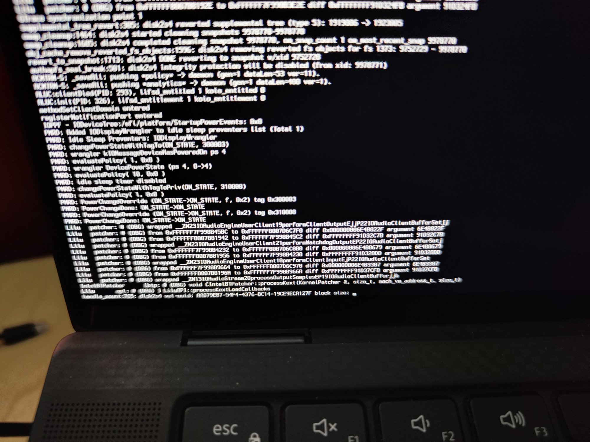

I just found that those logs are from preboot/picker. I will try to capture logs from the boot process.
The crash was coming from Lilu.
I was able to boot normally after replacing just Lilu with the normal version.

GOT IT!!!
this is where it stopped and rebooted. see attachment.
I found the Kernel panic log, see attachment.

Since you are using Hackintosh, you probably have more Lilu kexts than a real Mac.
All Lilu based kexts need to be recompiled with the same Lilu.

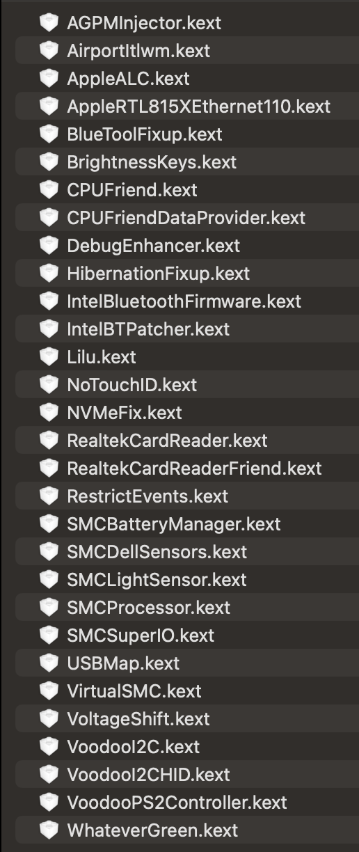

OH BOY... That's lots of kexts to rebuild and find out which is Lilu based. =|
These are the ones I am using now.
Reactions: dabotsonline
Run a command to find the lilu-based kexts. Change "/Volumes/OPENCORE" to the mount point of the Open Core EFI volume.
Code:
cd /Volumes/OPENCORE/EFI/OC/Kexts
grep -l -R --include Info.plist --exclude "*/Lilu.kext*" Lilu . | perl -pE 's|./([^/]+).*|$1|'
Then compare that list with the list of enabled kexts from the Open Core config.plist file.
You only need to rebuild the enabled lilu-based kexts.

RestrictEvents.kext
SMCBatteryManager.kext
SMCDellSensors.kext
SMCLightSensor.kext
SMCProcessor.kext
SMCSuperIO.kext
VirtualSMC.kext
WhateverGreen.kext
