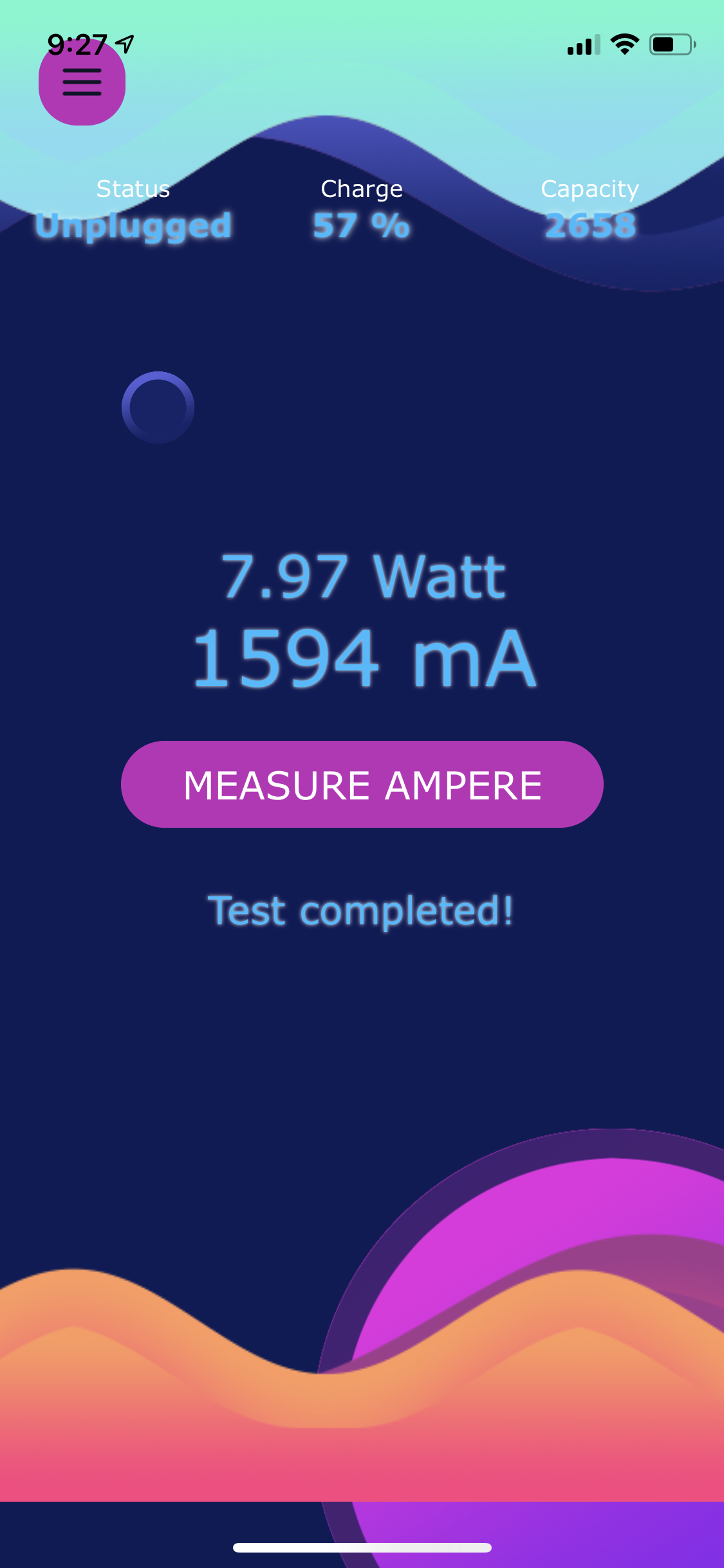

What App are you guys talking about to check the wattage being used? I'd like to try that when I unbox the Samsung charger.
One of those two. Keep in mind, they’re a rough estimate, not exact. Make sure your phone is at around 20-60% or so before running the test I.e. don’t run the test on a full battery.

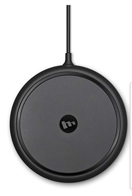

My mophie charger is only sending ~5W according to that Ampere app. I have this mophie wireless charger: Screen Shot 2019-09-26 at 6.31.36 PM.png
