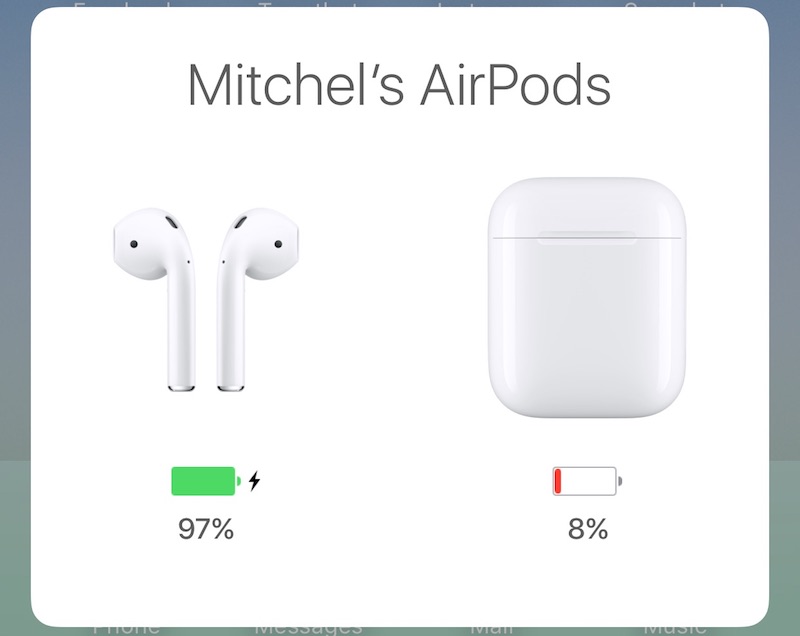

After the AirPods launched online and then arrived to the first set of customers earlier in December, some users have begun realizing that the charging case that comes with the headphones isn't holding Apple's advertised 24 hours of charge. In theory, the charging case should only lose noticeable amounts of charge when the AirPods are low on battery and recharging within the case, and when users flip the pack open to check battery levels or otherwise activate Bluetooth with a connected Apple device.
The unlucky set of users facing the battery issues, however, are noticing that the AirPods case drains by upwards of 40 percent in mere hours, with the AirPods at 100 percent inside and minimal Bluetooth activation.
While some feared this is just the way Apple intended the headphones and companion charging case to work, Redditor severinskulls has posted about his experience with the problem, and the replacement AirPods he got that do not have an apparent faulty charging case. In most cases, the AirPods themselves are not facing any shortened battery life issues.
AirPods Charging Case dropping nearly 50 percent overnight
The old AirPods Charging Case:
I was having the exact same issue you had. Airpods in case, go to bed with full charge and waking up with 15%-20% of the case charge gone. Thats a full charge cycle for the airpods themselves!
I spoke to apple support online. They had no answer how long the charge of the case should last when the airpods are not in use. They made an appointment for me instore as all diagnostics at the moment are being handled instore they said. Cut to this morning, go in for my appointment. The genius was very friendly. I was his first airpods case. Turns out he also has no info on whether this rate of the battery draining is normal. He said that definitely they are designed to lose charge over time as cycling the charge improves the health of the airpod batteries. However as I pointed out, going from a full charge to empty in two days while they are sitting there unused seems way too fast. To be safe, he placed my airpods. So i got a brand new pair.
The new AirPods Charging Case:
Sooooo I just checked. Airpods and case were 100% at 9pm last night. Checked just now at 9am the next morning and they are STILL at 100%, both the pods and the case. I had bluetooth on my phone on all night too. With the other pair in the same situation, I would have lost 14-20% charge by now.
So there we go, case closed (pun?), there is a battery life problem suffered by the airpods. I'm going to write back feedback to apple now. You should get your airpods replaced because they shouldnt lose as much charge as what youre experiencing.

I initially (and perhaps still do) had this problem.... Got my Airpods on Christmas Day and gave the case a bit of a charge (to about 80%). I used them a little bit on Boxing Day and then yesterday noticed that the case was discharging 20-30% every 4 hours, even when Airpods were fully charged.
As the article suggests there are a number of others complaining of similar issues on Reddit and I was about to book a Genius Bar appointment. I thought I'd give it another day and see so last night I made sure everything was charged to 100% before bed. Woke up this morning and the case was still at 100%.
Have used the Airpods for a few hours today and at 3.30pm the case is still at 77%, which I think is alright.
Bottom line.... I'll keep an eye on them over the next couple of days but my experience lends credibility to the theory that there is a problem with the initial charge cycle. Interested to hear other's experiences

first to clarify -- by design the pods always charge while in case, from case. this is intended so you always have a full 4 hours of when removed. so the problem isn't really the case battery discharging, its the pods using power while inactive inside case.
mine does it too. to test i let case go down to 0, then put pods in before bed. 88%. in morning they were down to 53%.
def not normal so will get them replaced.
