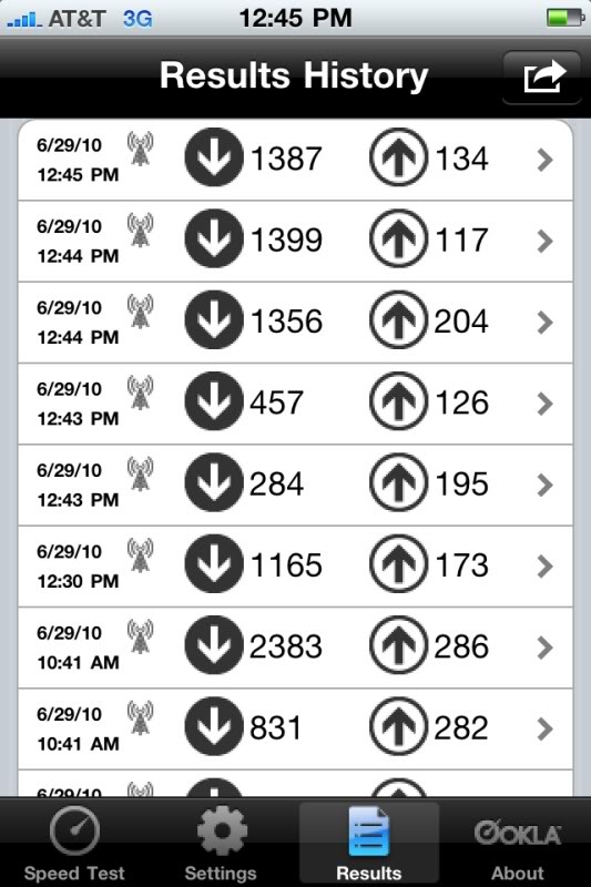

I was super paranoid about the signal/atenna issue, the guy that got the phone right infront of me, you barely touch that area and wam, signal gone.
my phone, came in the att store at the 1030 shipment (had to come back, was 1st person to miss 7am stock) can be held anywhere, anyhow and no signal loss,
so.. its not every phone.
all im saying, not going to argue it or anything, just adding my info to the pool of knowledge.
